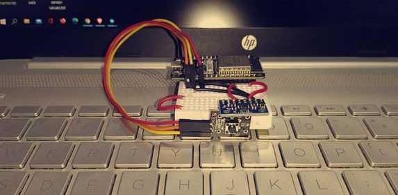

I have used MPU6050 to detect the motion of the circuit whether it was tilted x-axis or y-axis. Once it is detected the data is sent to ESP32 via the I2C protocol. ESP32 sends the keystrokes and mouse strokes to the laptop via BLE. And this whole process happens only when the button is pressed in the circuit. Because without the button the circuit has the power to overtake the actual mouse and keyboard of the laptop.

For hardware we need to connect a push button and MPU6050 sensor with ESP32.
Interfacing pushbutton with ESP32 by microcontrollerslab.com, connect the push button to PIN 2
Interfacing MPU6050 sensor with ESP32 by randomnerdtutorials.com

Once uploading of the code is done, you can connect to the circuit from your PC by going into Bluetooth settings. The circuit appears as ESP32 Keyboard/Mouse. Pair with it.
Noice its done and circuit is ready to be used.
Step 6: Testing the Ciruit
Open Fusion 360 and click on push button to make the circuit work, and move in the direction you want the 3D model to move
Step 7: Observation
The real challenge is testing the circuit as I mentioned earlier the library has the power to control the main mouse and keyboard. So during the testing many times the circuit messed up my laptop by opening the same application multiple times which makes the laptop hang. To come out the circuit needs to be disconnected which stops the Bluetooth and the laptop doesn't come into control until the laptop is kept in sleep mode and turned on. This was overcome by adding a small push button so that we can send the keystrokes only when required.
