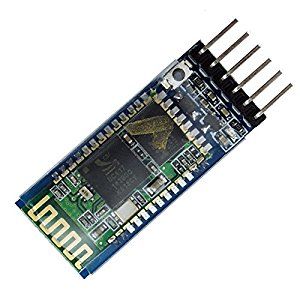

  • Bluetooth module (HC-05)

Now comes the bluetooth module and which will have its Rx,Tx pin connected with Tx,Rx pin of Arduino respectively. Battery or power adapter of 5-6V is required.
So, data sent to the bluetooth module using mobile or any bluetooth enabled devices through bluetooth terminal apps are fetched to the Arduino and in return displayed on the LCD.
