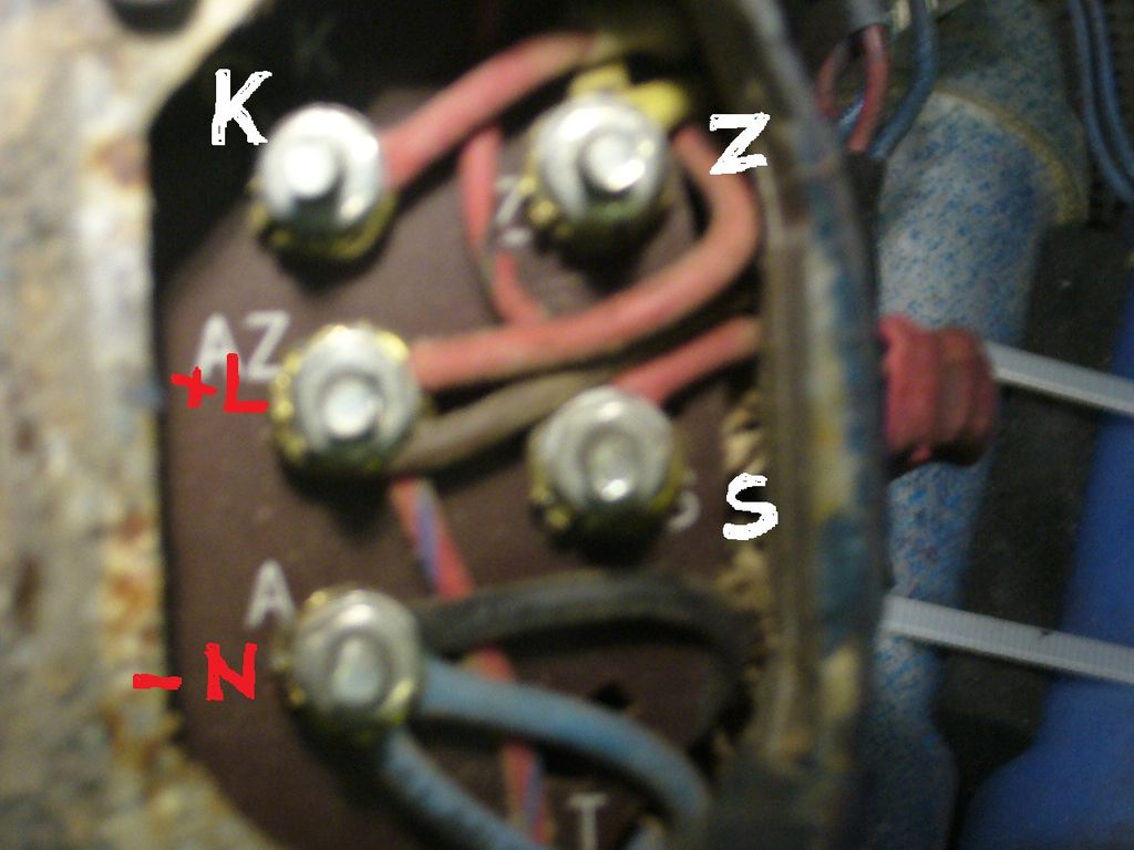

One winding is called the "Running winding" and is connected to terminals marked "A" and "AZ". Myford suggest that "AZ" terminal is connected to the AC live and the "A" terminal is connected to the AC neutral (if they are exchanged, then the motor would simply go in reverse).
The other winding is called the "Starting Winding" and is connected to terminals Marked "Z" and "T". Myford suggest that for forward rotation, "T" is connected to AC Live and "Z" is connected to AC Neutral. The starting winding has a centrifugal switch in series, and electricity only flows to the winding during the start-up; once it is up-to-speed, the switch disconnects the winding from the mains.
The four terminals can be seen in the first photograph. It looks like they are already wired-up, but they are not - the wires you can see are for the motor's internal wiring which goes to the two windings. You can clearly see the labels (except for the "T" label which is partially obscured). On my motor, there are two labels which have no terminals ("K" and "S").
To make the motor run forward, the connections mentioned above ("AZ" and "T" should be connected to AC live and "A" and "Z" should be connected to AC Neutral). In addition, the Earth connection must be connected through to the metal body of the motor using the screw terminal shown bottom right.
The simplest connection for a motor would use a 13A plug with proper 13A 3-core flex and a 13A fuse. Inside the motor, on the terminals shown in the first photo, a wire would link the "AZ" and "T" terminals together which would then connect to the brown, live flex wire; another wire would link the "A" and "Z" terminals together and connect to the blue, neutral flex wire; and the Earth (yellow and green) flex wire would connect to the Earth screw.
