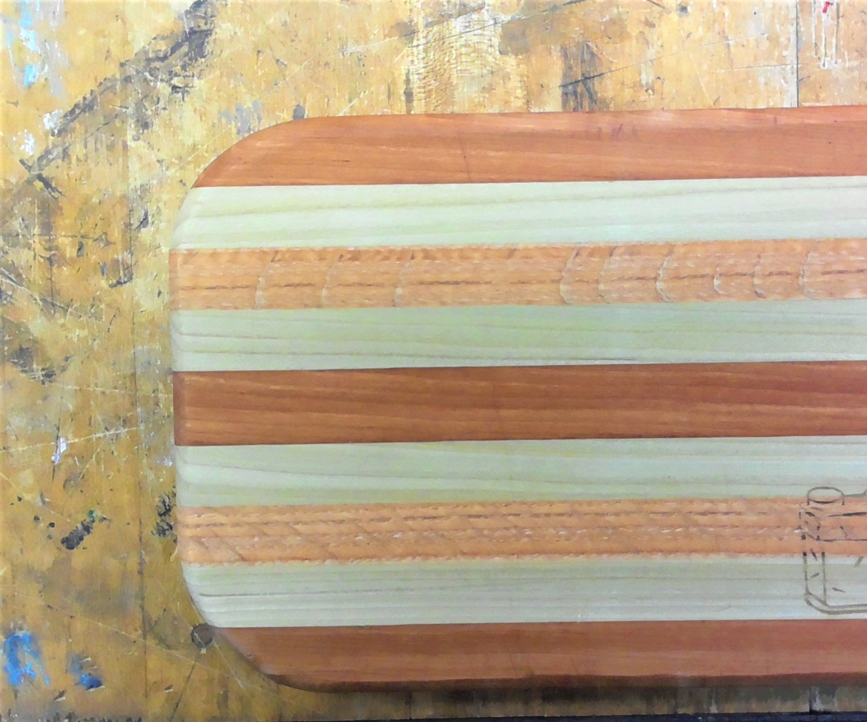

For the First Tray, I had the dimensions of 12 in by 9 in with a height of 2.5 in. The thickness of the wood for both trays was 0.77 in. For the Second Tray, the Dimensions were 18 in by 13 in with a height of 2.5 in. The handles were carved in the sides and were placed in center.

Use Table saw to cut two pieces of Luan. Short Tray: 8 in by 14.25 in. Big Tray: 10.5 in by 17 in.

Step 5: Glue the Sides of the Trays
Using wood glue and clamps, Glue the tray together.
Step 6: Sand the Outer Edges and Re-stain
Using a hand sander, and the corners and sides to smooth them After that, use any stain to re-stain the trays. I re-stained both the inside and the outside again using Golden Pecan stain.
Step 7: Apply Polyurethane
I applied two coats of Polyurethane on the front and sides. After the first coat, use the steel wool to smooth the rough sides. Brush the dust and then apply second coat. Keep it away from dust so the coating comes out smooth. Polyurethane on the back is optional.
