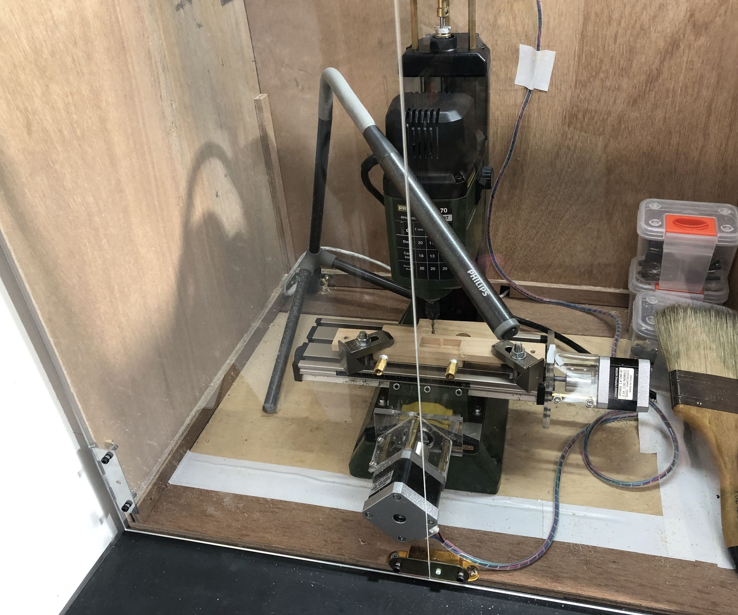

The brown wood cup pic(1, 2) is made by CNC
Cup 3D design (rhino): https://drive.google.com/open?id=17_owHZdLX5qWaqXg...
