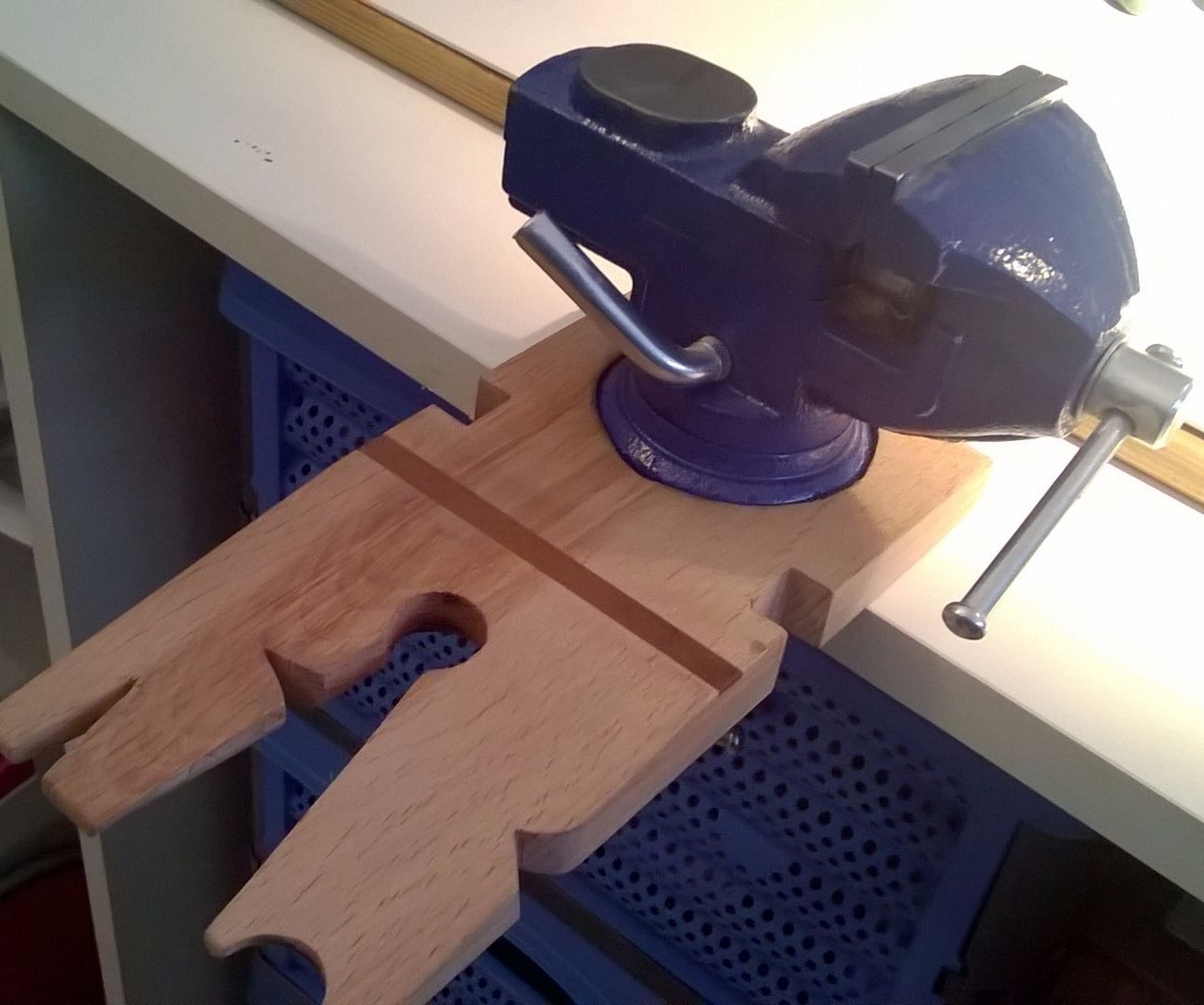

Recently I started to make myself a 2in1 bench pin with vise. It can be secured to the table with clamps. Another method is a 2in1 solution, clamp the bench pin with a vise. So I made a cutout for that and needed to lower a seat for the vise. Here comes the mini router setup. And finaly done, the mini router base works as I expected.
On the video above You can see the next mission with the router base where I made a hanger (ible coming soon about it) for my Foredom flex shaft motor I won here on Instructables by a pair of 3D Layered Veneer Earrings „Venearrings".
