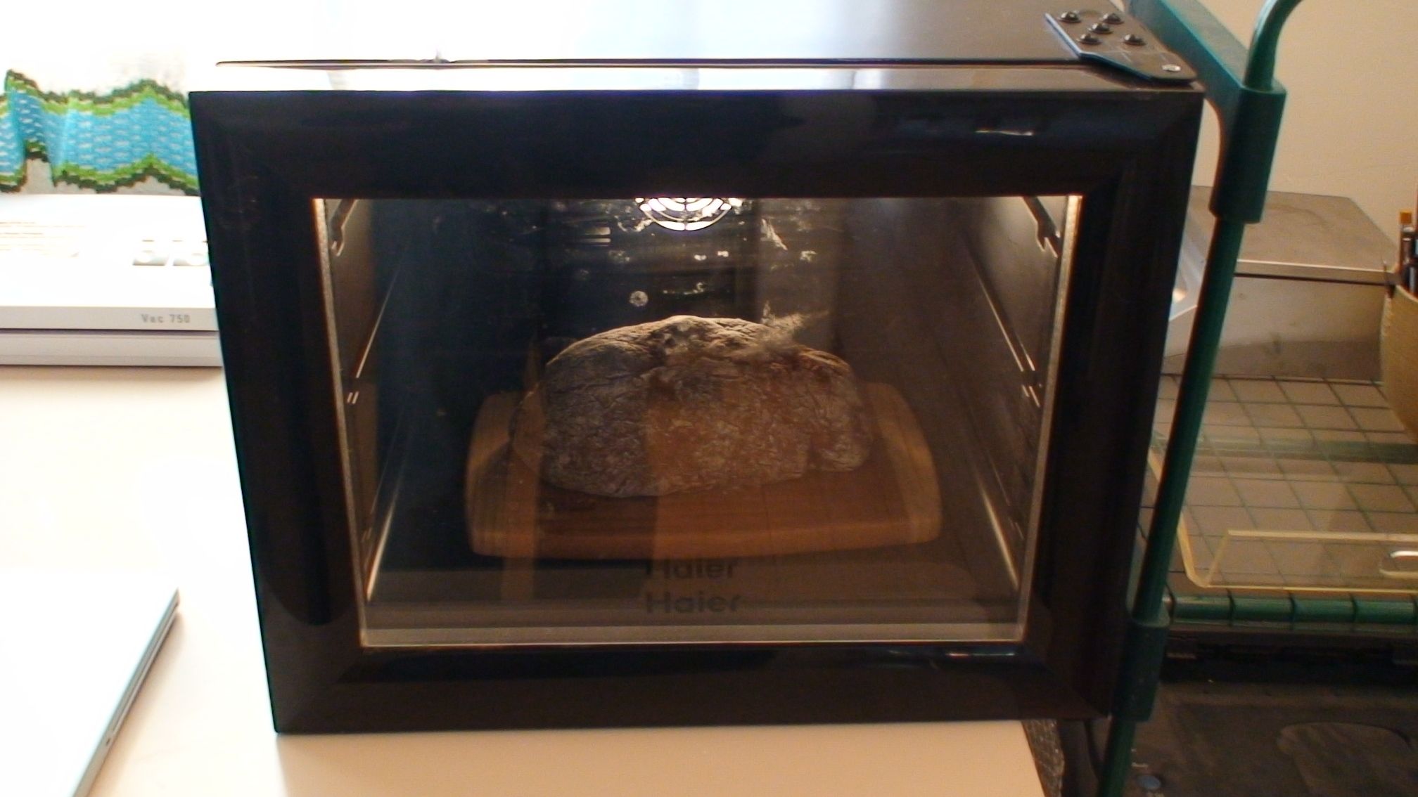

Introduction: YATC5 - Temperature Controller Assembly Instructions
About: I design and sell two different electronic devices. The first devices desulfates old dying batteries. The second assists people with the fermentation of foods. When I am not working on electronics I like to gr…
The YATC5 is designed to make the fermentation of foods as easy as possible. Version 5 has many unique features. It is available for sale in kit or assembled form.
  • Waterproof - 3' long temperature probe
  • Datalogging - drop in bluetooth module or TTL serial
  • 100% Open Hardware
  • Digital Display
  • Celsius or Fahrenheit configuration
  • Memory - save settings through blackouts
  • Wide Temperature Range ( -67F to 257F) ( -55C to 125C )
