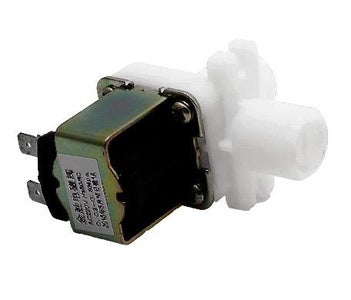

A distributor connects 4 solenoid valves to a tap: it is made with standard ½ inch PVC joints.
Solenoid valves are spare parts for standard household appliances (https://www.aliexpress.com/item/32691601093.html) (3.00 €).
In the joints I used Teflon (PTFE) tape, but this solution does not mechanically block the individual joints well: it is better, for this application, to use a suitable PVC glue.

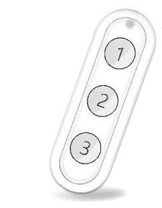

For the remote control, I used a 'ZigBee 3.0 Wireless Portable Remote Control' with 3 push buttons (https://www.aliexpress.com/item/1005003432430621.html, € 14.35, available with 1,2,3,4 buttons) that allows you to send 9 different commands.

  • For each button, there are three programmable conditions: single click, double click, and long press.
  • As task, I set 'toggle status' for the required relay.
  • I added also 'switch all: OFF' to the other timer so that two relays will never be ON at the same time.
