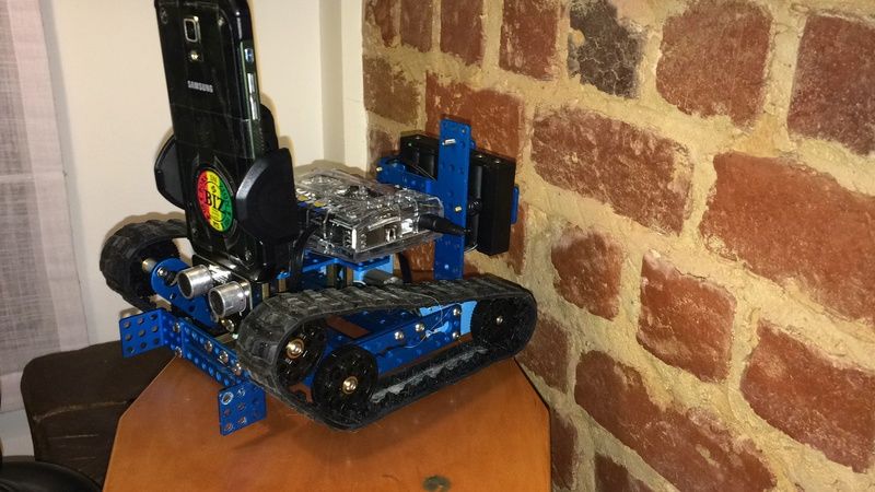

Step 2: Make the Robot Base
  1. First build the standard tracked robot model according to the MakeBlock instructions
  2. Check that you can drive the robot using the included infra-red controller or the Makeblock Remote App (depends which base you choose)
Step 3: Reconfigure the Hardware
  1. Remove the IR/Bluetooth shield
  2. Install your phone on chassis
  3. I add a small part in front of the rover under the ultrasonic sensor to protect it, because the auto stop function doesn't work properly yet
  4. Install your phone on the rover and strap it, here I use some Velcro

Step 7: Time to Play ;)
  1. Click on "Connect" button
Now you can control the rover by move your finger if your are on an other smartphone or mouse if you are connected from a computer into the withe square in the upper left.
To send a text that the Rover going to speech, juste enter your text into the "Commande" box and click "Send Message" button.
You can see the camera view on clicking "Start Cam" and enable flashlight with "Night mode on" button.
