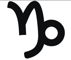

  • Incorporate the zodiac sign images into the mold design, creating 12 different impressions for each zodiac sign.
  • for that i make a .DXF file. Import in fusion360.

Step 5: Design With TINKERCAD(for Beginners)
Step for design in Tinkercad.
  • Make single image of Zodiac signs usiing screenshot from internet image.(attached above)
  • convert them into SVG file.
  • Import SVG file in Tinkercad.
  • Change height as per needed.
  • use flat round plan to make base of Zodiac sign impression.
  • place each impression on different planes.
  • make cavity part with cylinder and set height and radius of cylinder.
  • use 60 mm radius , 2mm wall thickness and 6mm height.
  • make a circular base of 60 mm .
  • Export each file as separately as per needed to 3D print.
