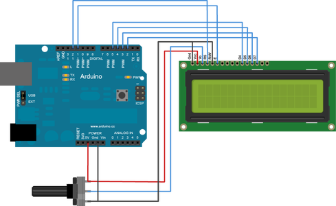

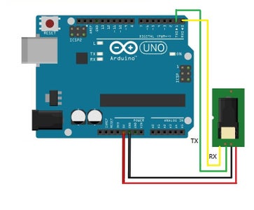

Step 1: Enrolling the Fingerprint and Connecting the FPS Sensor and LCD
please follow the instructions given from adafruit tutorial http://www.adafruit.com/product/751 on how to connect the fingerprint sensor to the arduino during enrollment process. download the software for windows and install in your computer. enrolling the fingerprint using the software makes the process a lot easier.
make sure to add the adafruit library to your arduino library.
go to http://arduino.cc/en/Tutorial/LiquidCrystalSerial for tutorial of the LCD and the instructions on how to connect the components.
