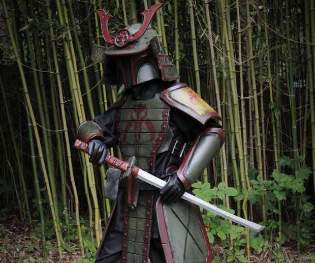

Step 10: Finished Product
Break that costume in! Make sure it fits right and its comfortable, Then bring it to a con and show it off!
The sky's the limit when working with eva foam, you can make small costumes or huge ones, it all just takes practice.
