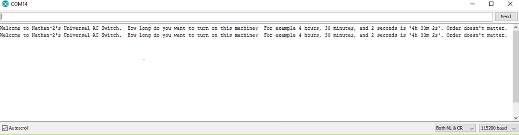

  • Optional(Do you want to be a pro in electrical engineering and show others your schematics? Check out Fritzing)
Just watch the video above in 1080p or read the directions below.
  • In order to make the HC-05 a wireless programmer, it must talk in the same rhythm as the Arduino. And when I mean rhythm I mean baud rate. Right now, when you got your HC-05 in the mail, it’s probably at a default baud rate of 38400. But the Arduino UNO is at 115200/57600 and the Nano is at 57600. Basically, if you read the Atmega square chip or rectangular IC you will see the name. AtMega328 is usually 57600 baud rate and the AtMega168 is 19200(pretty slow). You can always play around with them as the only possible baud rates the HC-05 can handle are: 4800, 9600, 19200, 38400, 57600, 115200, 23400, 460800, 921600, 1382400.In order to set the baud rate, one must enter AT command mode.
  1. Open the Arduino IDE.
  2. Go to File->Open->wherever you saved the AT_Command.ino sketch(it's usually in Downloads)
  3. Open AT_Command.ino
    1. You could also open a new sketch, and copy and paste the code from above making sure you overwrite the blank setup() and loop() in the new sketch.
  4. Click the Tools->Board: and select your board(I am using an Arduino Uno)
  5. Click the Tools->Port: and select your board port number(you can check this by going to device manager and finding your USB device in COM ports)
  6. Make sure your circuit is still unchanged from the previous step(HC-05's TX to pin 10 and HC-05's RX to pin 11 through voltage divider)
  7. Click upload and wait until it says "Done uploading" at the bottom of the screen.
  8. Now disconnect the HC-05's Vcc(5v).
  9. Press the button on the back of the HC-05 and at the same time plug in the Vcc(5v). The LED should start blinking every 2 seconds.
  10. Click Serial monitor at the top right-hand corner(it looks like a magnifying glass)
  11. You will see a blank white screen, but then it says "Enter AT Commands:"
  12. Make sure the settings in the bottom left corner of the serial monitor says "Both NL and CR" and a baud rate of 9600.
  13. Enter the following AT commands after getting an OK response for each command(Enter the 6 commands below. AT+NAME and AT+PSWD are optional).

  Serial.println("Welcome to Nathan^2's Universal AC Switch.  How long do you want to turn on this machine?  For example 4 hours, 30 minutes, and 2 seconds is '4h 30m 2s'. Order doesn't matter.");

Step 13: Conclusion: Tips and Tricks With Complete Manual
  1. The first step is open your Bluetooth devices and find your device.(Remember, your password was set when we were in AT Command mode-mine was 1234) "The Default password is 1234"
  2. Second, open the Arduino Bluetooth Controller App.
  3. Third, click on your device and make sure no other device is connected to it. Also, make sure the Arduino is plugged in via DC jack or USB.
    1. FYI: The USB port is unavailable because the Bluetooth module has turned your Arduino into a wireless receiver, so you can't program via USB, but you can power it via USB and then program wirelessly(As if you were programming via USB, but you are not).
  4. Click on Terminal Mode.
In the beginning, "The Final Countdown" timer will ask you how long you want to turn on your machine.
  • The annoying thing is that when you plug in your Arduino with power, the Serial spits out the Intro paragraph(which can be deleted in the Setup()).
      1. The Serial repeats Setup() every time a new device connects
      2. So every time you enter the program via Bluetooth after plugging in the Arduino's power, you will be given the Intro paragraph twice!
        1. To avoid this, enter terminal mode twice(just exit out of the program and click on your Bluetooth device again). You only have to do this once every time you give the Arduino power.
        2. This unavoidable bug happens only for the first time when your phone connects to the Arduino.
          1. There are no consequences if you enter terminal mode once or twice(It's just less annoying).
***************************************************************************************************************************** Complete Manual
  1. Timer commands
    • If you wanted a timer for 1 hour and 29minutes and 30s, you would type '1h29m30s' and the order doesn't matter. And if you really wanted to mess around you could say ' 29am 1 wh 3q,0wes ' and still get the same result; as long as the number of hours/minutes/seconds is always before the letter that stands for the unit of time, it is a valid keystroke. Except for the letters 'y' and 'v', since they have the potential to activate when the timer hasn't started yet(look below).
    • Let's say we want a Ninja smoothie maker to run for 1 minute and 30seconds
      1. We would type in '1m30s'
        1. If you don't type anything after your input, the Arduino will assume you are confused and will give you a hint. For example "Hint: Type 'v' to view timer." means when you type 'v' the Arduino will talk back to you and tell you how much time you have entered. It's kind of like an Advertisement. These are just one of the benefits to multitasking.
      2. These commands only work when the Timer hasn't started(for safety reasons)
        • How to view timer?
          • Type 'v' //You don't have to type v to start the timer; it just ensures you if what you typed is correct or not.
        • How to start the timer?
          • Type 'y' for yes.
            • A beep will follow after you start, and the LED will start to fade at a faster rate.
      3. These commands only work after the timer has started(for safety reasons, such as someone's baby clicking 'y' too many times on your phone and sets the timer for infinite(or greater than 50 days :] ))
        • How to pause/resume timer?
          • Type 'p' //spits out the time a pauses timer
        • How to reset the Timer?
          1. Type 'r'
        • How to end the Timer?
          1. Type 'e'
        • How to watch the amount of Time Remaining?
          1. Type 'w' //spits out the time and does nothing else
      4. These commands work at all times(Because it's safe either way)
        • How to turn off Buzzer(Sound)?
          1. Type 'b'
          2. How to toggle the Light? //Say you don't like the light because it's too bright. Well, you can turn it off and the timer will still do its job! Isn't multitasking beautiful!
            • Type 'l' to toggle light from Off->On->Fading
            • When paused, the LED will blink every second.When resuming, the LED will continue at its normal faster rate.
          3. Tricks
            • Let's say you wanted a time of "1m40s" but you accidentally typed "1m0s". Well, it is quite simple to fix. All you do is type "40s". Then, when you type 'v' to view your timer, you will see the Arduino say 1 minute and 40 seconds.
            • Combos:
              1. Say you are too lazy with talking with your Arduino friend and you just want to get the timer started. Well, now you can cut Arduino off.
                1. Say you just want to cook that salmon for 1 hour, 20 minutes, and 5 seconds. All you have to type is "1h20m5svy"
          4. You probably noticed that you can't type a time above 1 hour and 30 minutes. This is because I wanted to add a safety feature to this product.
            1. Ex: Say someone's baby accidentally types in '100h'. This would last 100 hours which probably wouldn't be good for the machine and your electrical bill!
            2. If you want to change this limitation, go to the "Final Countdown" Timer Code and type CTRL+F. Now search for 'maxLoad'. Now, above maxLoad you will notice three int variables.
                1. Right now, the max run time is 1 hour and 30 minutes.
              1. But if you want a maximum run time of 4 hours, you would say:
                1. int hr=4;
                2. int mn=0;
                3. int sec=0;
