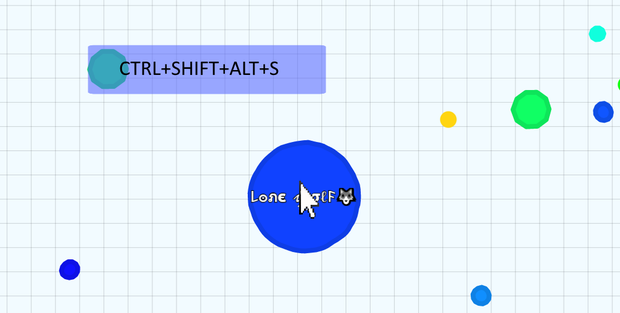

Before Hack
*I made the mouse a circle so it can be easier to see while gaming*
As you can see, the mouse travels across the screen in a mess, which is bad for accuracy in gaming.
After Hack
When we're done with this project, this is what the result will be...a perfect circle for the mouse cursor to be trapped in.
Theory(Trap the mouse cursor)
After months of learning new programming languages, I found out a way to limit a mouse within any shape to my desire. In this example, I decided to trap the mouse cursor inside a Circle.
Mouse Trapped in circle

Step 6: Mouse Position and Combo
  • Next, place your mouse cursor at the exact center of the player.
  • You know you hit the center when the player stops moving. This part can be tedious so take your time. But when u get it, it'll be worth it. Unfortunately, there is no way for AutoHotKey to know the center of the player.
Run button in AutoHotKey
  • Finally, use The Macro combo as shown below.
Macro Combo: "CTRL+SHIFT+ALT+S"
To escape trap: "ESC"
Stop program: "CTRL+ESC"
I made the macro combo keystroke long because it is rare that any program in the world(other than this one) reacts to it. So there will be no mishap.
