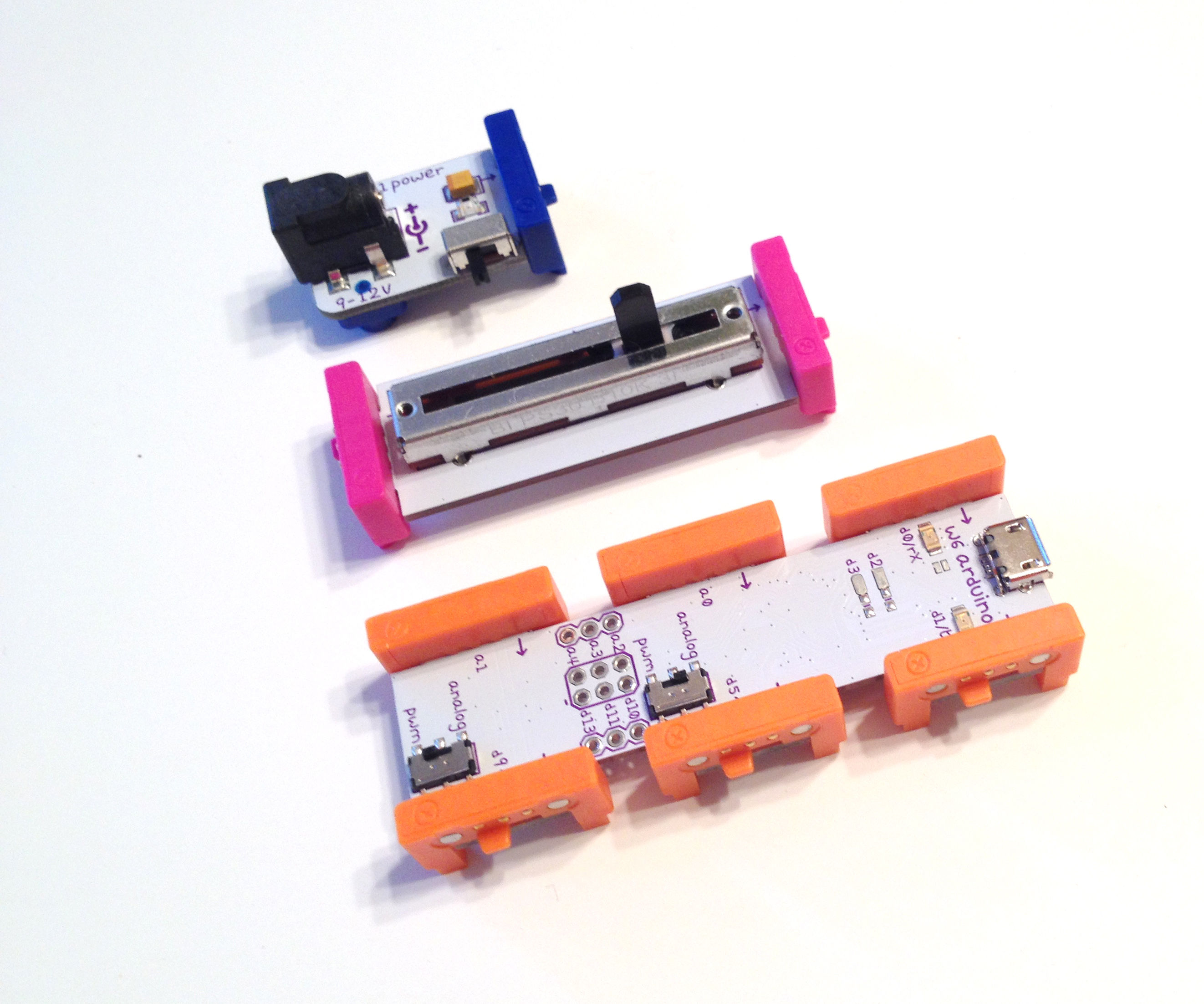

The code uses a serial event to read the incoming data and act upon it. The tricky part here is choosing the correct serial port. In the setup we're printing a list of all the serial ports that your computer sees. You can see that I chose the 8th serial port listed, which is known as Serial.list()[7] because we start counting at zero.
Once you've got your littleBits Arduino connected and powered up and running, we can run the code.
Step 3: Run Some Code
If all goes well, your code will run, and you can now use the littleBits slide dimmer to adjust the colored bar. Processing is a fairly easy language to get into. If you've never done any programming before, it may be a little intimidating, but there's some great tutorials and a nice reference to help you out.
Step 4: Slide That Slider!
This is a simple example, but it shows using the littleBits Arduino module and slider dimmer to animate something on your computer from the physical world. Think of the possibilities!
