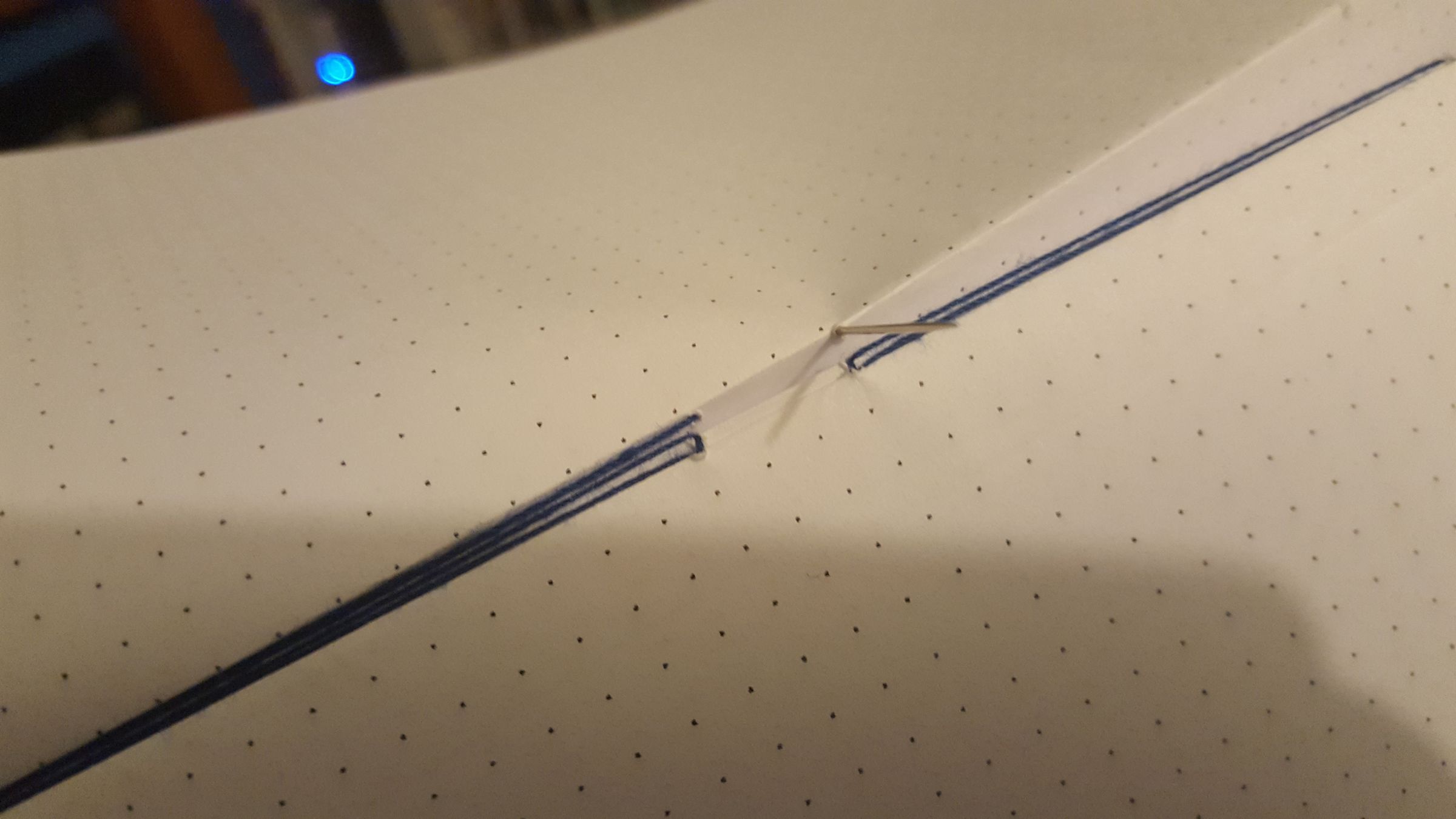

Step 6: Stitching (god Almighty, the Stitching)
get your thread and make a big bulky knot at the end. then start stitching! please follow the diagram.
the most important thing you should remember is that there should always be some thread connecting a hole in one signature to the corresponding hole in the next signature.
if you do this, the thread will pass every hole three times (except for the first and last signature.)
please don't ask me what kind of binding this is because i have no idea. all i know is that i took my cue from http://michaelshannon.us/makeabook/ and made a few tweaks (like the three exposed stitches, that's me)
for most bindings, people use just one piece of thread for the entire stitching process. no breaks. i knew that there's no way in hell i can manage that so i just take an arm's length of thread and stitch until it runs out. an arm's length will usually last for 4-5 signatures. when it runs out, i just make a couple of overhand knots at the nearest piece of thread and continue.
after you stitch, it should look like the picture.
