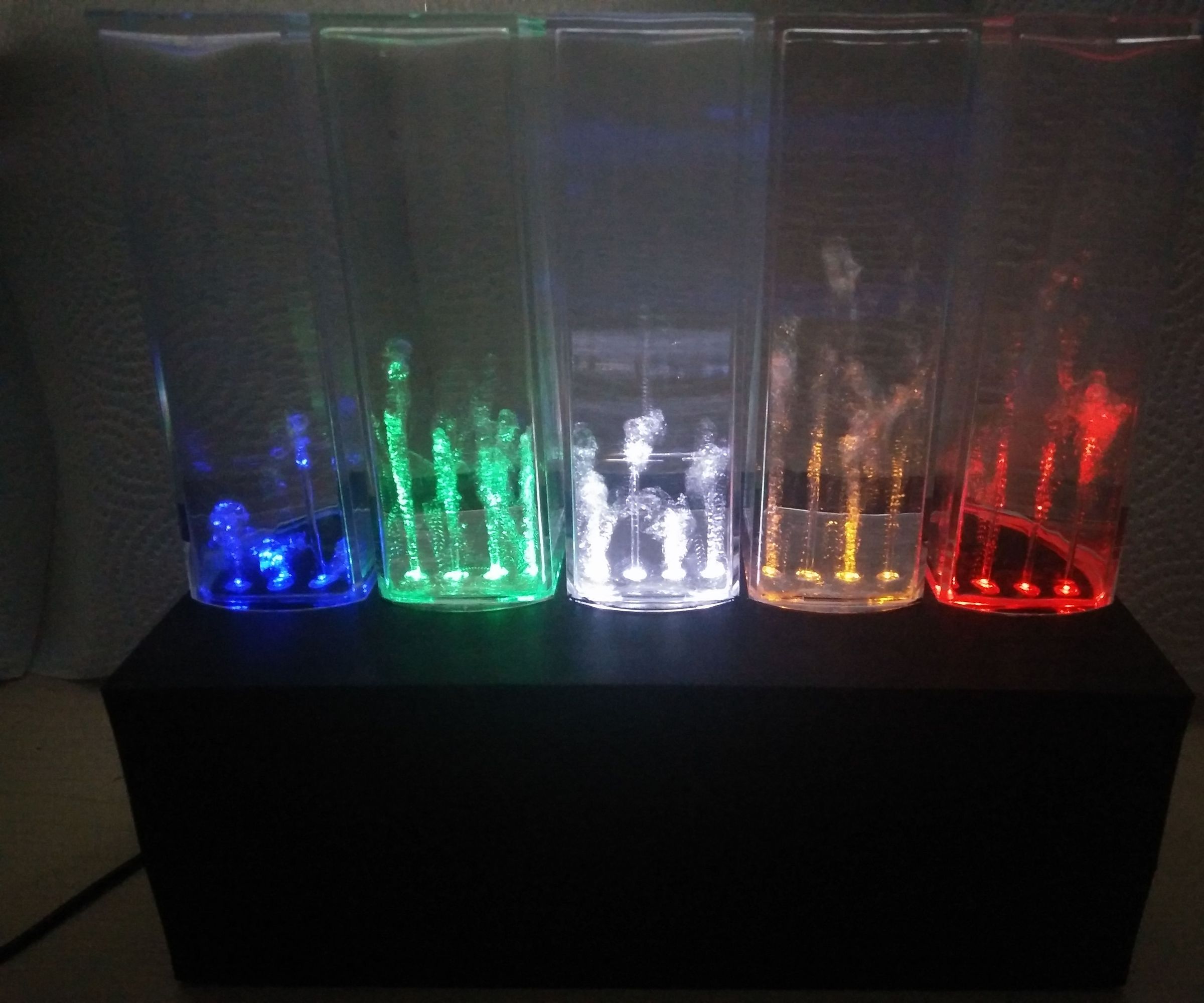

the very bottom of the case holds 4 1/8" diameter stove bolts from homedepot, the top half has captive slots to hold the nuts, this allows the two halfs to be bolted togeth to seal it as one box.
- cool austin commented on cool austin's instructable Water Speaker EqualizerView Instructable »
the PCB is from sayal electronics (sorry don't have a part number)it measures, 10.5cm x 16.5cm
the socket is used to hold the MSGEQ7 ic - this ic is a 7 channel equalizer , the data stream is read by the arduino. the ic can be sensative which is why i soldered the socket holder instead of soldering the ic directly
The mini 3w speakers that came with the unit, swiftly found them selves in my "junk" extra box, for who know one day I might need them (they are actually half decent), as for music audio output, I used a 3.5mm jack on the back, where I can plug in any external stereo system I want.
View Instructable »the exterior measurements of the box are: (L) 240mm x (W) 140mm x (H) 90mmThe side walls were 2mm thickBottom and Top are 4mm thick
It took quite some time, the most time consuming is 3d printing and the perf board as I didn't fully know how I would set up the board, I try to limit the length and size of traces and jumpers. Ideally You might convert it to a PCB design, I would recommend changing the motor drive circuit as it has PWM noise when speakers are connected unleash you can change the timers as suggested by someone else's comments.If you're proficient with Circuit board / perf board assembly and followed the photos It might be possible to do in 4 hours, its been awhile since I did this project so I'm not sure how long it too (likely a night - 8 hours from scratch; but all the hard stuff is done now, you just have to follow along) If you had the 3d printing done ahead of time you might be able to do the project…
