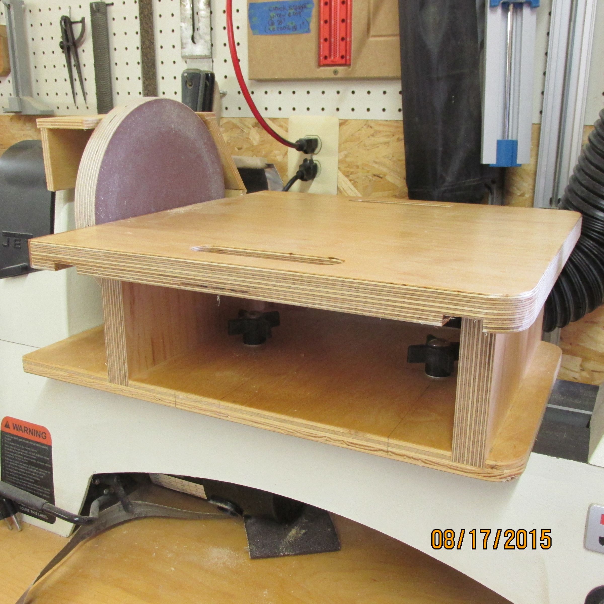

Very crafty design! I notice a few makers commenting on safety. Brings to mind a sander, albeit somewhat larger than your mini-saw, that I made a few years ago, as an accessory to my wood lathe. While in a hurry, right after I made it, I was sanding a piece of wood, and it got caught between the disk and table. Lucky me, my grandson was in the shop to witness! I found it necessary to move the table very close to the disk (perhaps ~0.010" clearance), which seemed to alleviate this problem. If you decide to sand on your saw, you may want to lessen that gap.
