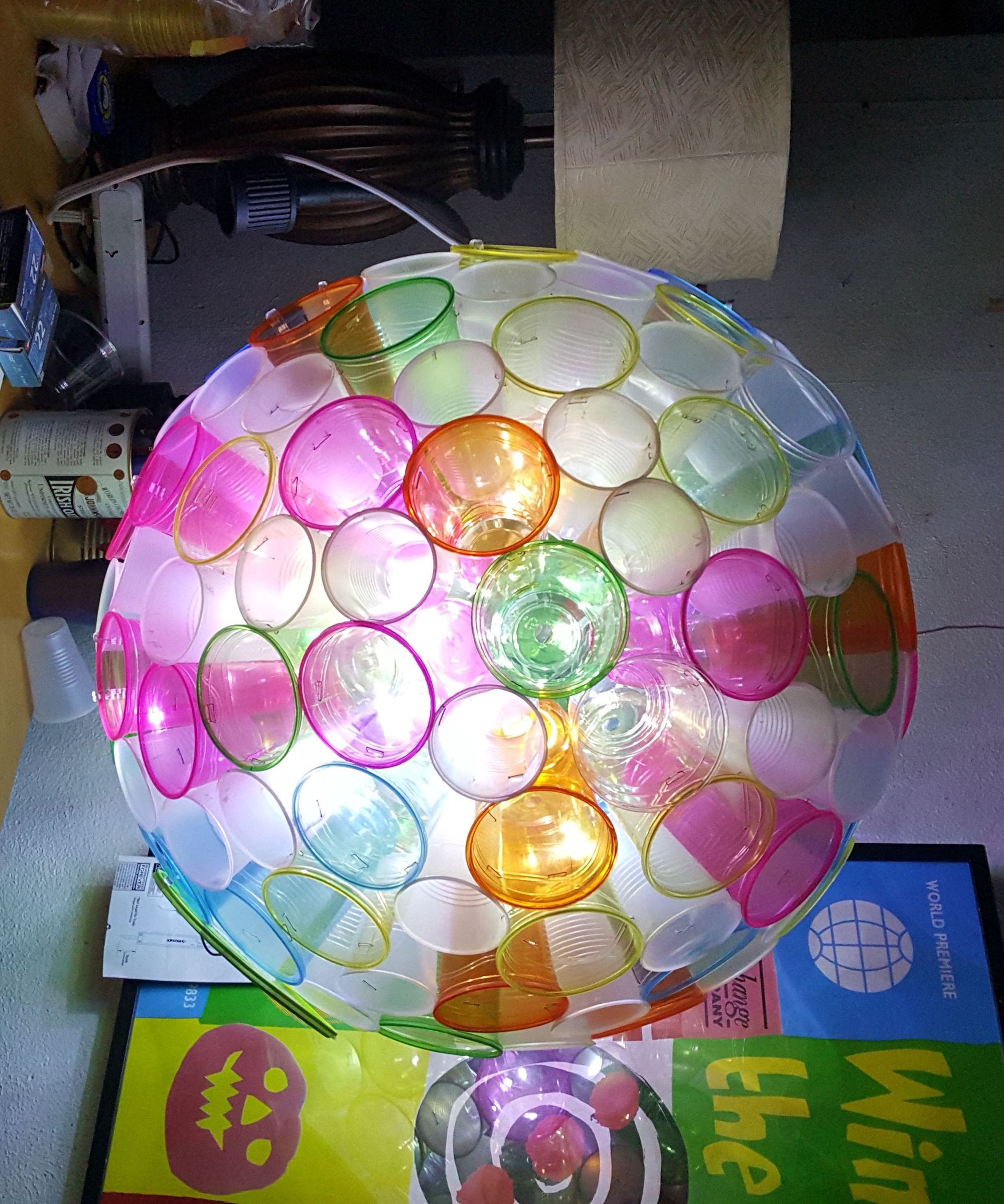

There are 2 SIZES OF 9oz SOLO CUPS. There is a one that looks like standard cups (tall and thin- calling them water cups) BUT ALSO there is a short and squatty cup (calling them punch cups).
The issue everyone is having of 12 not making a ring has probably purchased the wrong ones. You need the PUNCH CUPS.

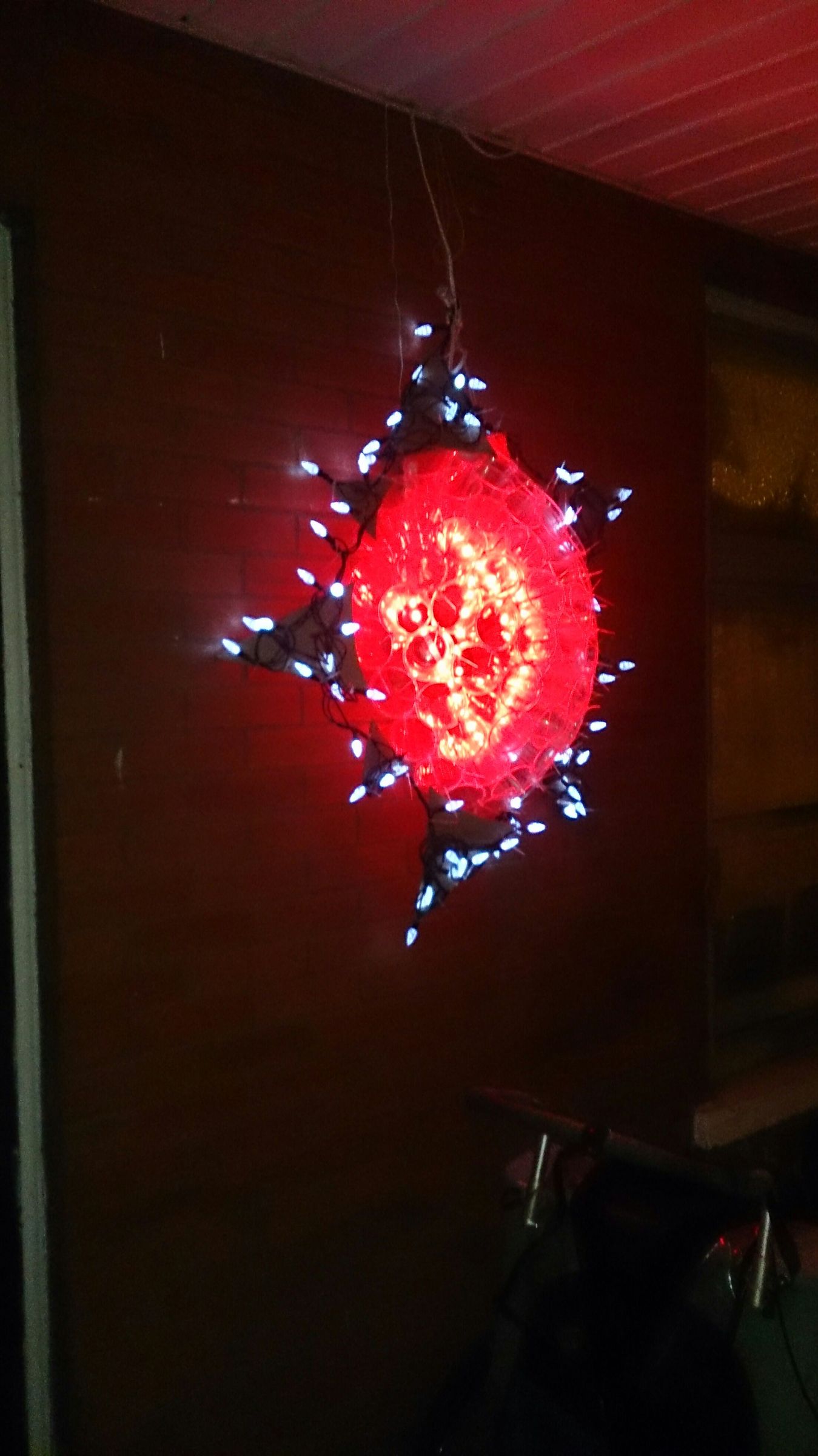

I started one, but turns out I'd bought 12oz cups so the sphere was going to big for me, so I left as half sphere and put it against wall, added some rays. viola. looks like with minor mod it could be eye of sauron for Halloween.
