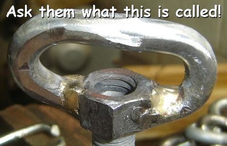

Step 1: Preparing a Link
Using a thin cutoff heel, I cut off the irregular edges where the link had been twice cut to free it from the links adjacent.
The idea and intent being to flatten the ends/edges so as to mate them as neatly as I might to the old 1/2" nut I'd fished out of my decades old collection of 'workshop stuff.'
For this activity I simply held the salvaged link in the vise as I worked to shape the link to better accommodate the old nut.

Step 2: Bring Them Together
As you see, I used an old section of threaded rod to hold the nut I knew was likely to get too hot to handle much less to hold against the link with bare or even gloved fingers.
I worked the link ends and repeatedly tested the fit by: trying to wedge the nut in place, removing a bit more link end, fitting again and repeating until I was able to FORCE the nut between the opposing ends of the (very heavy, hard & tough) link.
Then I dug out my acetylene tank set and attempted to recall how it worked. What the relative pressure settings might be. Where I'd left the partial welding rods and so forth. Lack of practice does not lead to precision nor perfection - not even close!
Nonetheless, committed - in for a penny and so on. I opened the valves adjusted a flame, donned some safety lens and took a bit of welding rod to the glowing junctures I hope to make sufficiently permanent to survive burial beneath ground until the next lid lifting.
Now, there are steels and then there are steels and I know not which I was attempting to weld into (effectively) one piece. Nor had I any idea of where my welding rod came from, what type it was or if it was 'welding rod' at all.
When I'd welded enough to hold the nut, I found the brazing rod and decided to 'fill in' with brass - attempting to compensate with volume for my lack of technique in Round One.
I think it worked.
Step 3: Finishing
First with a grinding wheel, subsequently with a 180 Grit flap disk I worked to clean up the area of 'the welds' as much to see if they were indeed welded as to pretty them up for the photographer.

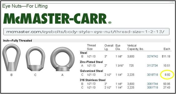

Please lemme know if you do. "Mike Davis replied ... Lifting Eye at McMaster Carr Thanks that was quick!
Well, I saved about eleven dollars!

Well, you know 'cause I put the name in the title. But, long after he left I had no idea what to type into Googol. I asked here and there and finally got an answer from a fella on the Woodworker's blog thing and a link to one on MacMastrer Carr(SP?) to find out that a nut welded to an old chain link could cost me eight bucks or more!
