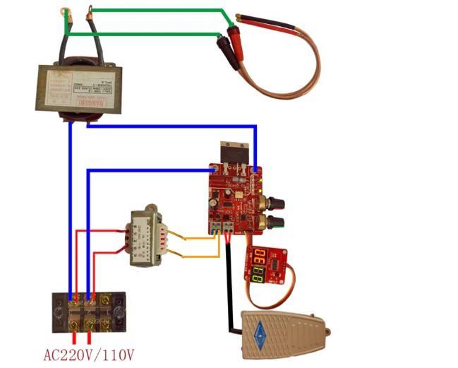

Making a spot welder yourself is actually a real easy job to do. But you have to do this at your own risk. Basic knowledge of electronics and the dangers of it are most important.
✅ Click to see how to build this upgraded DIY spot welder - https://youtu.be/y3zuP3vGXLk
Sequre SQ-SW1 Spot Welder - https://bit.ly/3Fhvhbs (3% OFF with coupon code DONNYTEREK)
List to the parts needed for the spot welder can be found above.
I have made a video on how I built my spot welder, but I'm actually not too proud of it. It definitely needs an upgrade - higher current output for better welds and higher quality welding handles.
There is definitely many sources and tutorials online on how you can make a spot welder yourself for cheap so I highly encourage you to check those out for ideas. The design is real simple and all you basically need is some thick cable, a transformer from a microwave and a controller, following with a few bits and pieces to complete the build. Refer to the wiring diagram shown below. Instead of the foot switch shown on the bottom right corner, we will wire up a DC jack connector which will connect to the spot welding pen, which has a switch mounted inside.

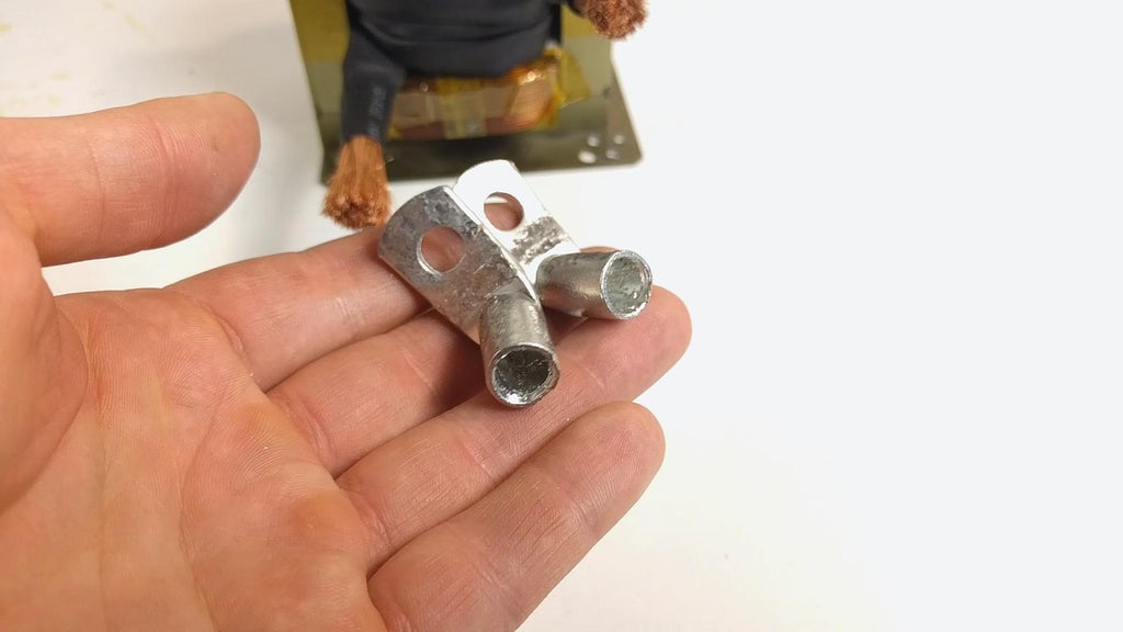

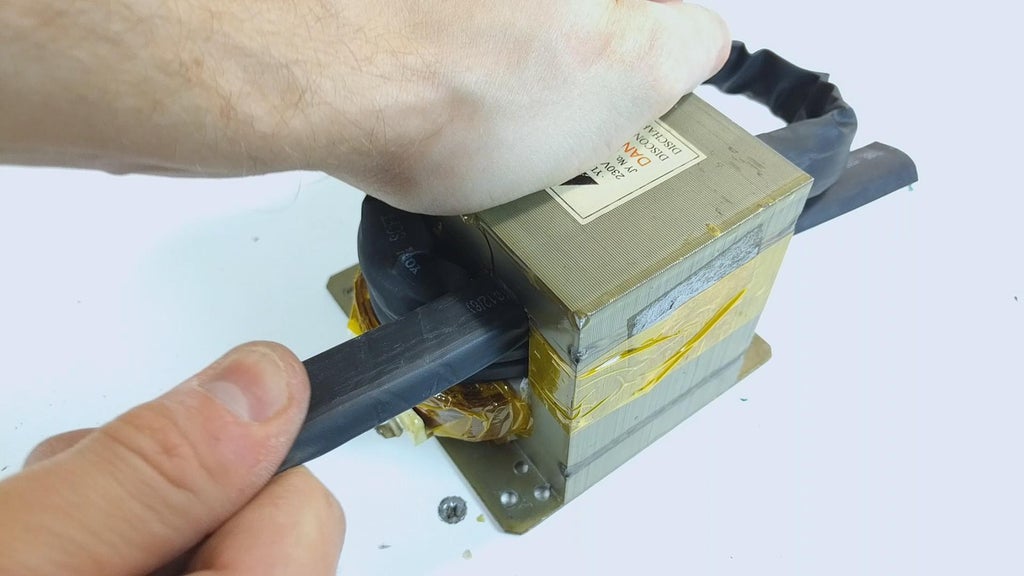

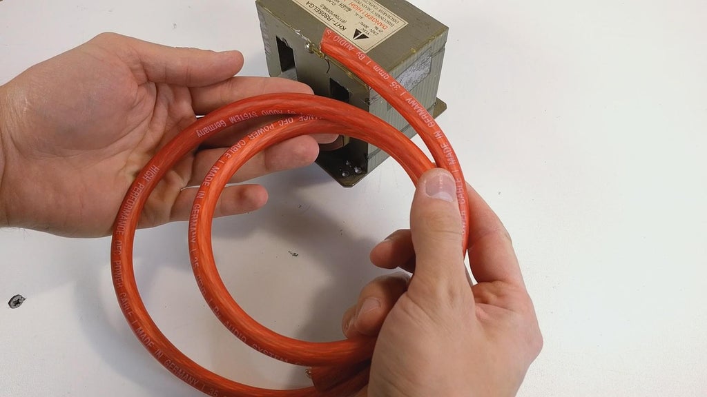

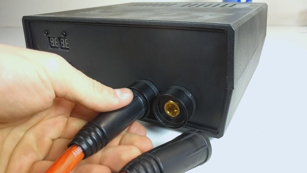

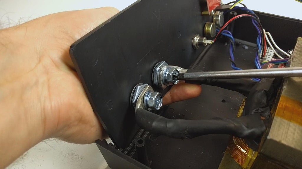

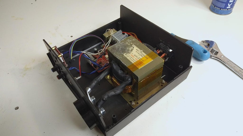

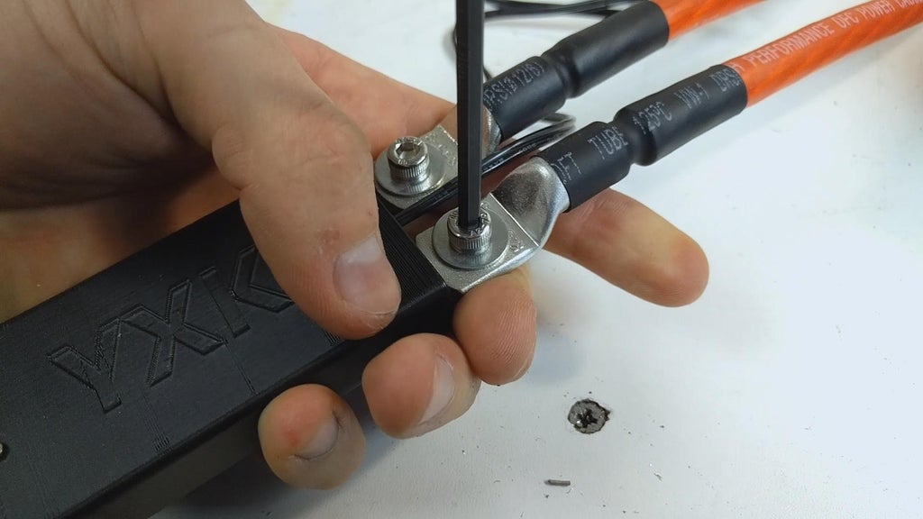

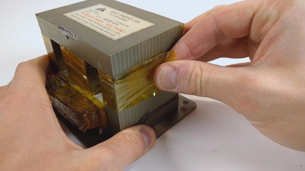

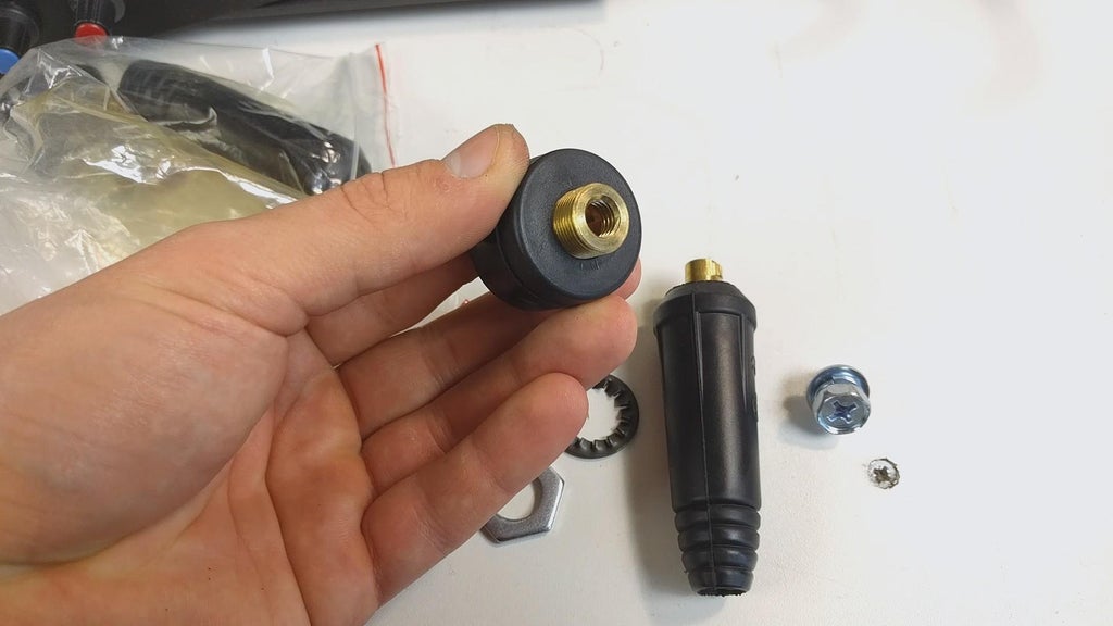

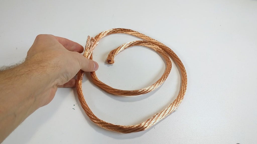

To upgrade my spot welder I got myself 2 meters of high quality 35 square millimeter copper cable and stripped off its insulation.

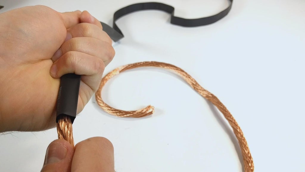

I then cut some heat shrink tubing the length of the cable and used it as a thin insulation on the cable to make it easier to wind it inside the transformer. Before winding the transformer with the newly insulated cable, I protected it with some Kapton tape. Getting 4 windings inside the transfomer is necessary but may be a bit tough to do. You can flatten the cable with a few taps of a hammer beforehand to make it easier.

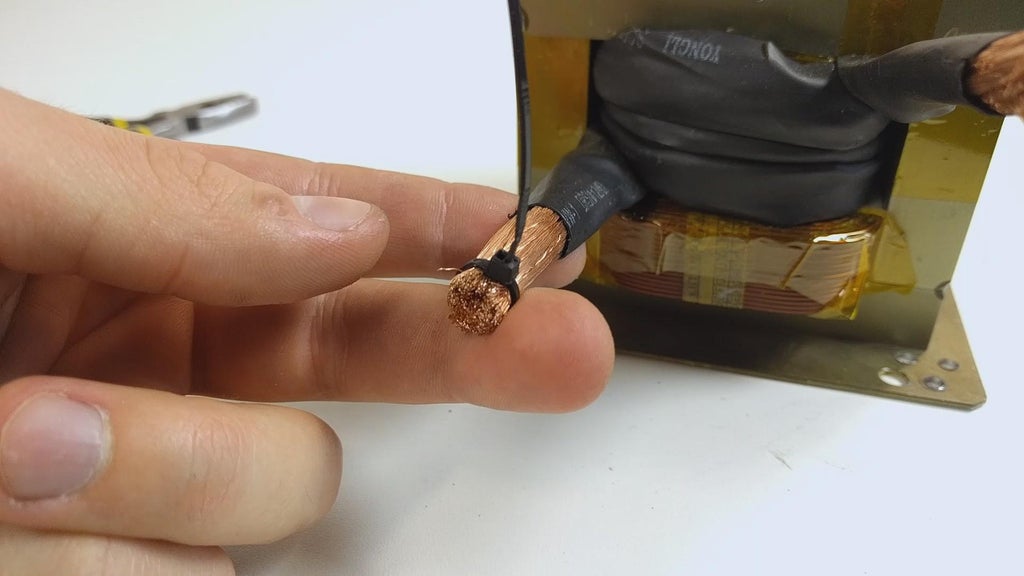

Now that I have the cable winded inside the transformer, I cut off a bit of the heat shrink off the ends of the cables and use zip ties to compress the cable and make it easier to slide a lug connector on. I bent the lug connectors at an angle for bolting it to the panel later. Once they are fitted on, I applied some solder using a small blowtorch flame.
Now that I have the lug nuts on the cable ends, I enlarged the previously made holes in the front panel of the spot welder with a step drill bit to a 14 mm hole. I then mounted the quick connectors to the panel and placed the transformer back in the box. Once the cable lugs are bolted to the quick connectors, I made two cables for the welding pen to connect to. I recommend you use at least a meter of cable for each. To those cables I connected the spot welding pen using the provided bolts.
With that done, the spot welder is completed (upgraded) and we can move on to the battery build.
