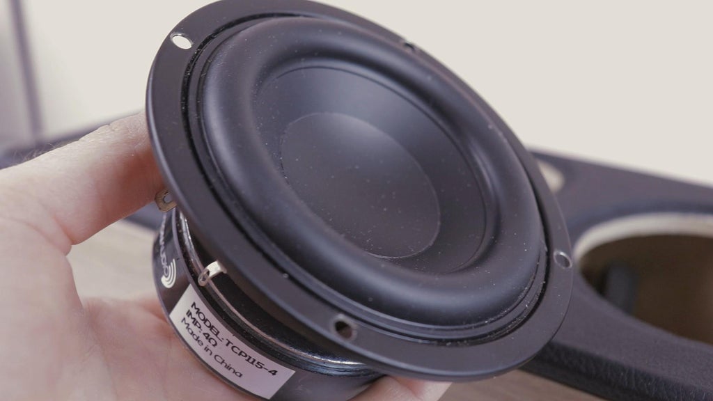

This speaker is based on the Dayton Audio TCP115-4 4" woofer combined with the Dayton Audio TD20F-4 3/4" Soft Dome Neodymium Tweeter. The speakers are powered by the Bluetooth Amplifier Board with Wifi Up2stream Amp V4. This small amplifier board is cramped with features. It has many audio inputs, including Bluetooth, Aux, USB and optical. Music can also be streamed via internet from platforms like Spotify, Deezer and more. The amplifier can be controlled by an app and can provide 2x50W to 4 ohm speakers.

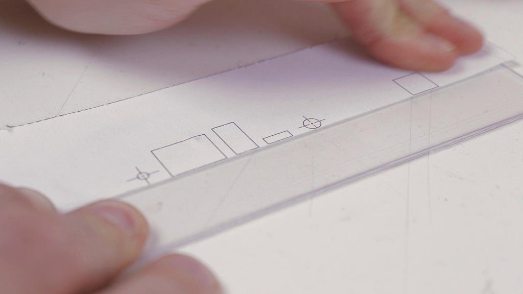

Step 2: Let's Start the Build!
Make sure you check and download the attached plans for the speaker build.

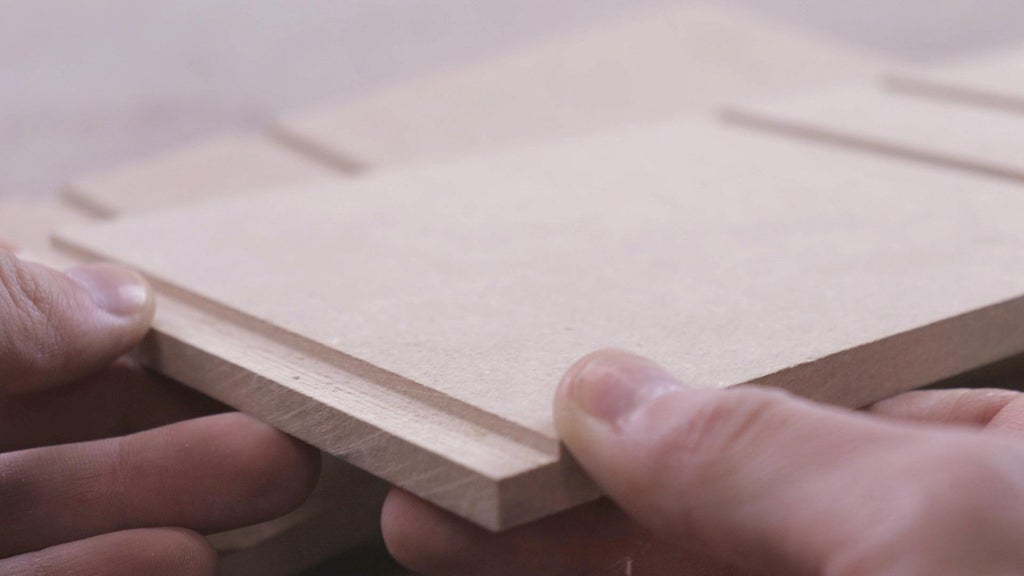

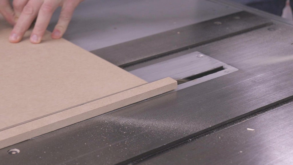

The material used for the enclosure is 10mm (3/8 in) MDF board. You can use 12mm or thicker board but you will have to adjust the plans accordingly.
Also note that in the video I have cut rabbets into the top and bottom panels. This is not necessary for the enclosure but if you wish to do so, make sure to lengthen the side panels for the depth that your rabbet is cut.
Now that we have the plans printed out and ready, I cut the panels out using a table saw. The enclosure can be cut using a jigsaw as well but might need some sanding to get the edges straight.

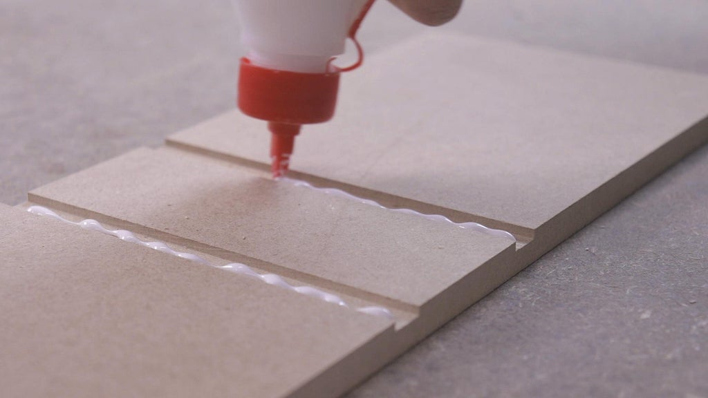

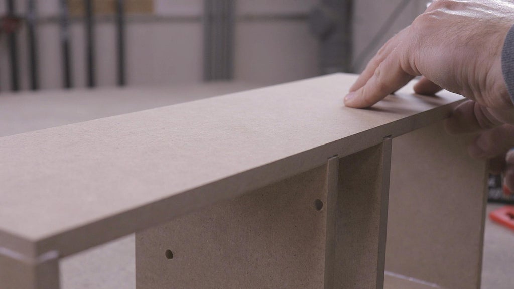

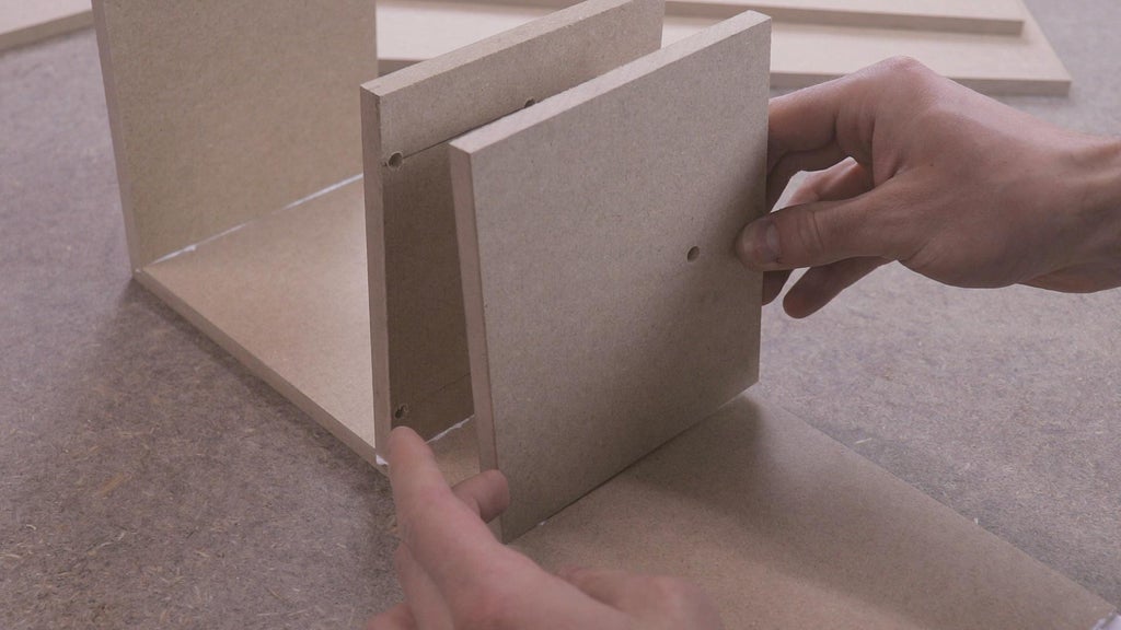

Step 3: Glue Up
Now that we have the panels cut out, we can glue the enclosure together. Having the rabbets cut in the top and bottom panels really helps here with the alignment of the pieces. I started by gluing in the side panels and the top and bottom panels together. I then glued the back panel in place.
![](https://content.instructables.com/ORIG/FUN/VBOK/KNQ1E1U0/FUNVBOKKNQ1E1U0.jpg?auto=webp&frame=1&width=1024&height=1024&fit=bounds)
![](https://content.instructables.com/ORIG/FG0/HXN9/KNQ1E1U1/FG0HXN9KNQ1E1U1.jpg?auto=webp&frame=1&width=1024&height=1024&fit=bounds)
![](https://content.instructables.com/ORIG/FFH/FQJB/KNQ1E1U2/FFHFQJBKNQ1E1U2.jpg?auto=webp&frame=1&width=1024&height=1024&fit=bounds)

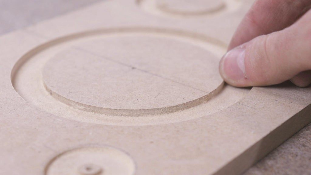

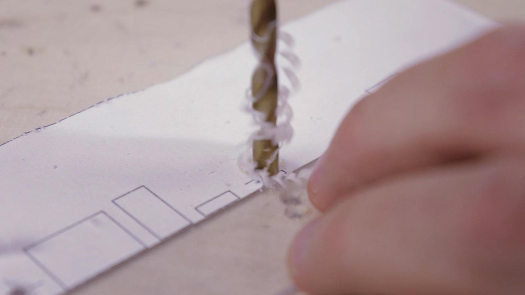

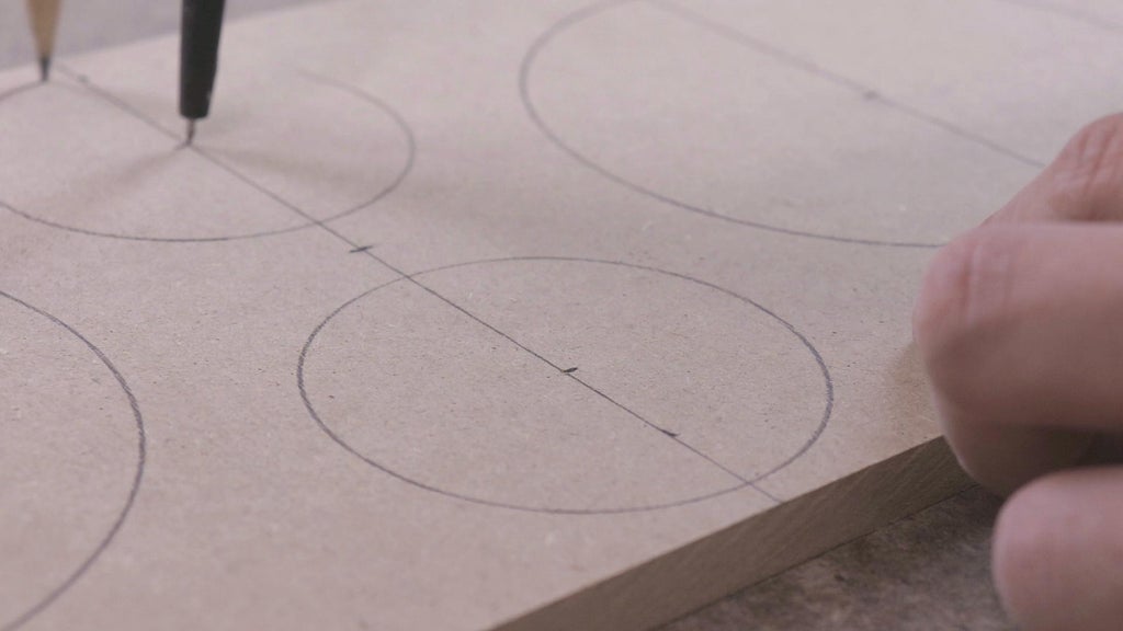

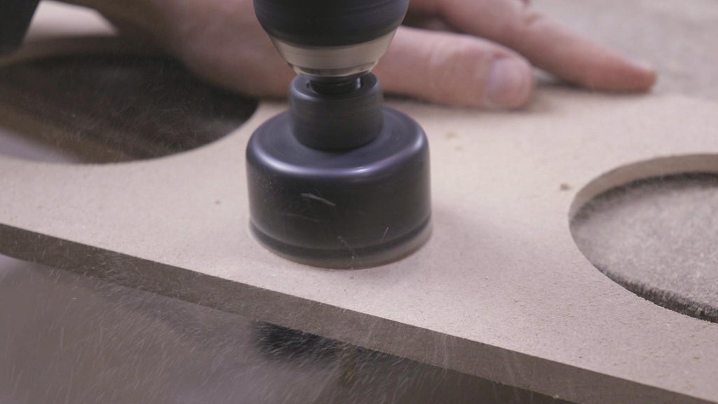

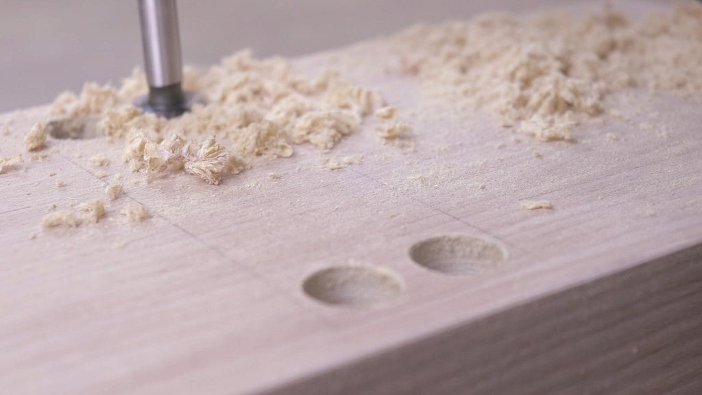

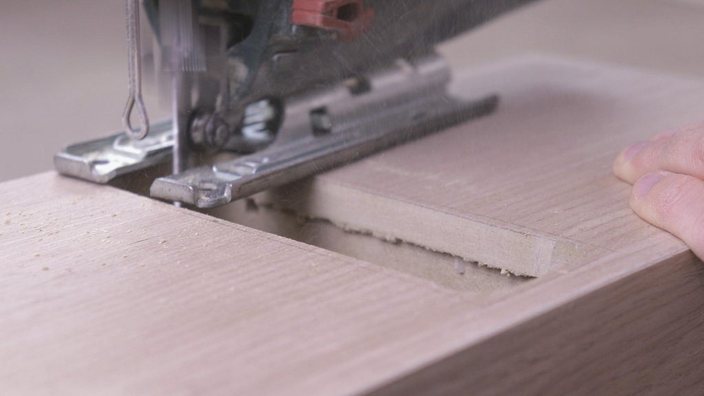

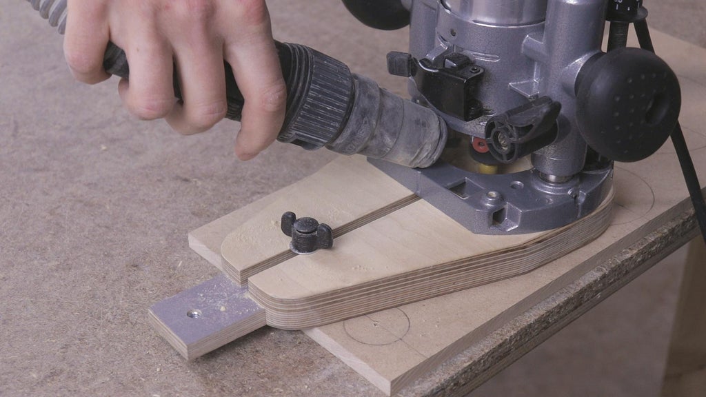

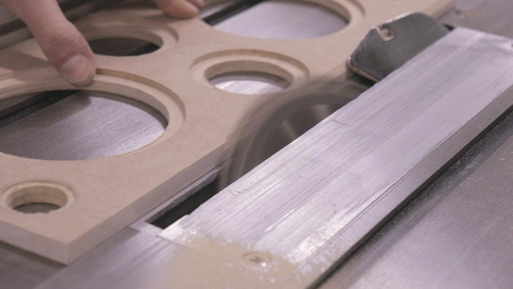

Step 4: Cutting Out the Circles
![](https://content.instructables.com/ORIG/FAK/WJ4Z/KNQ1E1ZE/FAKWJ4ZKNQ1E1ZE.jpg?auto=webp&frame=1&width=1024&height=1024&fit=bounds)
![](https://content.instructables.com/ORIG/FQF/V4J1/KNQ1E1ZF/FQFV4J1KNQ1E1ZF.jpg?auto=webp&frame=1&width=1024&height=1024&fit=bounds)
![](https://content.instructables.com/ORIG/F6C/JOXG/KNQ1E1ZG/F6CJOXGKNQ1E1ZG.jpg?auto=webp&frame=1&width=1024&height=1024&fit=bounds)
![](https://content.instructables.com/ORIG/F0N/A23N/KNQ1E1ZI/F0NA23NKNQ1E1ZI.jpg?auto=webp&frame=1&width=1024&height=1024&fit=bounds)
![](https://content.instructables.com/ORIG/FR2/OV4P/KNQ1E1ZJ/FR2OV4PKNQ1E1ZJ.jpg?auto=webp&frame=1&width=1024&height=1024&fit=bounds)

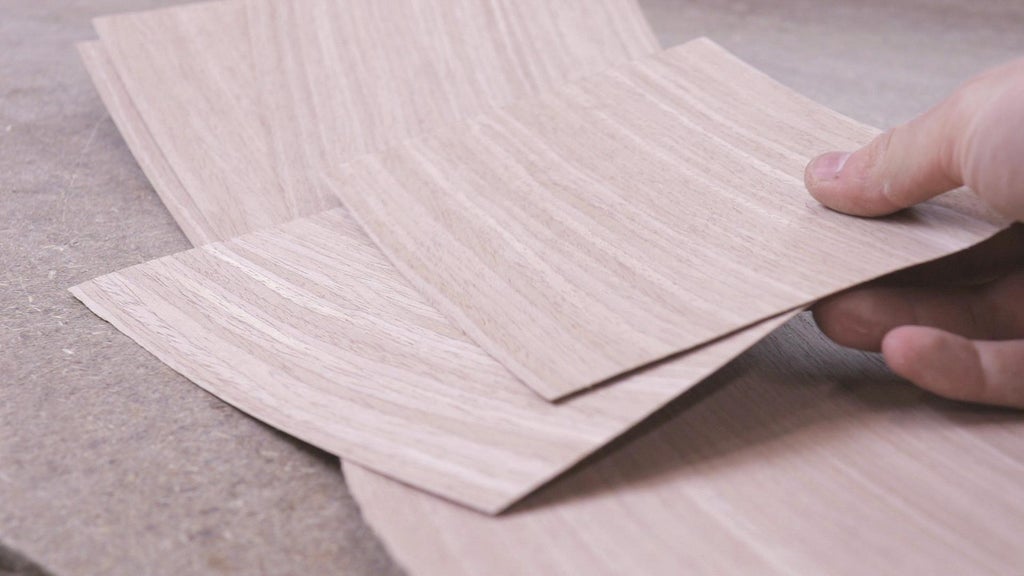

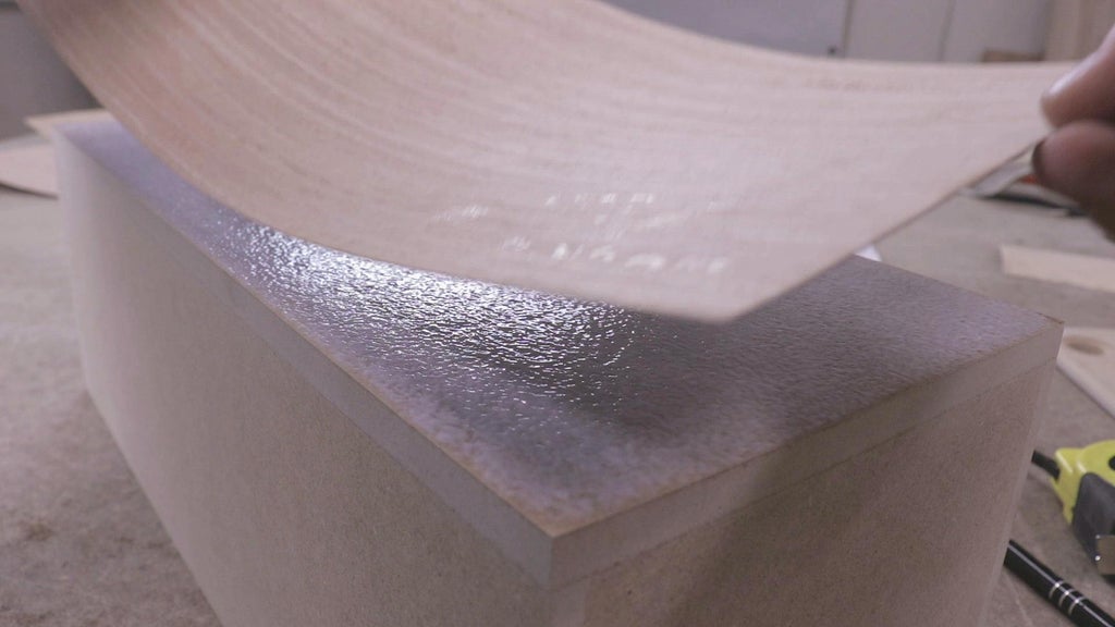

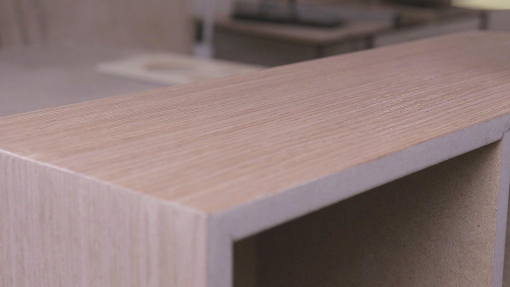

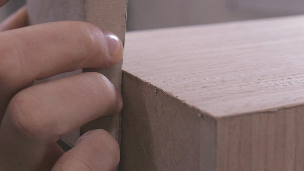

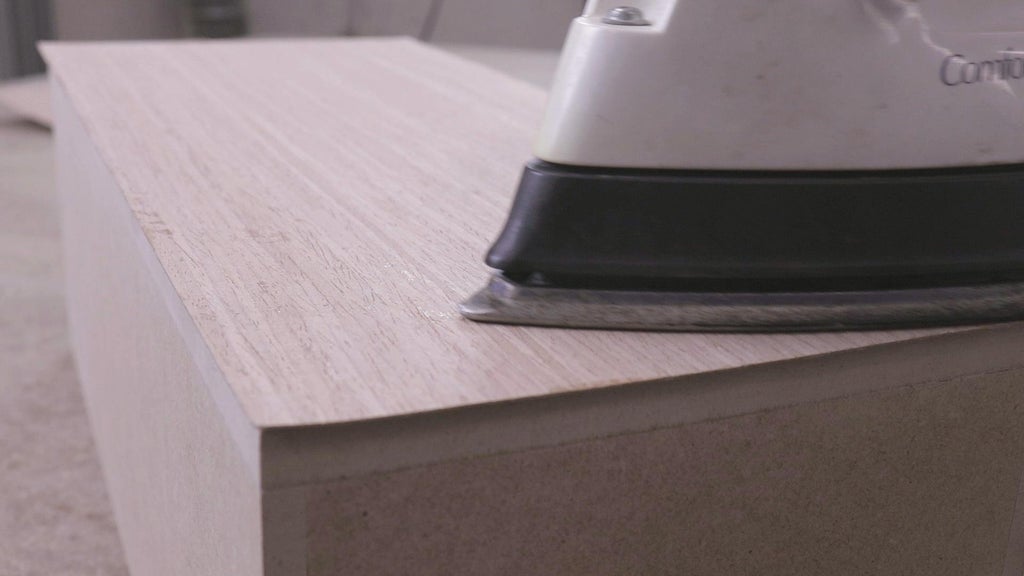

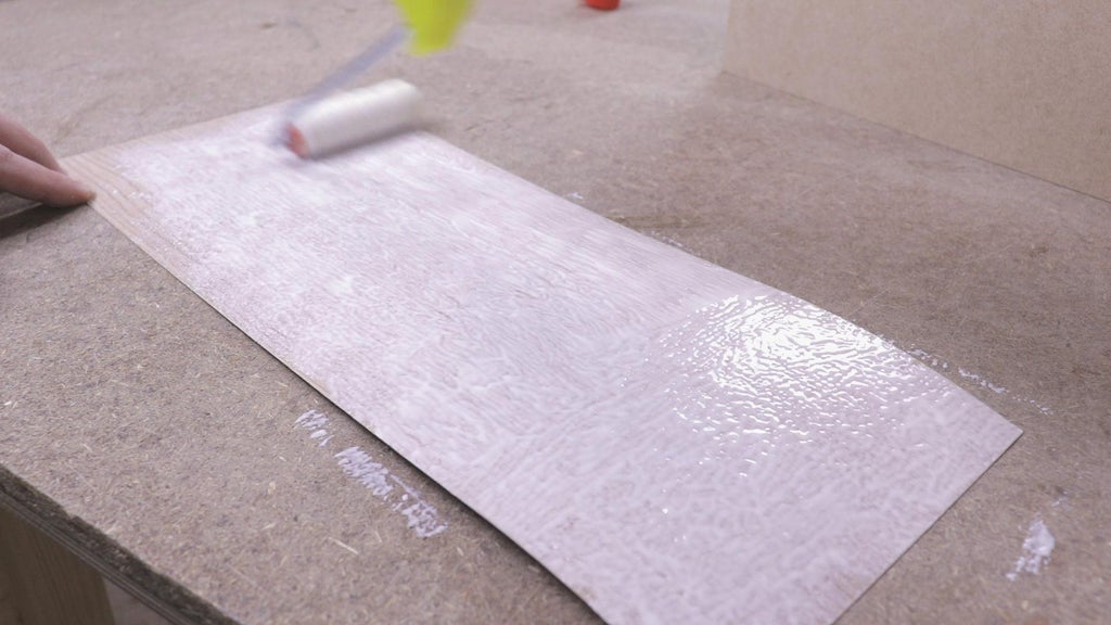

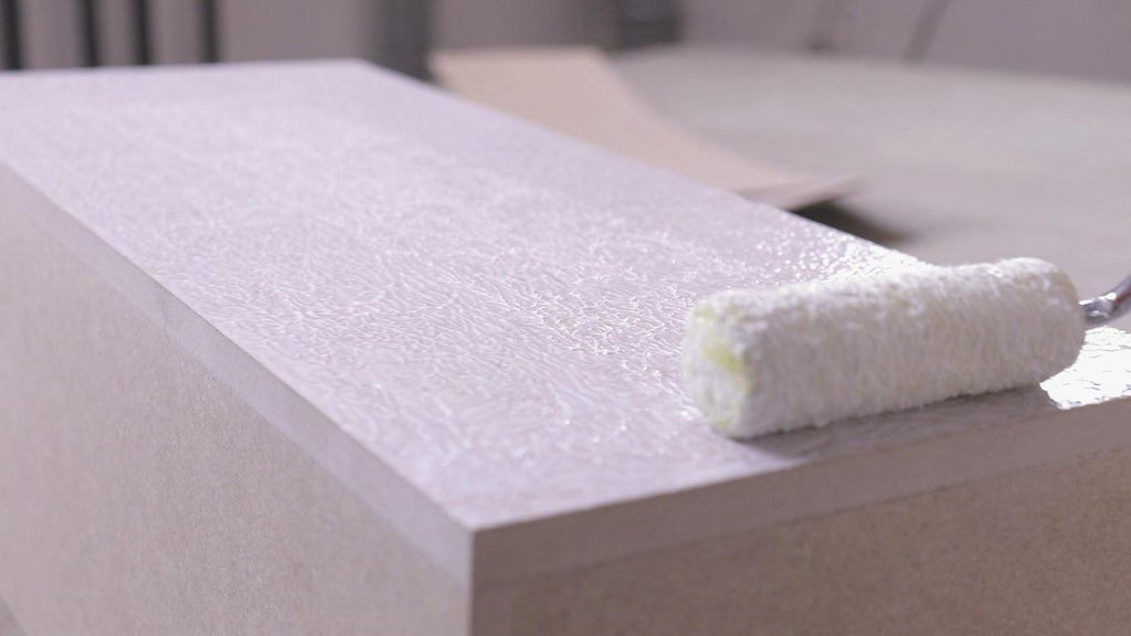

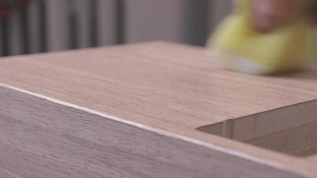

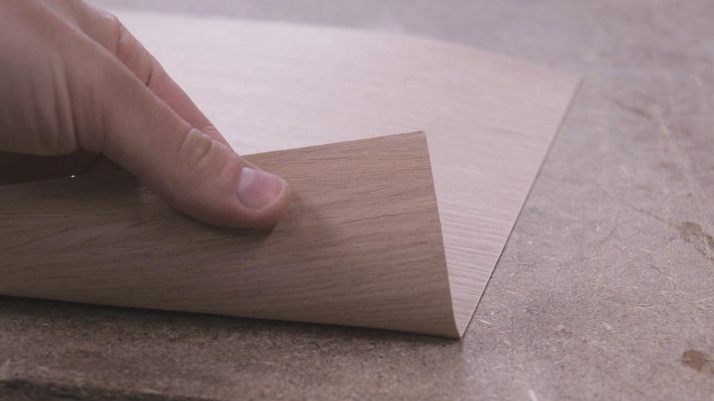

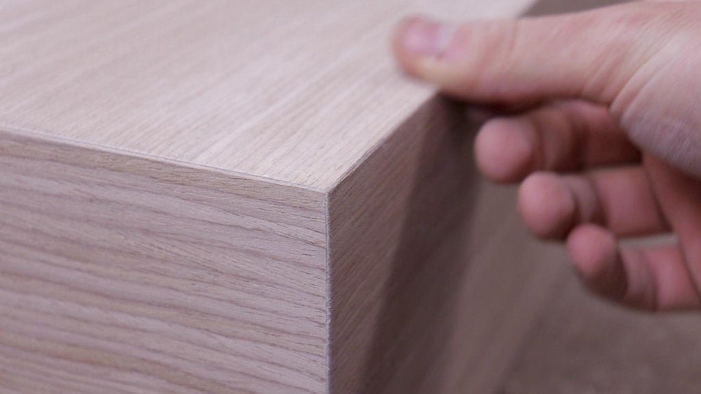

Step 5: Veneering the Enclosure
![](https://content.instructables.com/ORIG/FLE/CC8I/KNQ1E2LK/FLECC8IKNQ1E2LK.jpg?auto=webp&frame=1&width=1024&height=1024&fit=bounds)
![](https://content.instructables.com/ORIG/F5E/KXZX/KNQ1E2LL/F5EKXZXKNQ1E2LL.jpg?auto=webp&frame=1&width=1024&height=1024&fit=bounds)
![](https://content.instructables.com/ORIG/F0U/W4GC/KNQ1E2LO/F0UW4GCKNQ1E2LO.jpg?auto=webp&frame=1&width=1024&height=1024&fit=bounds)
![](https://content.instructables.com/ORIG/FEY/N2ZH/KNQ1E2LQ/FEYN2ZHKNQ1E2LQ.jpg?auto=webp&frame=1&width=1024&height=1024&fit=bounds)
![](https://content.instructables.com/ORIG/FHQ/25I4/KNQ1E2LT/FHQ25I4KNQ1E2LT.jpg?auto=webp&frame=1&width=1024&height=1024&fit=bounds)
![](https://content.instructables.com/ORIG/FGT/V5Q6/KNQ1E2LU/FGTV5Q6KNQ1E2LU.jpg?auto=webp&frame=1&width=1024&height=1024&fit=bounds)
![](https://content.instructables.com/ORIG/FPS/S233/KNQ1E2LW/FPSS233KNQ1E2LW.jpg?auto=webp&frame=1&width=1024&height=1024&fit=bounds)
![](https://content.instructables.com/ORIG/F3E/9QO7/KNQ1E2LG/F3E9QO7KNQ1E2LG.jpg?auto=webp&frame=1&width=1024&height=1024&fit=bounds)
![](https://content.instructables.com/ORIG/FOE/MK82/KNQ1E2LJ/FOEMK82KNQ1E2LJ.jpg?auto=webp&frame=1&width=1024&height=1024&fit=bounds)

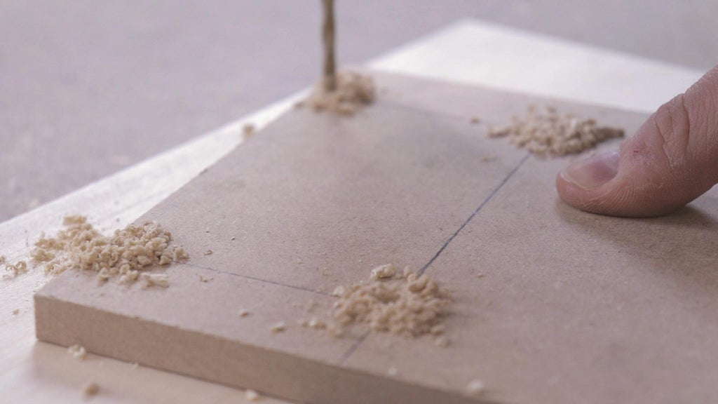

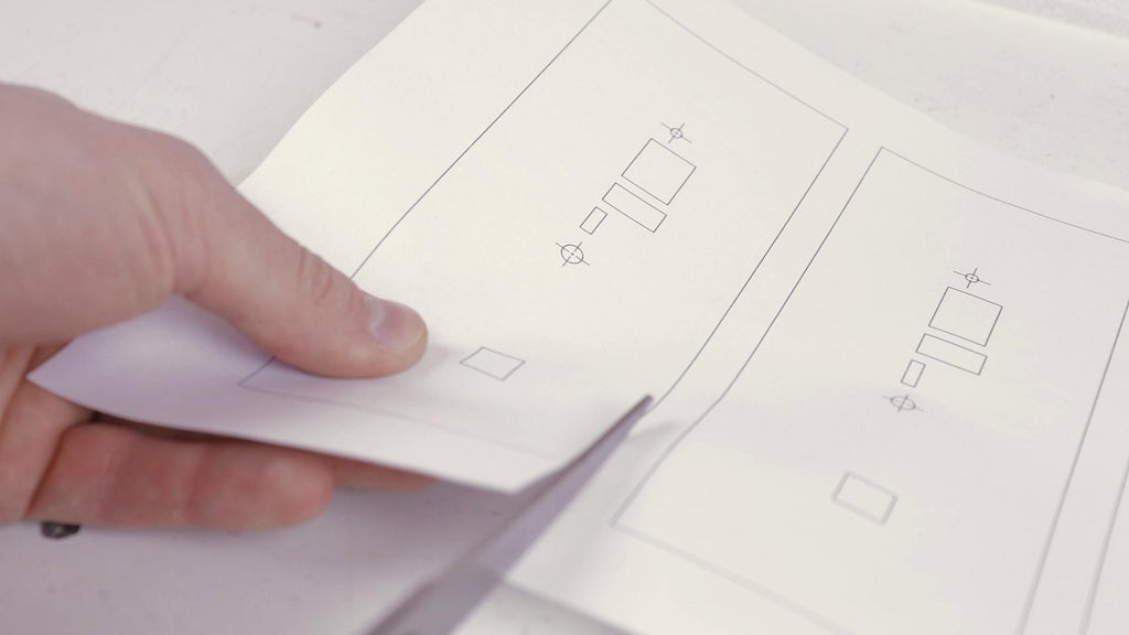

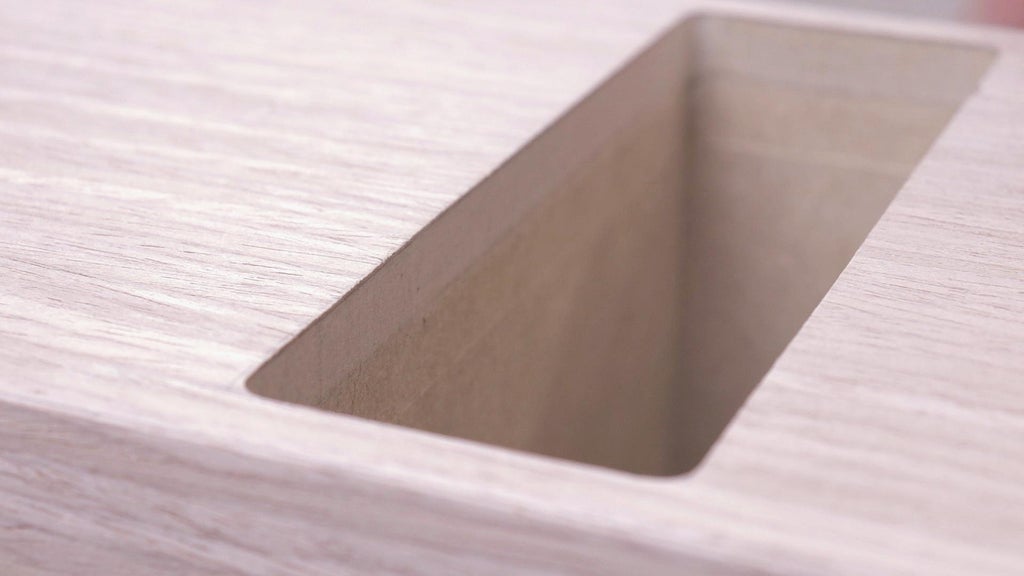

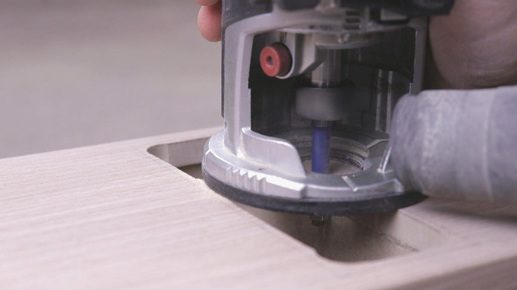

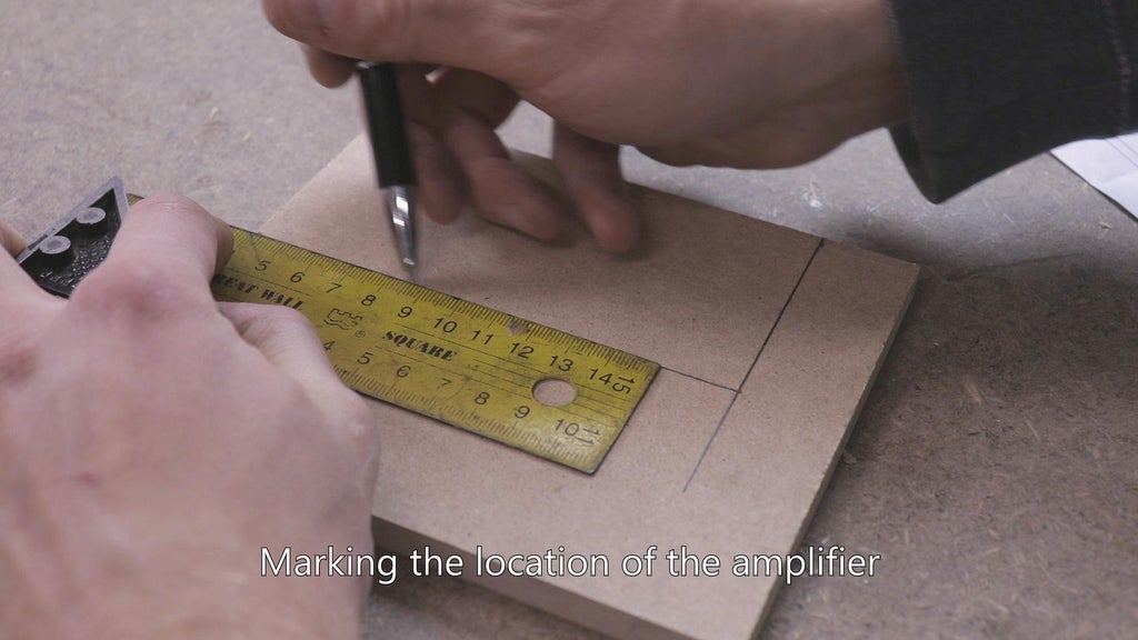

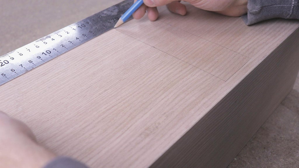

Step 6: Routing the Back Panel

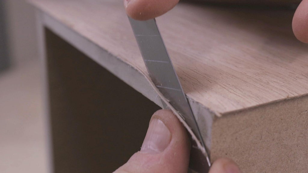

Once I had the veneer applied to all sides of the enclosure, I marked the location of the amplifier location and using a forstner bit, drilled out a hole in each side of the rectangle.

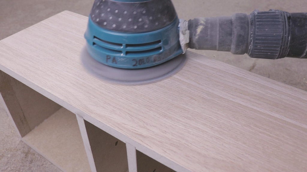

Step 7: Finishing the Enclosure
Probably the most satisfying part of any woodworking project is applying finish to your work. Before applying a coat of it, I quickly sanded it down using an orbital sander to have a nice finish.

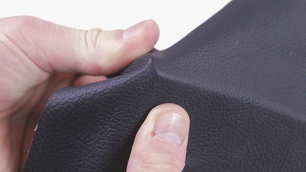

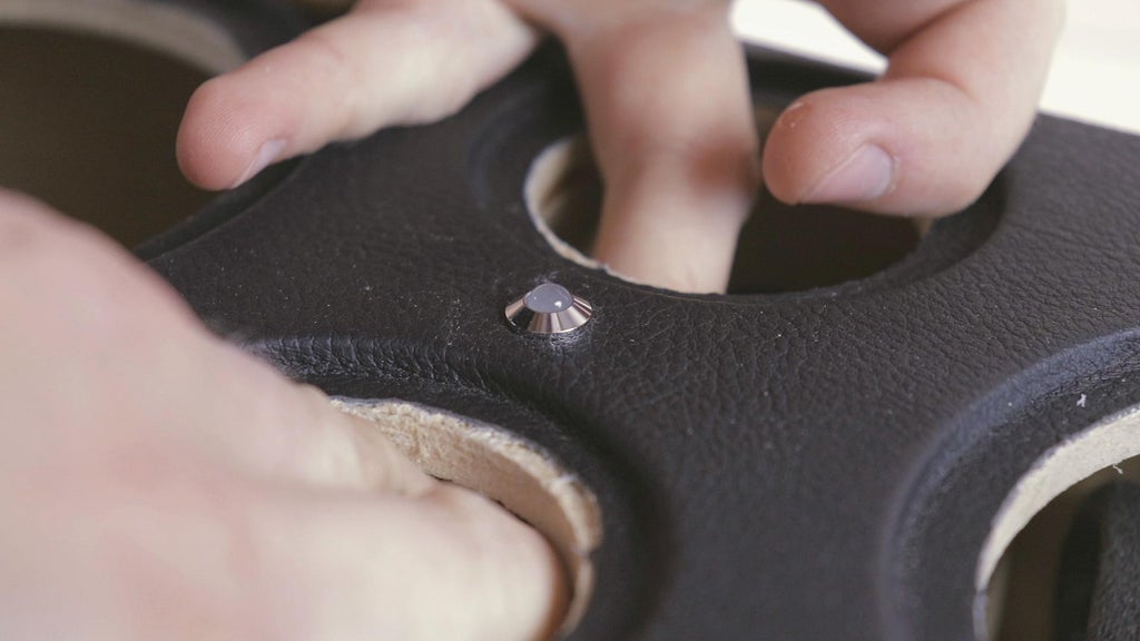

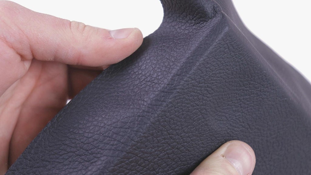

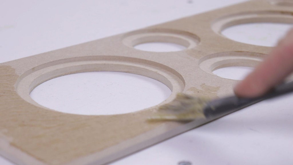

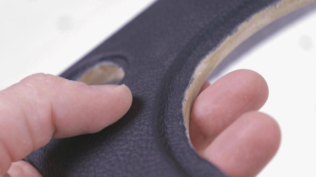

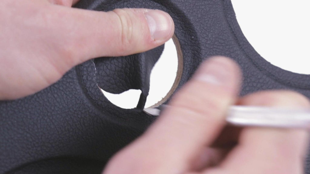

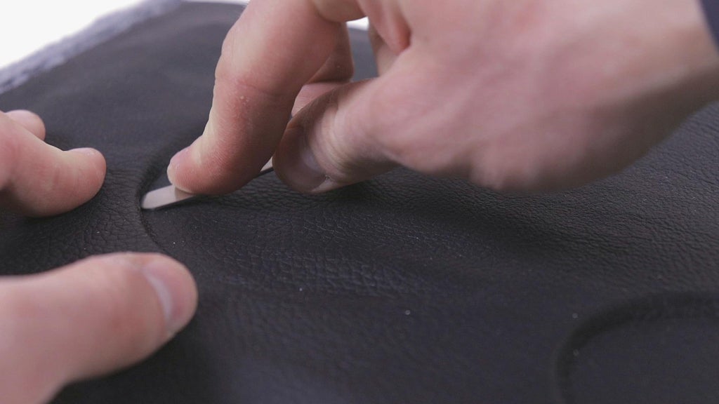

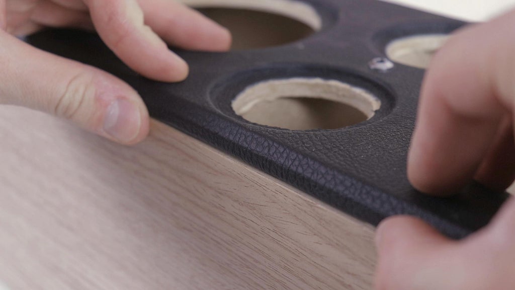

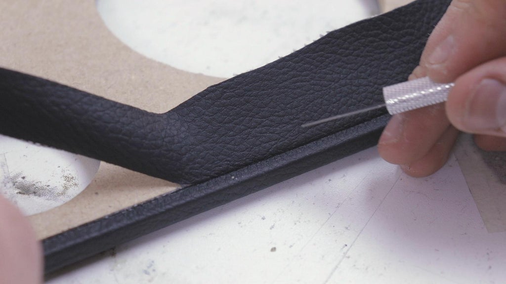

Step 8: Wrapping the Front Panel

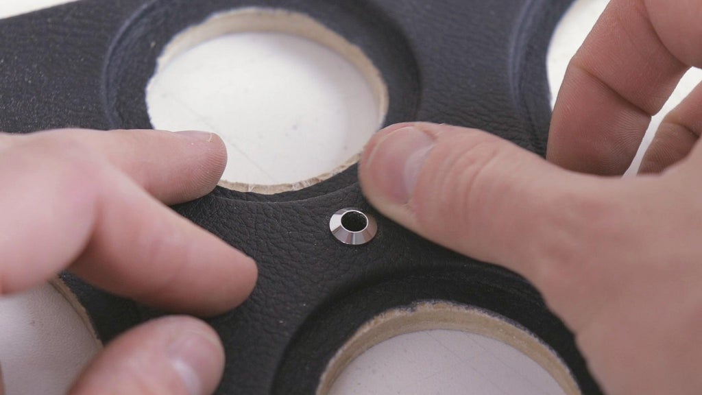

To wrap the front panel in faux leather, I coated both surfaces - the front panel and the faux leather in contact cement. Once the glue was tacky to the touch, I joined the two surfaces together and pressed the leather against every edge of the panel.
![](https://content.instructables.com/ORIG/FIT/HEQO/KNQ1E6G3/FITHEQOKNQ1E6G3.jpg?auto=webp&frame=1&width=1024&height=1024&fit=bounds)
![](https://content.instructables.com/ORIG/F8N/5YXG/KNQ1E6G4/F8N5YXGKNQ1E6G4.jpg?auto=webp&frame=1&width=1024&height=1024&fit=bounds)
![](https://content.instructables.com/ORIG/FYT/O9A2/KNQ1E6G5/FYTO9A2KNQ1E6G5.jpg?auto=webp&frame=1&width=1024&height=1024&fit=bounds)
![](https://content.instructables.com/ORIG/F7W/LRUN/KNQ1E6FX/F7WLRUNKNQ1E6FX.jpg?auto=webp&frame=1&width=1024&height=1024&fit=bounds)
![](https://content.instructables.com/ORIG/FJF/FE28/KNQ1E6FY/FJFFE28KNQ1E6FY.jpg?auto=webp&frame=1&width=1024&height=1024&fit=bounds)
![](https://content.instructables.com/ORIG/FQU/CQHD/KNQ1E6FZ/FQUCQHDKNQ1E6FZ.jpg?auto=webp&frame=1&width=1024&height=1024&fit=bounds)
![](https://content.instructables.com/ORIG/FYL/9GPZ/KNQ1E6G0/FYL9GPZKNQ1E6G0.jpg?auto=webp&frame=1&width=1024&height=1024&fit=bounds)
![](https://content.instructables.com/ORIG/F0B/LASL/KNQ1E6G1/F0BLASLKNQ1E6G1.jpg?auto=webp&frame=1&width=1024&height=1024&fit=bounds)
![](https://content.instructables.com/ORIG/FP8/8WU1/KNQ1E6G2/FP88WU1KNQ1E6G2.jpg?auto=webp&frame=1&width=1024&height=1024&fit=bounds)

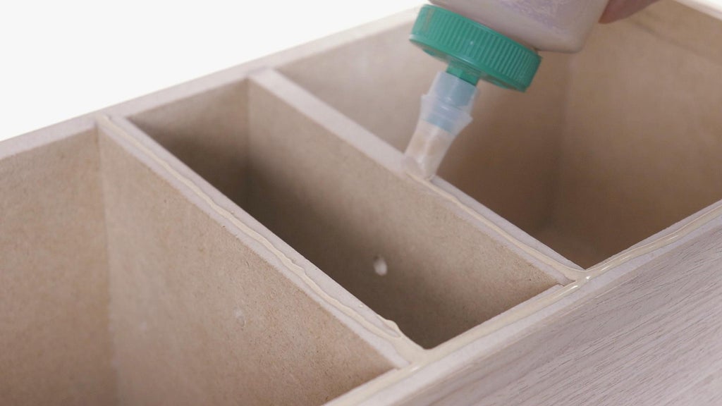

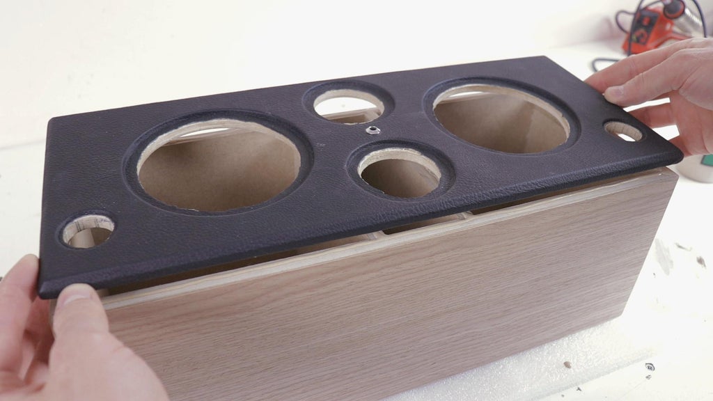

Step 9: Gluing the Front Panel
I applied a good amount of glue around the edges of the enclosure and pressed the front panel in place making sure the edges align perfectly.

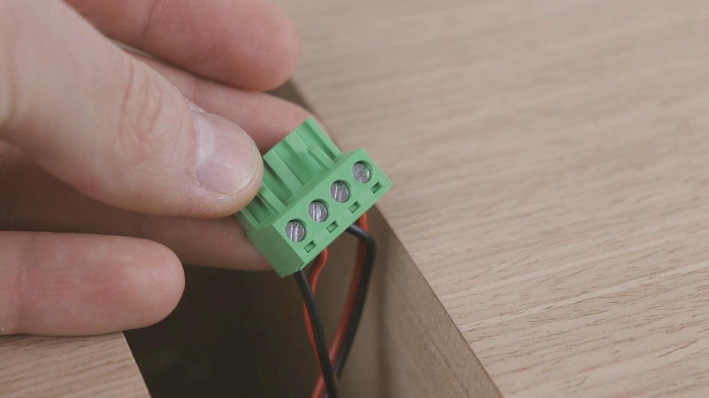

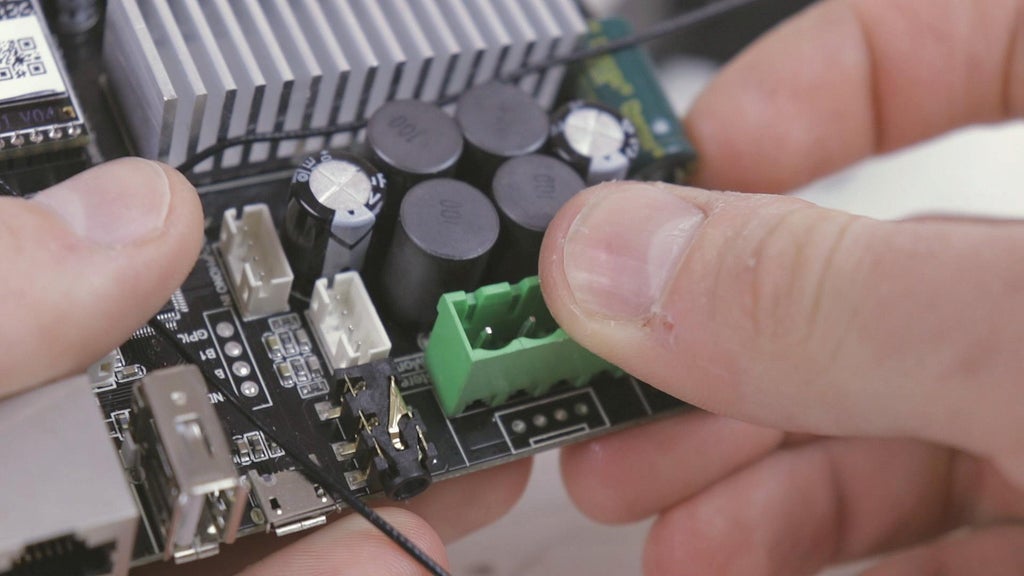

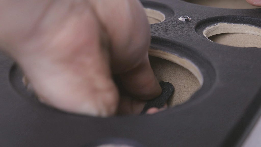

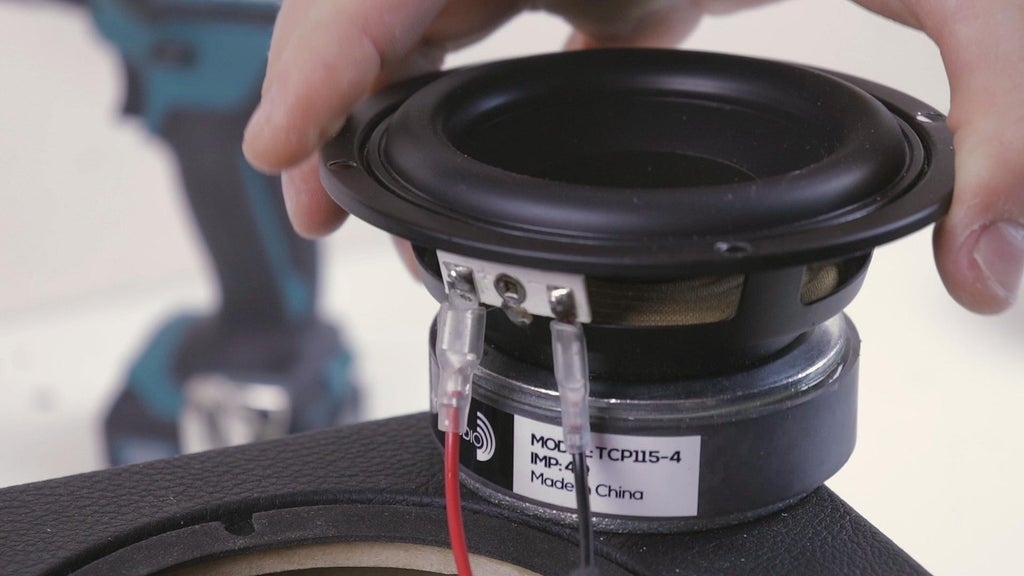

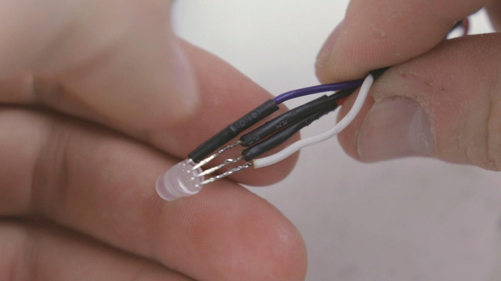

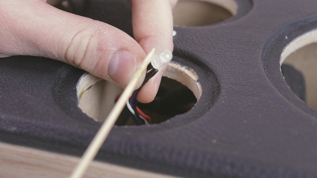

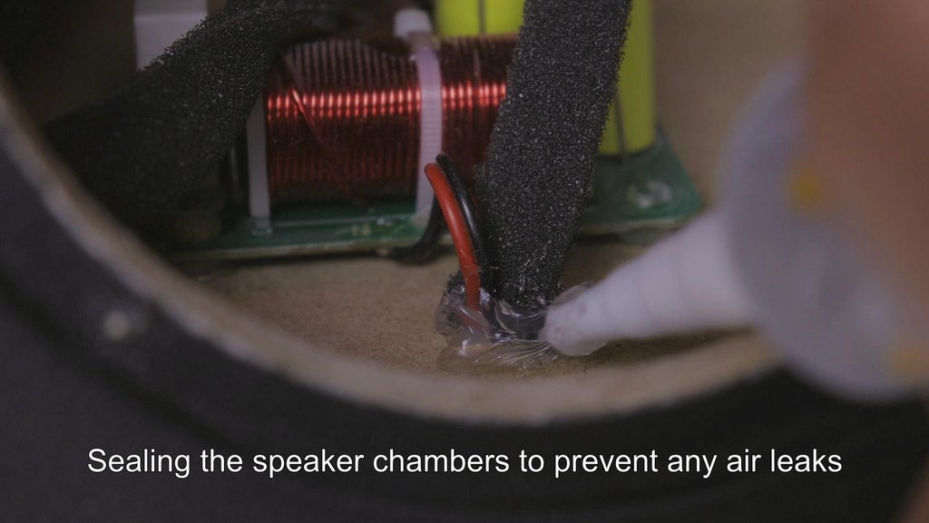

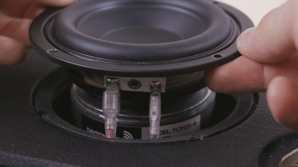

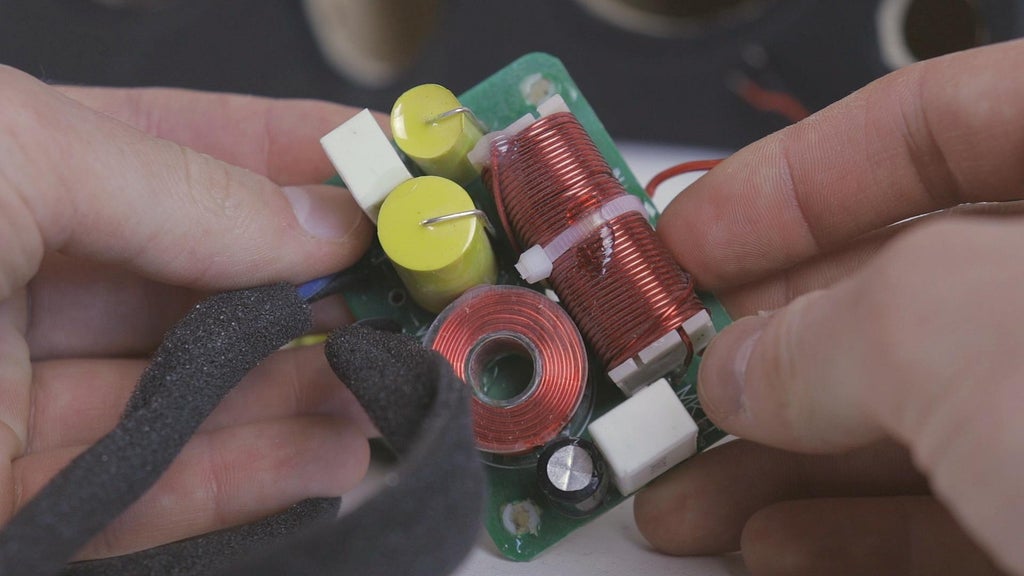

Step 10: Installing the Electronics

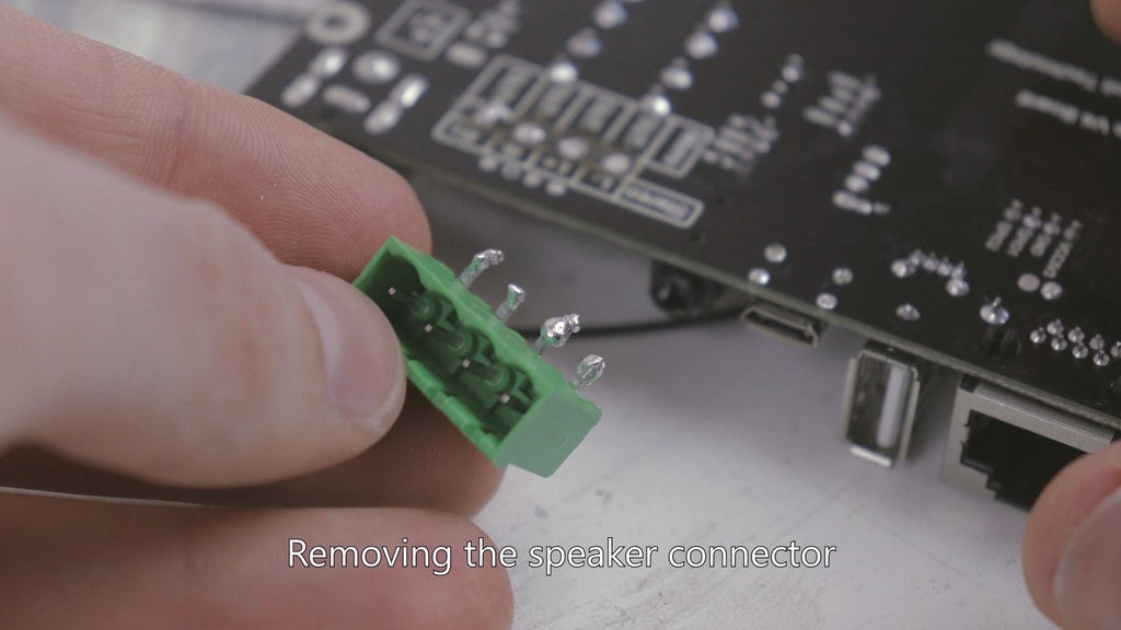

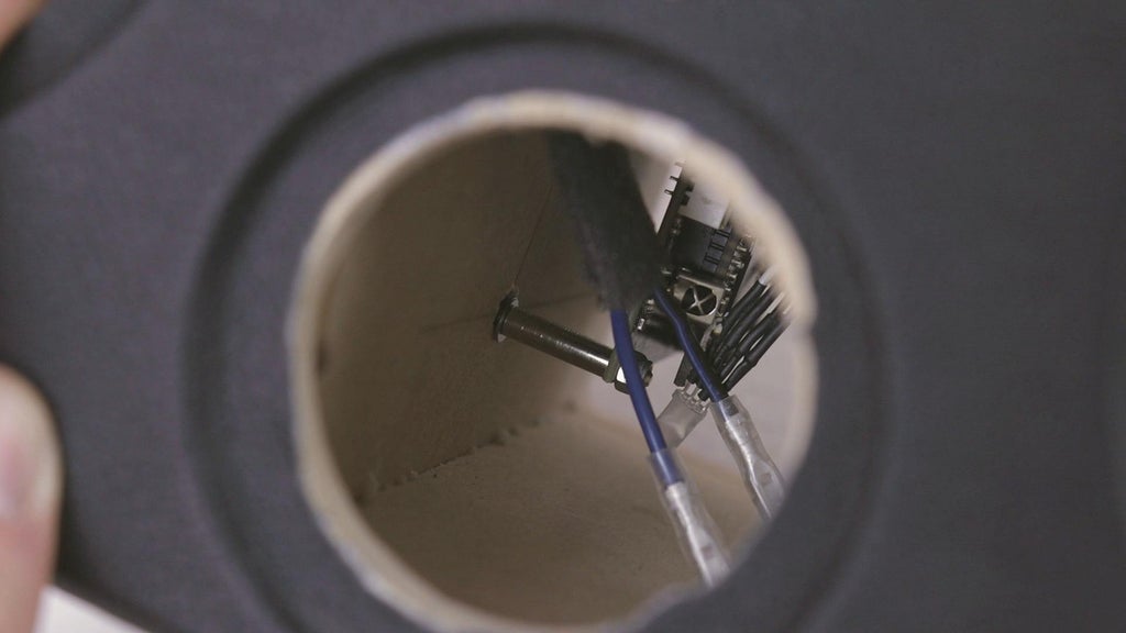

Now we can install the crossovers inside each speaker chamber and route the input and tweeter cables through the hole of the side panels.
![](https://content.instructables.com/ORIG/F72/TG9T/KNRGT783/F72TG9TKNRGT783.jpg?auto=webp&frame=1&width=1024&height=1024&fit=bounds)
![](https://content.instructables.com/ORIG/FWK/S3Z2/KNRGT784/FWKS3Z2KNRGT784.jpg?auto=webp&frame=1&width=1024&height=1024&fit=bounds)
![](https://content.instructables.com/ORIG/FR3/B6G8/KNRGT786/FR3B6G8KNRGT786.jpg?auto=webp&frame=1&width=1024&height=1024&fit=bounds)
![](https://content.instructables.com/ORIG/FU4/806Q/KNRGT77A/FU4806QKNRGT77A.jpg?auto=webp&frame=1&width=1024&height=1024&fit=bounds)
![](https://content.instructables.com/ORIG/FEZ/T2CD/KNRGT77B/FEZT2CDKNRGT77B.jpg?auto=webp&frame=1&width=1024&height=1024&fit=bounds)
![](https://content.instructables.com/ORIG/FNQ/RAOI/KNRGT77C/FNQRAOIKNRGT77C.jpg?auto=webp&frame=1&width=1024&height=1024&fit=bounds)
![](https://content.instructables.com/ORIG/FGV/WTOX/KNRGT77E/FGVWTOXKNRGT77E.jpg?auto=webp&frame=1&width=1024&height=1024&fit=bounds)
![](https://content.instructables.com/ORIG/F82/LO8B/KNRGT781/F82LO8BKNRGT781.jpg?auto=webp&frame=1&width=1024&height=1024&fit=bounds)
![](https://content.instructables.com/ORIG/FJ3/0O5W/KNRGT782/FJ30O5WKNRGT782.jpg?auto=webp&frame=1&width=1024&height=1024&fit=bounds)

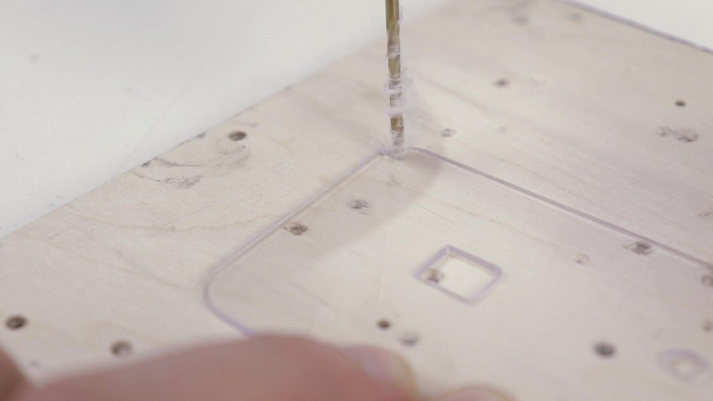

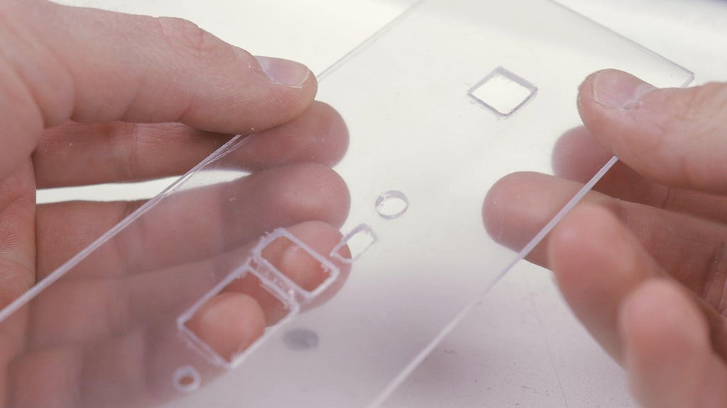

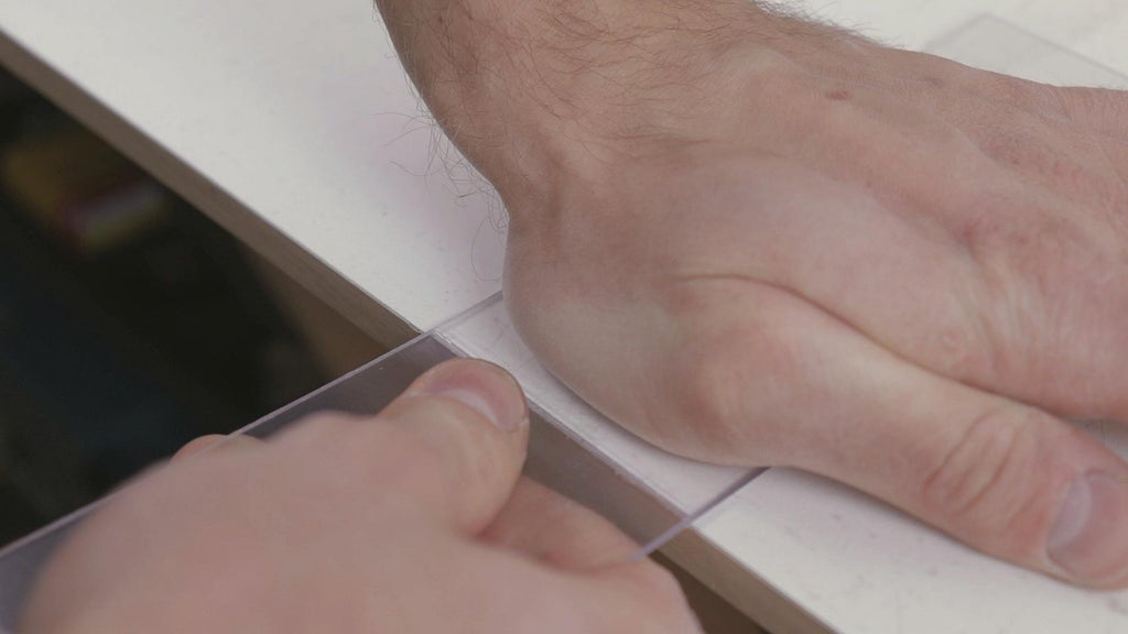

Step 11: Making the Amplifier Cover
![](https://content.instructables.com/ORIG/FFG/8TCB/KNRGTHEZ/FFG8TCBKNRGTHEZ.jpg?auto=webp&frame=1&width=1024&height=1024&fit=bounds)
![](https://content.instructables.com/ORIG/FJJ/3NFN/KNRGTHC8/FJJ3NFNKNRGTHC8.jpg?auto=webp&frame=1&width=1024&height=1024&fit=bounds)
![](https://content.instructables.com/ORIG/FTE/50PM/KNRGTHC9/FTE50PMKNRGTHC9.jpg?auto=webp&frame=1&width=1024&height=1024&fit=bounds)
![](https://content.instructables.com/ORIG/F2A/MTZT/KNRGTHCA/F2AMTZTKNRGTHCA.jpg?auto=webp&frame=1&width=1024&height=1024&fit=bounds)
![](https://content.instructables.com/ORIG/FGR/ZFKI/KNRGTHCB/FGRZFKIKNRGTHCB.jpg?auto=webp&frame=1&width=1024&height=1024&fit=bounds)
![](https://content.instructables.com/ORIG/FTV/44H1/KNRGTHCD/FTV44H1KNRGTHCD.jpg?auto=webp&frame=1&width=1024&height=1024&fit=bounds)
![](https://content.instructables.com/ORIG/FF6/7X0B/KNRGTHCF/FF67X0BKNRGTHCF.jpg?auto=webp&frame=1&width=1024&height=1024&fit=bounds)

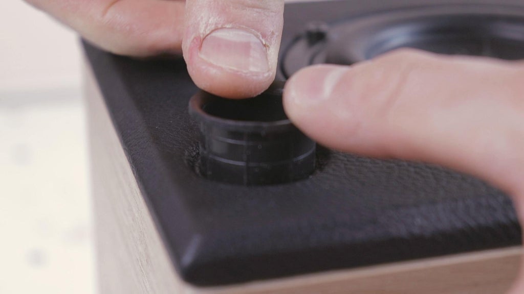

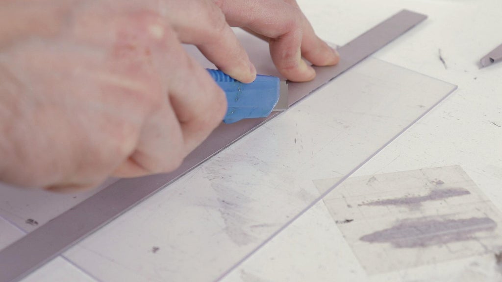

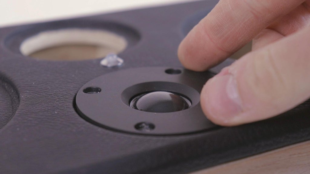

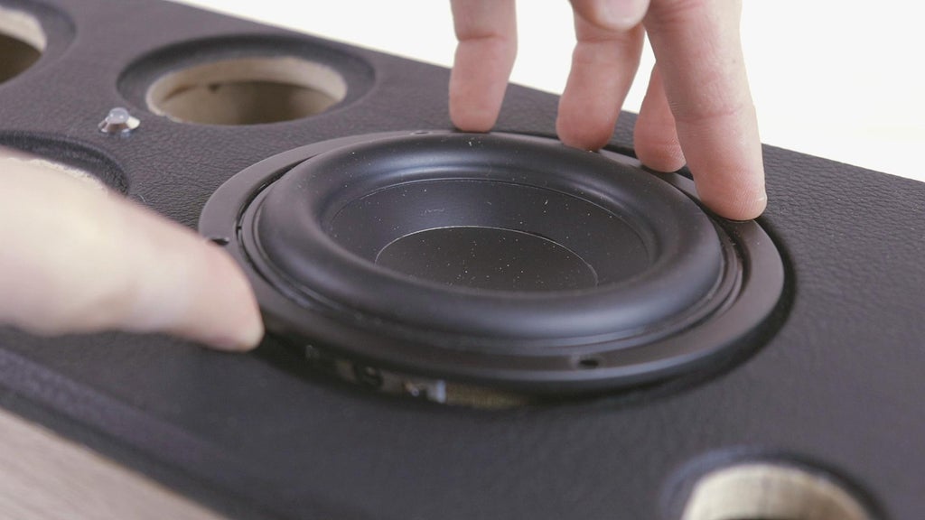

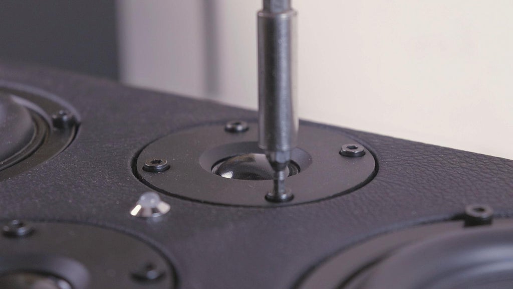

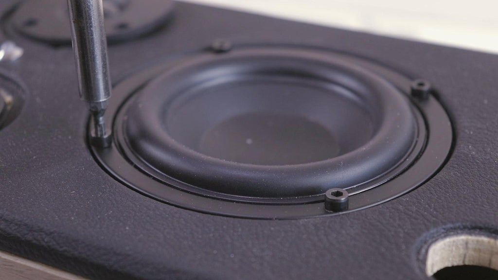

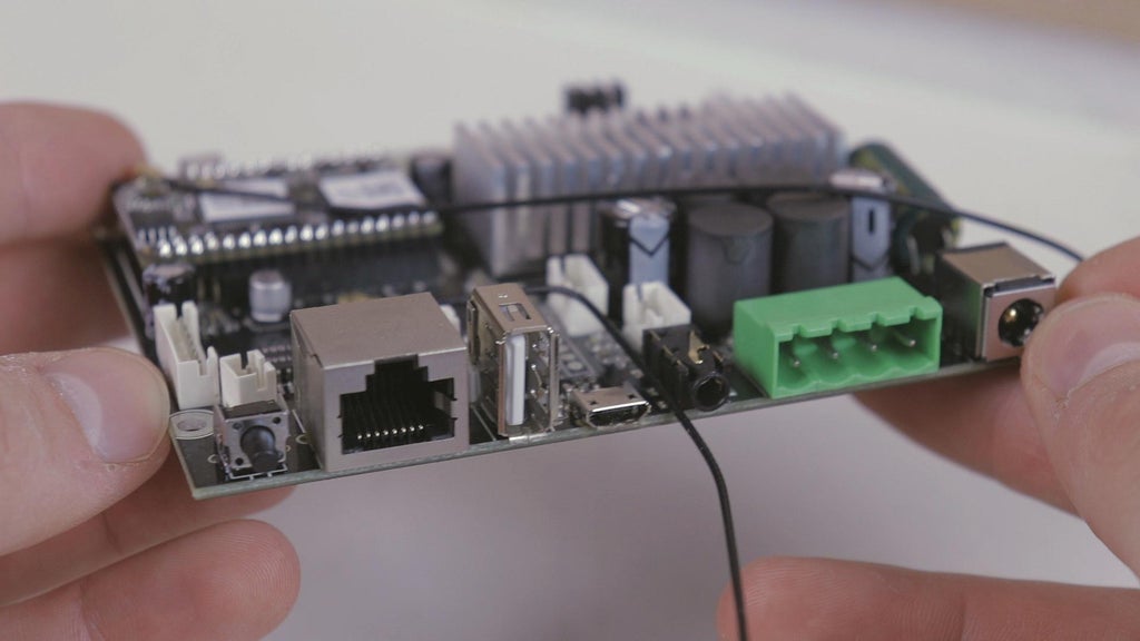

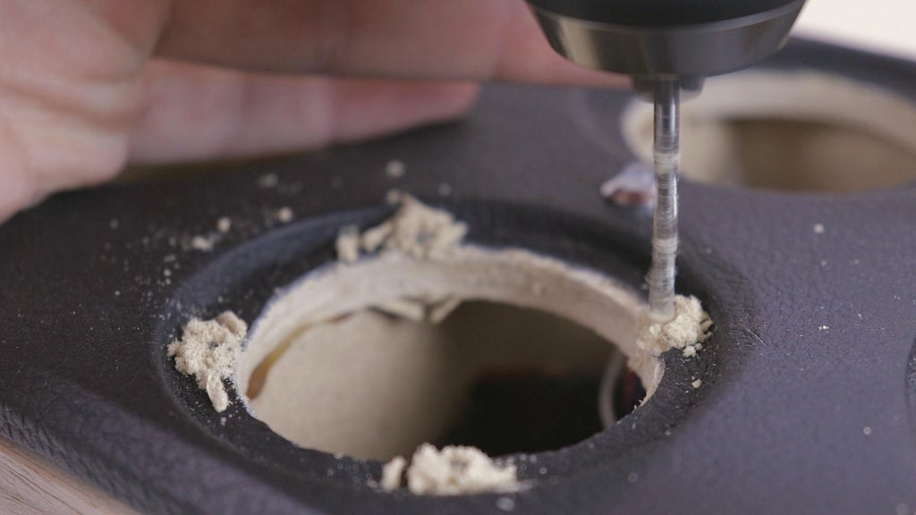

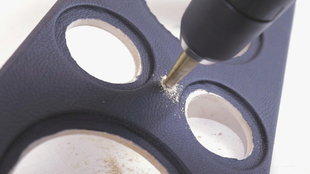

Step 12: Installing the Components

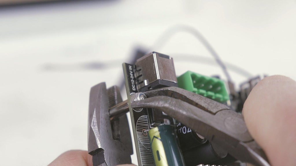

Now that I had the clear panel fabricated, I drilled out the screw holes, attached the two antennas of the amplifier and screwed the clear panel in place. I then followed by gluing in the amplifier's indicator LED.
![](https://content.instructables.com/ORIG/FGA/DDNT/KNRGTL07/FGADDNTKNRGTL07.jpg?auto=webp&frame=1&width=1024&height=1024&fit=bounds)
![](https://content.instructables.com/ORIG/F5X/OL80/KNRGTL09/F5XOL80KNRGTL09.jpg?auto=webp&frame=1&width=1024&height=1024&fit=bounds)
![](https://content.instructables.com/ORIG/FXS/VFYL/KNRGTL0L/FXSVFYLKNRGTL0L.jpg?auto=webp&frame=1&width=1024&height=1024&fit=bounds)
![](https://content.instructables.com/ORIG/F4D/G7BI/KNRGTL0M/F4DG7BIKNRGTL0M.jpg?auto=webp&frame=1&width=1024&height=1024&fit=bounds)
![](https://content.instructables.com/ORIG/FXK/HWTW/KNRGTL0N/FXKHWTWKNRGTL0N.jpg?auto=webp&frame=1&width=1024&height=1024&fit=bounds)
![](https://content.instructables.com/ORIG/FCV/TA7H/KNRGTL0O/FCVTA7HKNRGTL0O.jpg?auto=webp&frame=1&width=1024&height=1024&fit=bounds)
![](https://content.instructables.com/ORIG/FVS/N3HJ/KNRGTL0R/FVSN3HJKNRGTL0R.jpg?auto=webp&frame=1&width=1024&height=1024&fit=bounds)
![](https://content.instructables.com/ORIG/FRR/J00G/KNRGTL0S/FRRJ00GKNRGTL0S.jpg?auto=webp&frame=1&width=1024&height=1024&fit=bounds)
![](https://content.instructables.com/ORIG/FSW/E7J6/KNRGTL0T/FSWE7J6KNRGTL0T.jpg?auto=webp&frame=1&width=1024&height=1024&fit=bounds)
![](https://content.instructables.com/ORIG/FDA/MRTR/KNRGTL0U/FDAMRTRKNRGTL0U.jpg?auto=webp&frame=1&width=1024&height=1024&fit=bounds)
![](https://content.instructables.com/ORIG/F2C/24D0/KNRGTL15/F2C24D0KNRGTL15.jpg?auto=webp&frame=1&width=1024&height=1024&fit=bounds)
![](https://content.instructables.com/ORIG/FCF/UMO3/KNRGTL16/FCFUMO3KNRGTL16.jpg?auto=webp&frame=1&width=1024&height=1024&fit=bounds)
![](https://content.instructables.com/ORIG/F1G/1O7Q/KNRGTL17/F1G1O7QKNRGTL17.jpg?auto=webp&frame=1&width=1024&height=1024&fit=bounds)
![](https://content.instructables.com/ORIG/FZB/826D/KNRGTL18/FZB826DKNRGTL18.jpg?auto=webp&frame=1&width=1024&height=1024&fit=bounds)

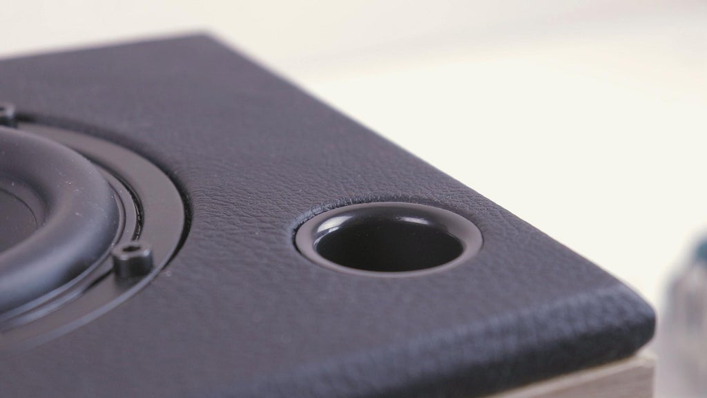

Step 13: Last Touches!
To finish the speaker I glued 4 rubber feet on each corner of the speaker.
All set and ready to test!
