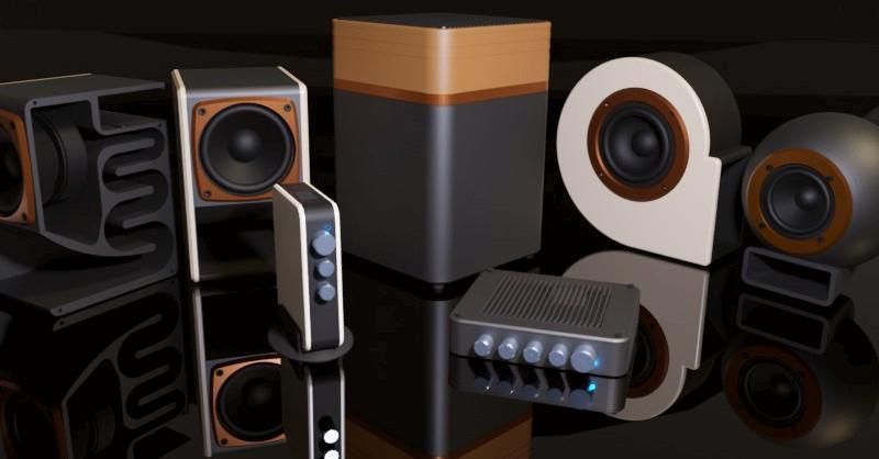

Introduction: 2.1 Bluetooth Sound System - Fully Printable
Strictly speaking, fully printable is a slight exaggeration. To be honest, I am still struggling with printing PCBs (although this would be reeeeally nice), drivers, and a few electronic components... ;D No, seriously, all you need in addition to the printed enclosures is a small amplifier board (and power adapter), the speaker drivers, cables to connect all this to the amplifier, and a few screws. All in all this should be a very economical project. All parts print on an 18x18 cm printer bed, assembly is super easy and (virtually) does not require any soldering or electronics knowledge.
First a little background. So what is a 2.1 sound system? In essence this is a stereo system with an added subwoofer. Stereo, or stereophonic sound is a “method of sound reproduction that creates an illusion of multi-directional audible perspective” (Wikipedia). Stereo sound is recorded by positioning two microphones relative to the source of sound (e.g. music) so that they simulate the experience of listening. They record simultaneously but not he same sound. E.g. the sound of the instrument that is closest to microphone A will reach A before it reaches microphone B and vice versa. Together this creates a stereo record that is similar to the listening experience created by your ears (which are “mounted” to your head, not unlike microphones, so they can distinguish the direction which the sound comes from). When reproducing stereo sound the speakers are positioned in a way that allows these two channels to give you the best feeling of the room the sounds were recorded in.
Now why would you want to add a subwoofer to a stereo system and why only one? The problem is that small drivers / speaker enclosures are not very good at reproducing lower frequencies. So you would need two pretty large stereo speakers (e.g. in a 2-way or 3-way design, which means each speaker has a woofer, a mid range speaker and a tweeter) to reproduce the full range of frequencies in stereo (this would be called a 2.0 system). However, while our ears/brain are pretty good in distinguishing directions in mid and higher frequency ranges, this does not apply to lower frequencies. The good thing is that this means that you don’t actually need stereophonic reproduction of lower frequencies. In fact you only need a single subwoofer for the lower frequencies, which can be placed pretty much anywhere in the room, and two small satellite speakers for the mid and upper ranges placed so that they give the best stereophonic experience (typically front right and left). The separation of the lower frequencies is done by a crossover (in essence a simple filter) e.g. integrated into a 2.1 amplifier that filters out the lower frequencies from both channels and pools them in a single subwoofer channel (this is what the #.1 in 2.1 stands for).

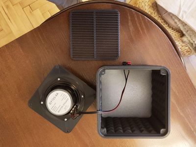

Step 3: The Subwoofer (Isobaric Subwoofer V1.0)
This is a small, fully printable subwoofer, in essence a 3 liter enclosure, which, thanks to the isobaric design, performs like a 6 liter enclosure.
So what is an "isobaric" subwoofer and why would you want to print one? Isobaric speaker design is basically a simple trick to reduce the volume requirements for a speaker enclosure (by approx 50%, so helps overcome the no. 1 limitation of printed speaker designs). What you do is you line up 2 drivers one behind the other to double their ability to compress the air in the enclosure behind. This way the outer driver "thinks" that it has a much greater volume to work with. Isobaric only applies to the space between the two speakers, in which the pressure remains moderately (but not 100%) constant, very much unlike the air in the chamber behind the second driver. If the drivers both point in the same direction they are simply connected in parallel (which reduces their impedance to half), which makes their membranes move in parallel. However, you can also have the membranes point at each other (as I did in this design). This may look a little awkward but works great and helps save additional space. However, in this case you have to invert the phase of one of the drivers, which is simply done by connecting the "+" connector of one of the drivers with the "-" of the second (see wiring diagram). This way you can print a 3 liter enclosure, which to the driver "looks" like a 6 liter enclosure.
Material. Again an ultra economical design (I know that's a little strange but I just love to see what can be done with such basic components and there is always plenty of room for improving by simply upgrading components). The drivers I used were € 5.5/piece for the 4" option and €6.5/piece for the 5" variety! However, even the 5" variety I used is only 25W RMS (which isn't exactly much for a woofer - plus a Qts of 1.15), so they sound good at lower volumes but won't be any good for your next rave party. As usual, the more you are willing to spend on your drivers the more sound you are likely to get. And remember, you will need two of these!
Here is what you will need:
- The drivers I used are ultra cheap Dynavox 50W, 8 Ohm, 13 cm (5") woofers (around € 6.5/piece in EU), which once again may be a little hard to find outside of Europe but pretty much any of these Amazon 5” woofers should fit (compare the mounting holes with the ones in the attached image). I have included a step file for you to adapt the mounting plate to your own drivers if needed. Or if you are willing to spend a little more, e.g. Aiyima has a few 5.25" woofers (that should fit) to choose from.
- I use these speaker terminal connectors (around € 0.5/5 pieces) but they are basically optional.
- Plus a few M3 screws
Remember, you can use pretty much any woofers as long as they have roughly the same diameter (up to 5.25" should be OK - see image above for diameters and I have included the .step file for you to adapt to your needs). The better the driver, the better the sound you will get.
Printing and Assembly. This should be a simple (although slightly longish) print. No supports or attachments needed. Print in PLA (or ABS, PETG...) at 0.28 mm resolution and 20%+ infill.
- Once again I print the main body some ultra cheap, easy to print carbon fiber PLA (on Amazon Sunlu Carbon Fiber PLA), which gives this beautiful surface, but of course any PLA, ABS, PETG/color will do. - The upper section is printed in wood PLA (on Amazon Sunlu Wood PLA) looks great (much better than in the pictures) together with the carbon and silk copper,
- used for the connecting ring: silk copper/bronze PLA.
Print one part each of the main body, the speaker mount, the 10 mm connecting ring (which is mainly there to make it easy to adjust to the size of the driver - see below) and the 55 mm top section, plus the grille as well as 4 pieces of the feet (these preferably in TPU but PLA will do). I have included the speaker mount plate for 100 mm, 130 mm, and for 5.25". I have also included a step file for you to be able to adjust to the exact size of your drivers. In case your driver is higher than the 60 mm (10+55-5 mm) top section (which is not unlikely), simply scale the z-axis (only) of the 10 mm ring (this is the golden section between the lower and upper parts) in the images) to whatever size you need (e.g. in Cura).
Wiring and Assembly. Wiring is really simple. However, - this is important - you have to invert the phase of one of the drivers, which is simply done by connecting the "+" connector of one of the drivers with the "-" of the second (see wiring diagram). Mount the 2 drivers (membranes pointing at each other) with 4 M3 screws/nuts to the speaker mount (make sure they are not touching). Connect the lower driver to the terminal connector. Add damping material to the main chamber (optional but suggested). Insert the mounting plate with the two drivers. Insert the grille and connect to the amplifier (see below).

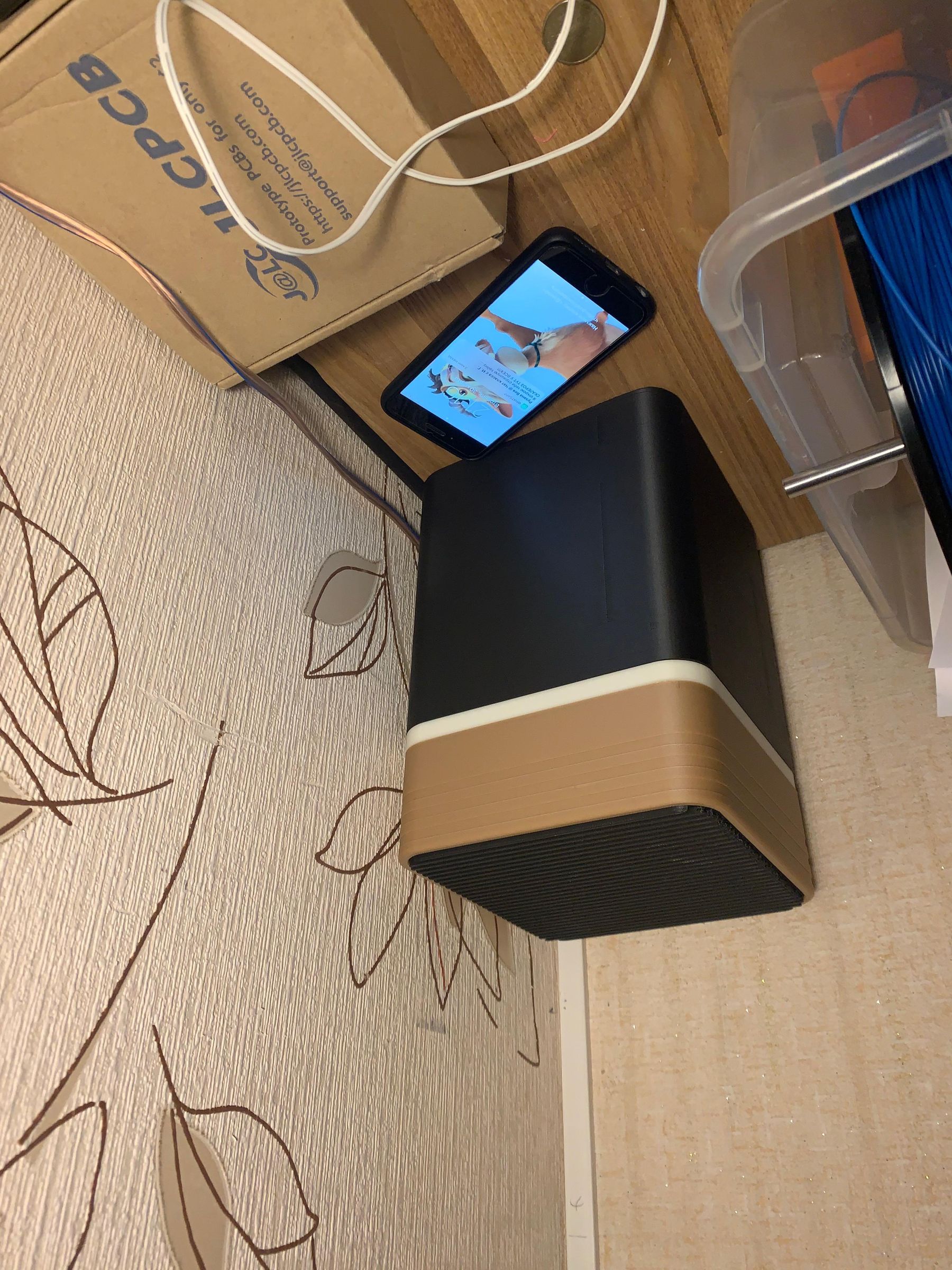

I love this, very well done, love the different use of print material too! with the subwoofer is the iso enclosured tuned to a certain frequency based on the TS params of the woofers?

I actually had to adjust the Y axis to 103% to get the board I bought on Amazon to fit, even though it looked identical to the one from Aliexpress.
