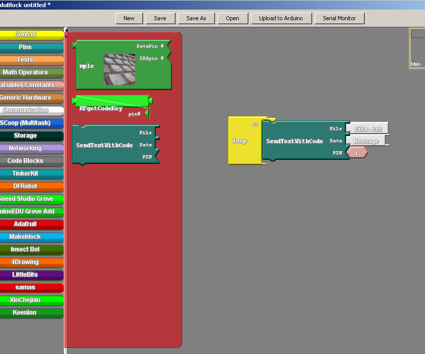

Open dos command go to C:\ARDUBLOCK and type javac Partie_Emetteur.java . Convert java to class
close dos command and open ce2.23 class editor
Load the new file Partie_Emetteur.class from C:\ARDUBLOCK\Partie_Emetteur.CLASS
Modify on (up and right) button
In square version and under MAGIC NUMBER there is "Major Version 51" CHANGE to "Major Version 49"
In square Property Change "Accept" push button . SAVE and exit.
Push back the new class file to ardublock.jar
Finished the second way (correct way).
