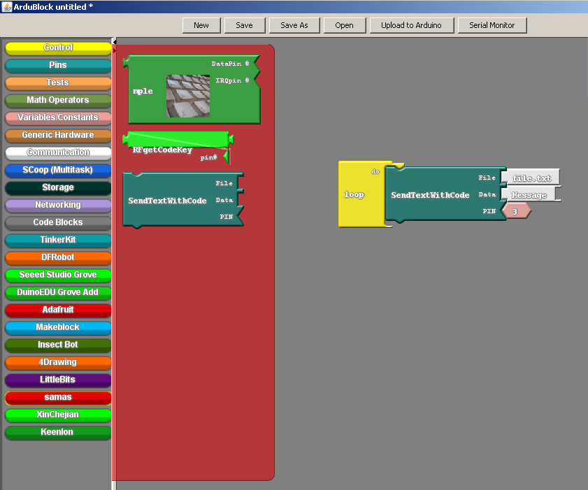

Let's make one block and connect it to ardublock.
Write code as seen in the picture inside ardublock in field BlockGenues
In the same file(ardublock.xml) in field BlockDrawer we must make statement :
Write code as seen in the picture.
(I wrote here the code but "instructuble" does not accept some symbols and deletes my code. )
Open ardublock.properties and write in last line :
bg.myblock1=command block
bg.myblock2=data block
Save and drag and drop both files in ardublock\com\ardublock\block
Open arduino ardublog
Congrats , you've just made your first 2 basics blocks.
Basically we use 2 two types of blocks "commad" and "data"
tip : -- sam --> is label with ctrl+f (quick find) you can jump from one flag to other.
change code for "data block" as you see in the picture. Result in picture .
connector-type="poly" means that , this block is connect everywhere.
There is few types connection .Search the ardublock.xml and you unterstand what i mean .
Its not nessesery to write code from picture .Best way is to copy and past from other inside ardublock.xml.

Open ardublock.xml with notepad++ . Find "myblock2" (with ctrl+f) and delete some code as seen in the picture .
Let's put a photo inside block
Create two folder in ardublock
1.Create in ardublock.jar\com\ardublock\translator\block new folder name " myblocks " (it's for class files )
2.Create in ardublock.jar\com\ardublock\block new folder name " myblocks " (it's for photo files )
Write in google MPU6050 and go to picture copy photo of chips and paste in painter .
Drag and drop photo 6050.png in ardublock.jar\com\ardublock\block\myblocks
(in ardublock change 6050.PNG to 6050.png it's different )
Open ardublock.xml with notepad++ and write as seen in picture (or make copy paste from others).
Save it (last time) .Drag and drop ardublock.xml to ardublock.jar\com\ardublock\block.
Open ardublock.properties and change:
bg.myblock2=data block to bg.myblock2=MPU6050_X. save it and back to ardublock.jar
Open ardublock .See the result .
