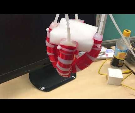

In my previous tutorial I made "3-DOF Gripper Manually Controlled by Joystick", this is just the upgraded version of that system in this tutorial instead of controlling that system manually I'm going to use computer vision technique to control the gripper.
