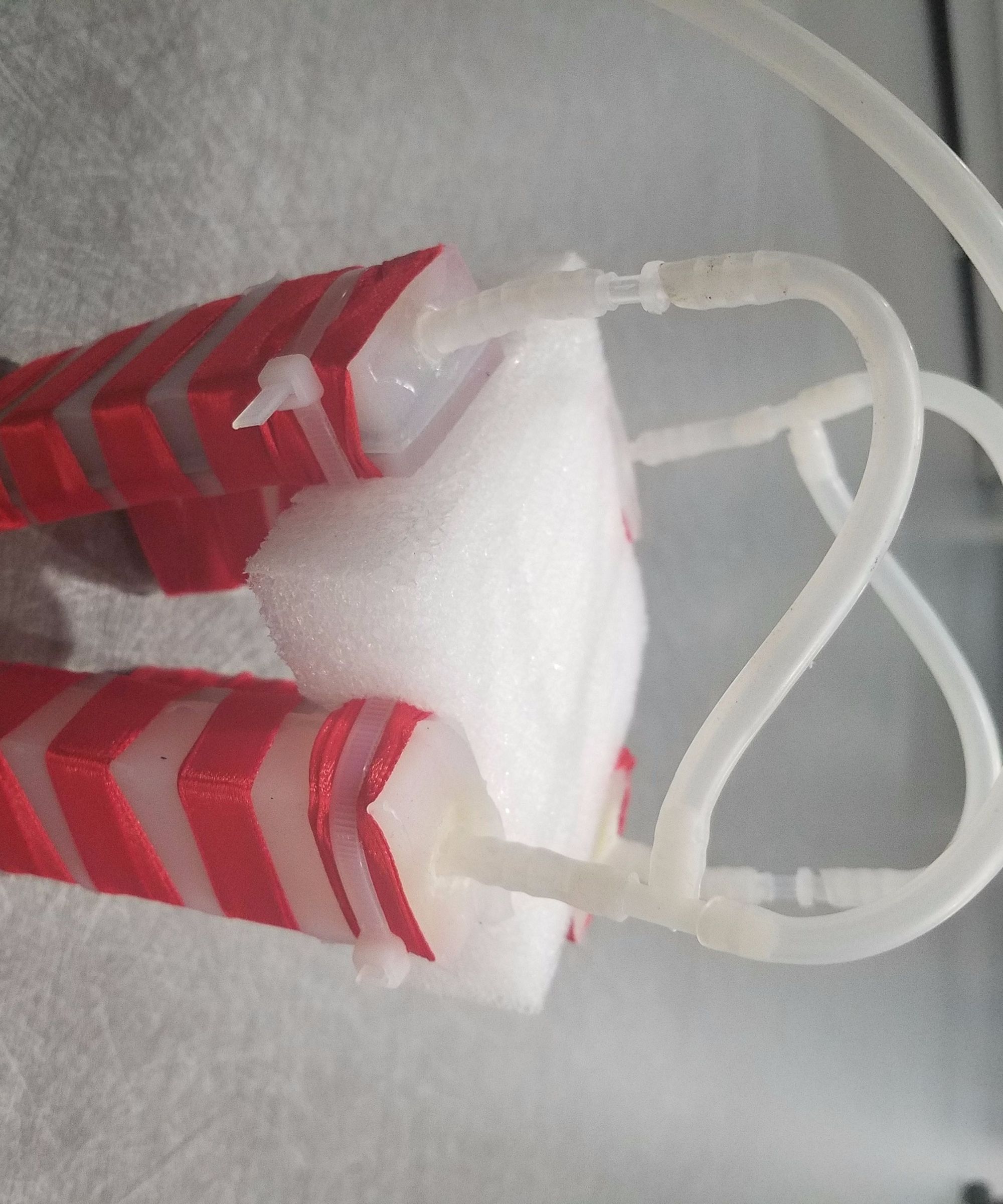

Step 17: Connection Between Gripper, Pump and Valve
Take three-way silicone connector and attach one end with the gripper and other two ends with the pump and valve respectively, as shown in the figure.
WORKING:
The purpose of the pump is two inflate the gripper but its really inconvenientif i have to release the air from the gripper manually, so to avoid that i have used valve. During inflation the valve will remain close and when we want to release the air from the gripper we can simply use the valve for that purpose.

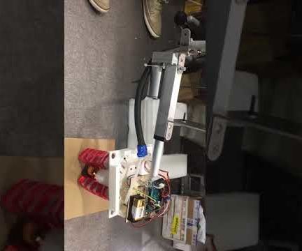

Step 19: Final Look
In the uploaded video i haven't use the valve, but i have tasted it with vlave and it works fine.
In the next tutorial i will move this gripper in a 3 dimensional space using three linear motors.
