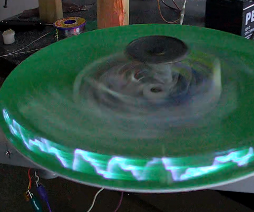

Step 1: Theory of Operation
Laser beam leaves the laser tube does a 90' turn downwards, then 90' sideways into the center of the wooden cabinet, then directly in the center of the drive shaft tube another mirror sends the beam upwards to the final mirror mounted on the stepper. The beam is focused on a "target" screen attached on the rim of the plate.
The circuit to drive the stepper is relatively simple, all the coils of the stepper are wired in series / with a center tap. One leg of the stepper goes to +5v, the opposite leg to ground and finally the center tap gets the audio amp output.
Spinning the turntable in a CCW direction will generate the "horizontal" axis "X"
Stepper motor/ mirror will generate "amplitude" axis or "Y".

Next you can see the laser beam exiting the laser tube, doing a 90' downward change, then just below that another 90' horizontal change before entering the center of the cabinet ( see my hand with red dot).
