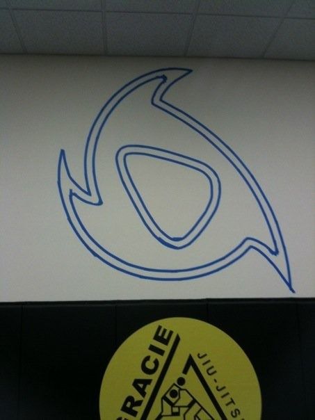

This was a foam core fiber glass logo for my Brazilian Jiu-Jitsu instructor a few years back. I started out by glueing to pieces of foam, tracing his logo and cutting it out. I know I don't have all the steps it took I apologize, but very simple :).
