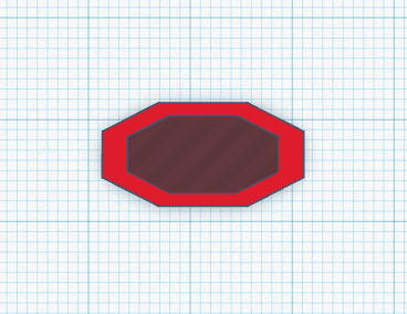

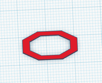

- Add a square shape to the workplane and resize it to the size you want for your chain - I started at 20x20x1.5mm but I tried out a few different shapes and sizes as you can see above so play around and see what you like best!
- Rotate your square by 45 degrees then, using 4 square shaped holes, cut off the corners of your original square and group all 5 shapes to form an octagonal shape
- I then decided to squash my shape to be 20x10x1.5mm as I wanted a long, thin chain but, as you can see from the pic above, it looks quite nice when you keep it square too so play around and see what you like best :)
- Make a duplicate of your octagon and scale it down a little - I made mine 3mm smaller than the overall shape so 17x7mm - centre it in the original octagonal shape and group them to give it a hollow centre

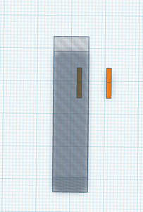

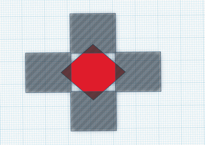

- That extra octagonal shape we put to the side earlier - it's time to use that. Sandwich it between your existing shapes - it should fill the gap perfectly
- Using square shaped holes, you'll need to cut out a sloped shape that will join your floating pieces together
- I used 3 40x40x40mm square holes, rotated 45 degrees and then squashed down to be half the height but as usual, play around and see what looks best to you and work around the capabilities of your printer if you need to.
- Unless you're better organised than me, having grouped your holes and octagon, you'll probably find you have a couple of bits of octagon that weren't cut off but that we don't want - you can just grab another square hole and cut away the leftovers!
- Next, take the slope you've just created and make 3 copies - place one in each gap between the upper and lower pieces - you will need to either rotate or mirror the pieces so they slope in the right direction
- If, like me, you're not using a square shape for your chain, you may need to adjust the length a little to fit the gaps better - for example, the slopes I used on the short edges of my chain link are half the width of the slopes used on the wider edges as my link is half as tall as it is wide

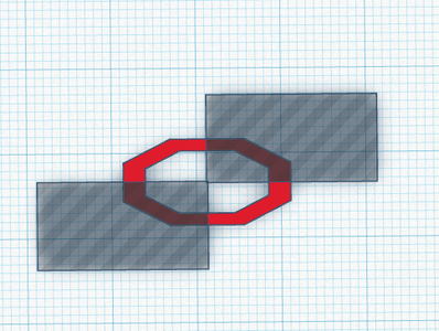

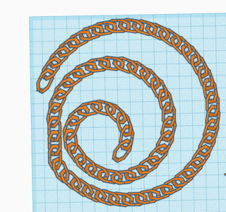

- Last step is to turn one link into a chain and can be a little bit of a fiddly process but making use of the duplicate and repeat tool in Tinkercad speeds it up significantly!
- Simply select your link and duplicate it with ctrl-D
- Without clicking away from the duplicate link, rotate it by a few degrees (I went with 5 initially) and use the arrow keys to move it up and across so that the 2 links aren't touching but will print linked up.
- Press ctrl-D again and your next link should appear ready linked into the last - repeat until you have enough links to print your belt
- How many links you need will depend on the size of your links and the length of your belt - I printed 70 and it came out roughly a meter long
- You probably will need to manually place a few links here and there otherwise you'll end up with just a circle of chain which is pretty cool but difficult to make a belt out of - I found a slightly imperfect spiral was the easiest shape to create

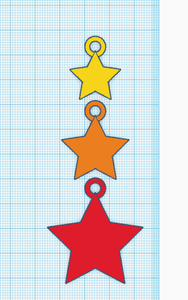

The simplest of the charms I designed are these stars
- Just grab a star shape and drop it onto the workplane - they're in the basic shapes but there are loads of other shapes you could use too!
- Grab a cylinder too and resize it - 8x8x1.5mm worked well for me!
- Take a cylinder hole and use it to cut out the centre of the first cylinder - I went with a 5x5mm hole for mine - you should be left with a ring shape
- Align the ring with the top of your star and group together
You've made yourself a charm! Consider trying different shapes and sizes for your charm - you can use the same ring on all of them!

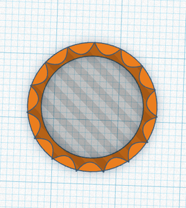

Step 6: Charms 2/3 - Coins!
Let's up the difficulty a little?
Let's make a charm that isn't just made from one of the Tinkercad basic shapes!
I thought some little coins could look really cute in a gold or silver filament!
- Start with the same ring as we made for the stars in the last step and a simple circle shape - mine here is 20x20x2mm
- Next you'll have to have a dig through the shape generators but you'll find a mandala shape in there!
- Resize it to be 30x30x4mm and turn it into a hole
- Position it 1mm above the work plane and centred on your circle

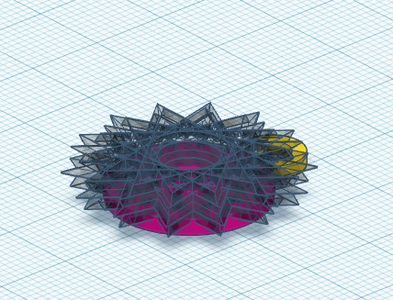

- Group the mandala hole and the circle - you should now have a pattern carved into the surface of the circle
- Take another cylinder - 20x20x3mm this time and again cut out the centre to make a ring shape - I used a 16x16 cylinder hole for this
- Again in the shape generators you'll find a sun shape
- Make it 20x20x.8mm, and reduce the inner radius to around .6
- Turn it into a hole and group with the ring shape you just made
- Align all 3 shapes and group them!!

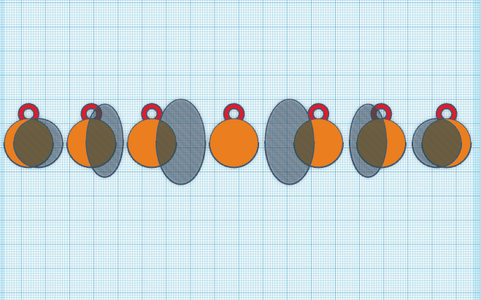

Step 7: Charms 3/3 - Moon Phases!

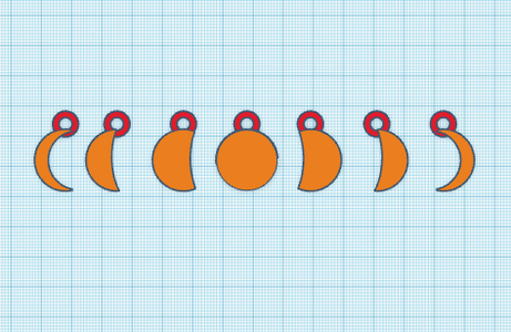

Finally, I thought it'd be neat to make a little set of charms that work together - I kept it pretty simple and just went with moon phases!
- Again, just use the same ring we used in the previous 2 steps
- You'll need to make 7 charms here so let's start with 7 20x20x2mm circles
- Next, use cylindrical holes to cut away parts of the circles to resemble the moon phases
- I'll admit, I just eyeballed this and I'm sure you could do something a little more authentic and accurate if you did a bit of research
- Group each circle with it's corresponding hole and ring to create your 7 charms

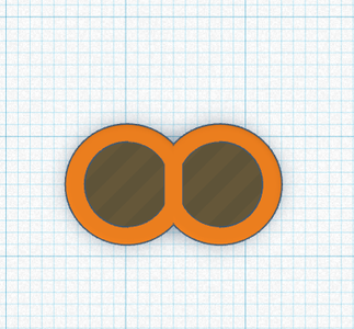

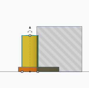

- Start with 2 10x10x2mm cylinders - align them and position them so they just overlap
- Next bring in a 7x7mm cylinder and centre it in the middle of one of the existing circles
- Cut away the edge of the smaller cylinder with a square hole
- Make the cylinder with the flat edge into a hole
- Duplicate and mirror the shape and centre it with the other circle
- Group everything to make a figure 8 shape
- Finally, use 2 square holes to cut out small gaps in the hook for the chain to slot through - I used 3mm wide squares and rotated them 22.5 degrees for my hooks - you should be left with something roughly shaped like a 3

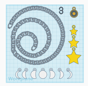

- If you've been following the design process in Tinkercad you can highlight the pieces you need and export them as stls ready to print
- If you're wanting to print my design, you should find all of my stls here for free on Thangs - my chain is roughly 1m long once printed - feel free to tinker with my Tinkercad project and add or remove links if you need :)
You may notice that in my pictures, my chain is laid out differently to in my project and stl. That's because I actually had a few links stick together when I test printed it - not enough to be an issue, they separated easily enough but I gave everything a shuffle around just to be sure!
For printing - I won't give you specifics as you know your printer and slicer better than I do but I'll give a few recommendations!
- Print your first layer nice and slow as there are lots of small pieces and you want to make sure they all stick well to the bed
- In the same vein, ensure your bed is clean and well levelled as you're likely to lose parts if it isn't!
- Print without a brim or raft as you'll find it difficult to remove afterwards and it shouldn't be needed anyway
- If you're having trouble with the chains sticking to each other - check that they're not too close to each other in your design and if not, consider printing at a slightly lower temperature if that's suitable for the material you're using
- I'd recommend printing this in PLA, as it has good bridging properties, and with your cooling on full (unless you have an insane cooling setup in which case, I'm sure you know what you need to do anyway)
- I also recommend printing the chain and the hooks/charms separately so if the worst happens and a link does come unstuck, it's just the chain that you have to reprint rather than everything
- Consider printing a short length of chain first - just 4 or 5 links to test your design before starting a big print!
