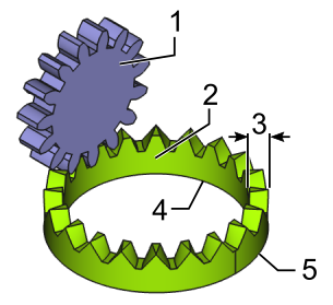

The clock in the book is broken and in the book, if you turn the winding crown the hour hand moves from the VII (7) to the IX (9) I decided to replicate this movement. To do this I decided to use crowned gears. Crowned gears (as the name implies) look a lot like crowns and have their teeth facing upwards. They can mesh perfectly with spur gears. To move from VII (7) to IX (9) in one rotation of the winding crown I'd have to use a 6:1 gear ratio. I chose to go with 5 teeth on the spur gear and 30 on the crowned gear.

Step 9: Making the Crowned Gear
I started by creating another spur gear with the same module but this time with 30 teeth.
I expanded the group in the timeline and deleted the pattern the tooth around the cylinder step.
Next, I created a sketch on the center cylinder.
After that, I sketched a circle with a diameter of 30 (teeth number) * 1.5 (module) = 45 mm.
I created a line from the center of the circle to the outside of the circle on the small tooth.
Then, I created a line perpendicular to the first line (our axis on which to rotate the tooth).
Afterwards, I rotated the tooth around the axis 90 degrees.
Step 10: Making the Crowned Gear Part 2
Now I lofted the front part of the gear with the center of the gear. (the origin in my case)
Then I patterned the loft 30 times around the circle.
I adjusted the baseplate for the gear using the press pull function to fit the current arrangement of teeth.
Next I cut a large hole through the middle of the crown gear to save printing material.
