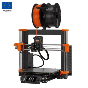

  • 3D Printer
  • 3D Printer Filament (something durable like PETG)

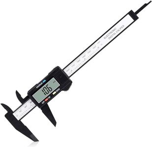

  • Calipers
Step 1: Measuring
First pull out you calipers and take some measurements. You can write them down on a sheet of paper or you can do it digitally.

Step 5: Slicing and Printing
  • In your slicer, place the part on its side
  • Enable supports (not needed if you did the optional step in Step 4)
  • Slice and print
