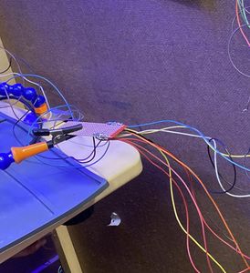

As well as the LED code to have any one of the 10 buttons light up when the spinner is finished spinning, and finally, a buzzer connected to a button that starts 10 rounds of a 3-second countdown that indicates how long you have to successfully push the button. Finishing the code meant we had to finalize the construction and appearance of the project which involved laser cutting, gluing, and finishing each button and then attaching it inside each of the holes so that it is a satisfying button to push. We accomplished this by gluing a small portion of a dowel onto the back side of the box, which we had double-sided at this point with more of the hardboard, and gluing the button to the dowel. Each button was placed above 3 LEDs that we had purchased and soldered together. The soldering was a whole separate endeavor as we had allocated 3 LEDs to light up one button. Each LED had a ground, power, and pin connector. Three LEDs were to be placed behind the button, they (with those three wires each) were connected using a protoboard, and all 10 power lines and 10 Ground lines were soldered onto another proto board connecting 90 wires in total for just the LEDs. We connected the third wire of each button to pins on the Arduino-Uno, which we had attached to the back of the box. The button was connected to the buzzer through soldering as well and tested to make sure that the button triggered the tune we programmed, the spinner was tested and secured to the board, half inside the enclosed circuit space and half outside so that it was visible above the spinner artwork that was placed on the game. Each of the individual parts worked properly except that when we combined them and tried to test the full project, we could not due to a short, which after sorting through the wiring we located the cause of the short. One of the LED wires had caused a short. When we connected it to the Arduino, when everything else worked properly, it would turn the Arduino-Uno off. So we decided to show what we had, our polished and finished project, and show it to our instructors, and then after the demonstration day, take it apart to test and document each of the working parts again. Using those clips in the video, we described how the project went wrong and what we would have done differently in the future. Wiring was our issue. We should have coordinated each of the LED wires better, color coordination would have helped. A suggestion from our instructor was to line the wires along the inside of the box vertically and horizontally to keep everything more organized and to help with visibility.

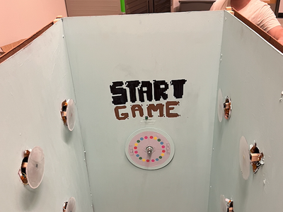

Now that we have the button sized as we like, cut holes into the walls that fit the buttons that will be attached to the back of the acrylic circles. Cut these holes on the side walls as the middle wall will be used to place the spinner and start button.
Step 6: Make the Spinner
Now that the arrow is made, make a circle with alternating colors and write "Right Hand", "Left Hand", "Right Leg", and "Left Leg. After you will want to hot glue the back of the motor to the center of the spinner. After this is done, hot glue the acrylic arrow to the motor part that spins. Make sure none of the glue spills over as this can damage your motor.

Cut the Neopixel strips into 30 individual strips as you will want to stick 3 of these individual strips evenly on the back of the acrylic circles.
Step 8: Soldering
Once all buttons are set up solder the wiring to the LED's and to allow connections. Make sure to organize and color code your wires to not lose track. Test every individual button once they are done as well to make sure there is no shorting.

Install all buttons, spinner, and start button into their respective holes and hot glue them in place. As well, when placing the wires, make right angles and organize them properly so that they don't get mixed up. As well, ensure there are no stray wires as it may cause a short.
Step 11: Enclosure
Add the back panels to all walls except for the wall that includes the Arduino board as you will need access to add the code and power supply. Use the screws and screwdriver to fasten these walls.
