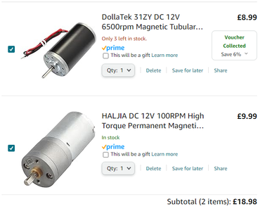

Step 3: Electronics
In photo one these are the items i used to power the project, the high torque motor has enough power to turn the initial gear with my motor running at 100 rpm. This other dc brushed motor can be used as a generator, since its a brushed motor it produces dc voltage however if it was a brushless motor that would produce ac voltage usually 3 phase. The voltage the motors produce is as much as you need to power the motor so if the motor is 12 volts than it will produce 12 volts. you can test this if you have a 3d printer which you need for this project and move the bed back and forward very fast the printer turns on
Since my generator outputs the right voltage all I done was soldier the wires from the generator onto the motor without the need for and ac-dc circuits or resistors just soldier the positive and negative
However i ran into a problem of how to start the motor in the first place. In the end I opted to use a 8 1.5 volt batteries in series to produce 12 volts and 1-2 amps due to high resistance this has enough power to start the motor.
