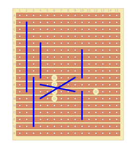

Using a stripboard cutting tool or some similar implement, cut the copper tracks as shown. Keep in mind, the image shows the top side of the stripboard, so be careful to cut the correct tracks when you flip it over.
Optionally, clean the prepared stripboard using pure isopropyl alcohol and paper towel or a cloth. This can help make it easier to solder, especially if the stripboard is old (like mine was)

Solder all the parts to the stripboard. It's generally best to work in size order from the flattest to the tallest (i.e. Jumper wires, IC, Diodes, Caps, Resistors, Headers, Voltage Regulator.
Don't forget the two jumpers between IC pins 2 and 6, and 4 and 8, which are under the board.

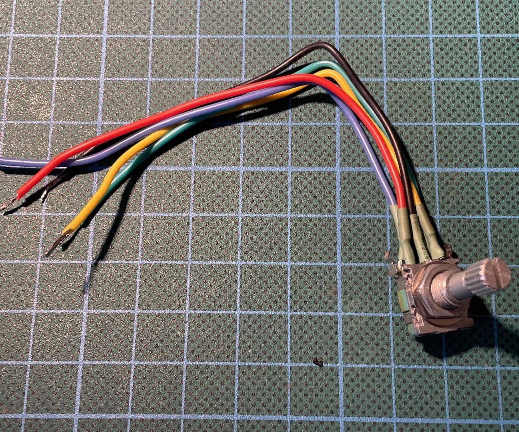

Solder wires onto the external components (potentiometer and LED if you're using one) and optionally protect the joints using heatshrink tube, then connect them to the stripboard.
