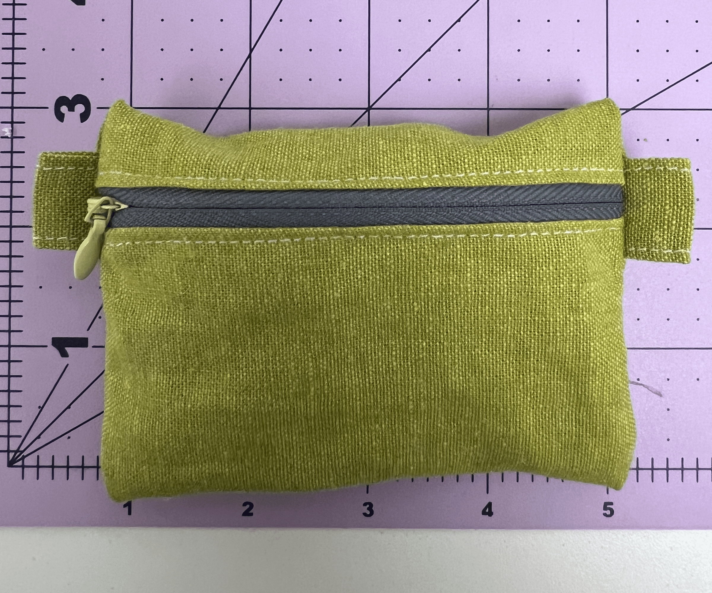

Introduction: 5 Liter Stuff Sack
A light weight stuff sack that is 5 Liters in volume
- by Mckhelcy Sagun
2 - pieces of 23 long 1 inch webbing
35 - inches of 1 inch webbing
2 - 1 inch buckle sets
6.25 inch diameter piece of fabric
10x13.5 piece of fabric
Step 1:
Roll a hem towards the wrong side using 1 inch and sew it down with a basting stitch
Step 2:
Do the same on the other side using .5 inch of fabric with a top stitch
Step 3:
Align the middle of the webbing and fabric piece on the top and feed the female buckle through the sides
Sew the 1 inch webbing along the top wrapping around the fabric
Reinforce the edges
Step 4:
Sew the outer edge and leave the top and bottom open
Sew with 2 passes and close the edges with the knit or zig-zag stitching setting.
Step 5:
Sew the webbing in the middle .25 inches away from the edges in a rectangle pattern with a line through the middle
Step 6:
Feed the straps through and sew the circular piece to the edges of the main body with all wrong sides facing you
Make 2 passes and 1 knit or zig-zag setting pass
Step 7: Completed
Sew the stoppers on the webbing for the buckles and you are finished
