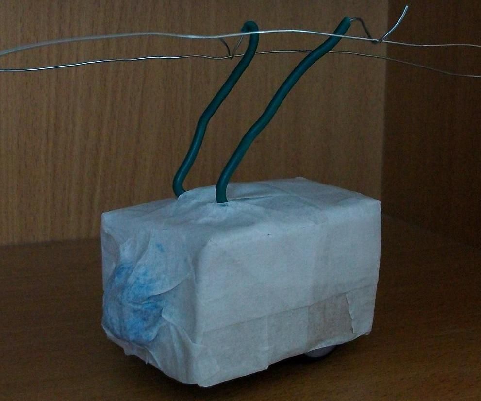

I made the circuit with wire wrap. I did not use a soldering iron. I wrapped the wire wrap around the component legs. You can also twist the component legs to join two or more components together like you do with wires.
Step 4: Encasement
I used scissors to cut a hole in the cardboard box for the potentiometer.

Step 10: Attach the Gear Motor
I put a wire through the holes of the gear motor to attach it to the back of the dinosaur. The space in the front can be used for the circuit.
Step 11: Attach the Wheel
I attached the wheel and connected a thin wire from the top of the head to the wheel. You can use a thin rope or string.
Step 12: Testing
The sculpture worked.
