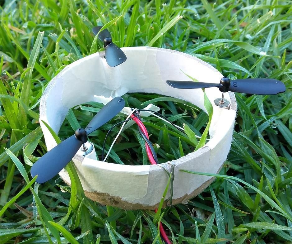

I had left over motors from my one of power generating projects. Those motors had poor efficiency when I comes to power generation. They began to rust. This I decided to make a miniature toy trolleybus.
I used masking tape. You can use staples or super glue or glue gun.
I used two 6 V power source. The bus might move with only 3 V. Typical motors can ran on voltages from 3 V to 9 V. I suggest that you do not use a 9 V battery for this project. You will drain this battery (9 V) very quickly.

Step 1: Make the Box
I made the box from 15 cm by 15 cm piece of cardboard.
Step 2: Attach Motor to Cardboard Fixture
The length of my cardboard fixture is 9 cm. This is the minimum length. You can try 10 cm, 11 cm or 12 cm lengths.
Step 3: Place Motor Inside the Box
I inserted the motor inside the box.
Step 4: Attach Metal Wire Terminals
I attached wire terminals to insulated wires and sealed with masking tape.
Later I completed my toy trolleybus by attaching a weight at the front of the bus that you see in the picture on the first page because the bus was falling on its back.
