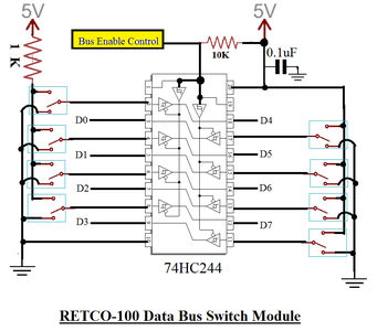

This is the circuit diagram of the whole computer, divided into multiple modules.

Step 4: Make Connections Between the Data and Address Bus Flip-flops Buttons and the Buffer IC
Step 5: Make Connections Between the Buffer ICs and the Data and Address Bus
