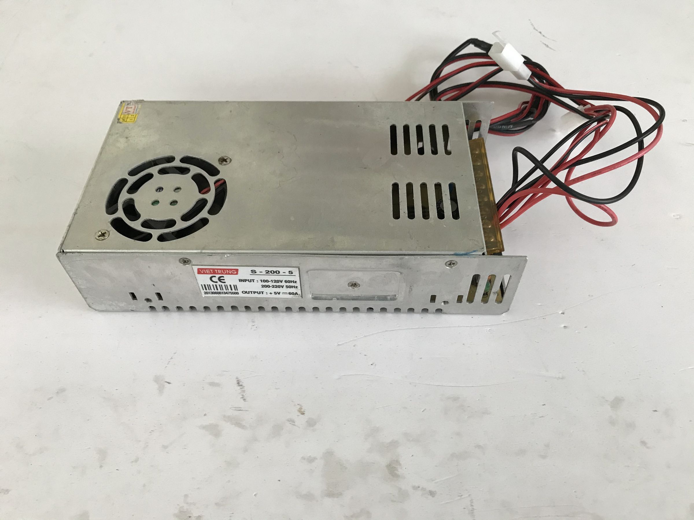

- POWER SUPPLY 5V, 10A. (I USED A POWER SUPPLY 5V-60A FOR THIS PROJECT)

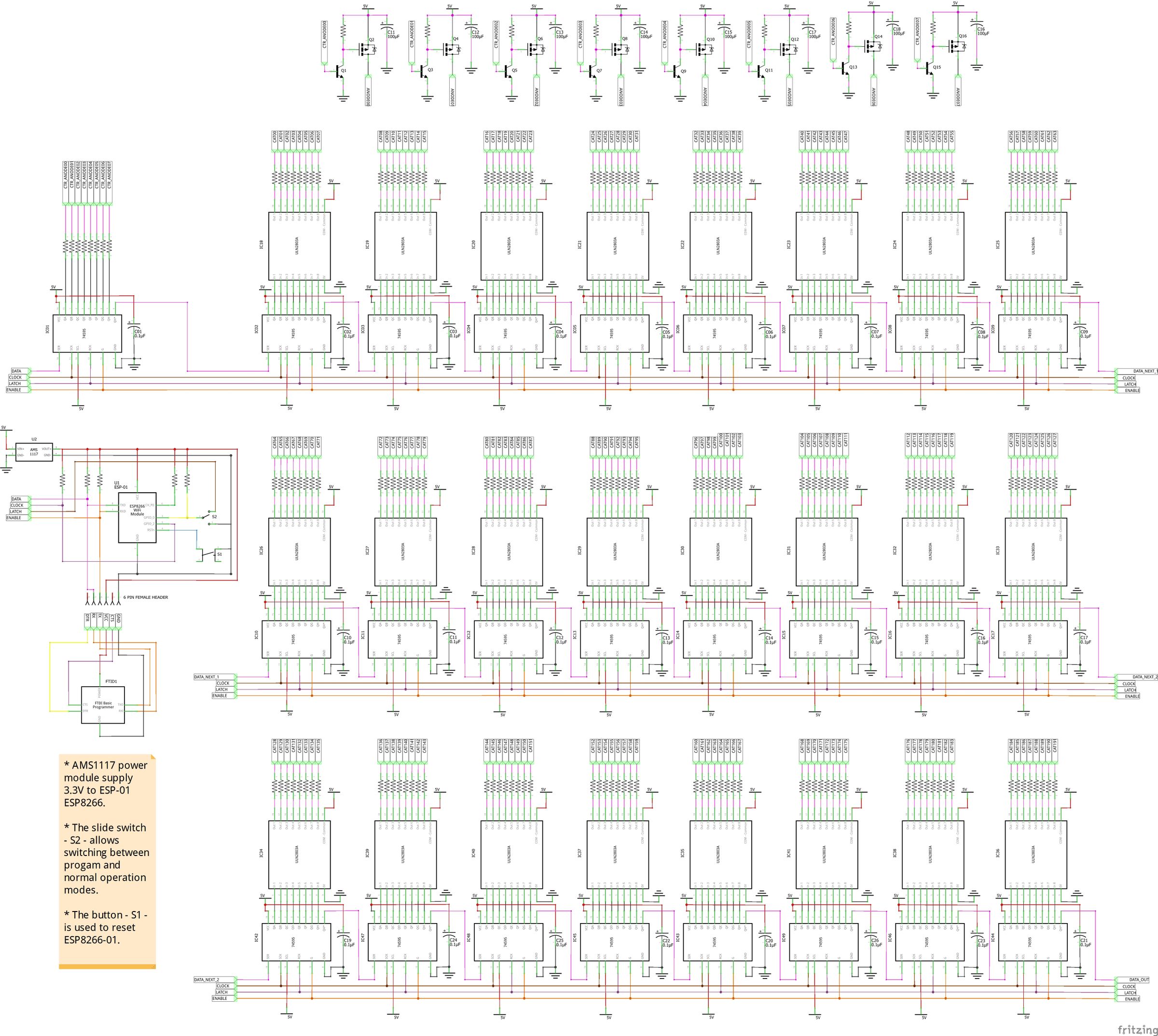

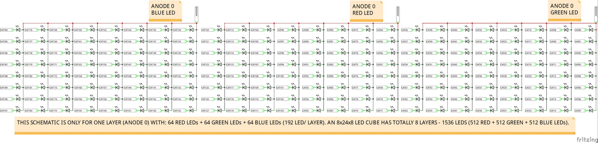

Step 2: SCHEMATIC
The overall schematic for 8x24x8 led cube has big size file, you can download it in high resolution HERE.
I divide this overall schematic into 2 blocks to easily visualize:
Block 1: Led modules, include 3 x 512 = 1536 leds which are soldered in 3 separated sets of led cube 8x8x8
- 8x8x8 red led cube module: 512 leds.
- 8x8x8 green led cube module: 512 leds.
- 8x8x8 blue led cube module: 512 leds.
Below schematic only shows one layer (ANODE 0) with 192 leds, all led's anodes in same layer are connected together (to ANODE 0) and their cathodes are separately connected to cathodes scanning module. An 8x24x8 led cube has 8 layers with 1536 leds in total.
Block 2: Control modules, include:
- Anode scanning module: 1pcs x 74HC595 + 8pcs x 2N2222 + 8pcs x IR9540.
- Cathode scanning module: 24pcs x 74HC595 + 24pcs x ULN2803. If we use 24pcs x power logic shift register TPIC6B595N, all ULN2803 would be omitted.
ESP-01S controller module: including mode slide switch, reset button, programming header and AMS1117 power module for converting from 5V to 3.3V.

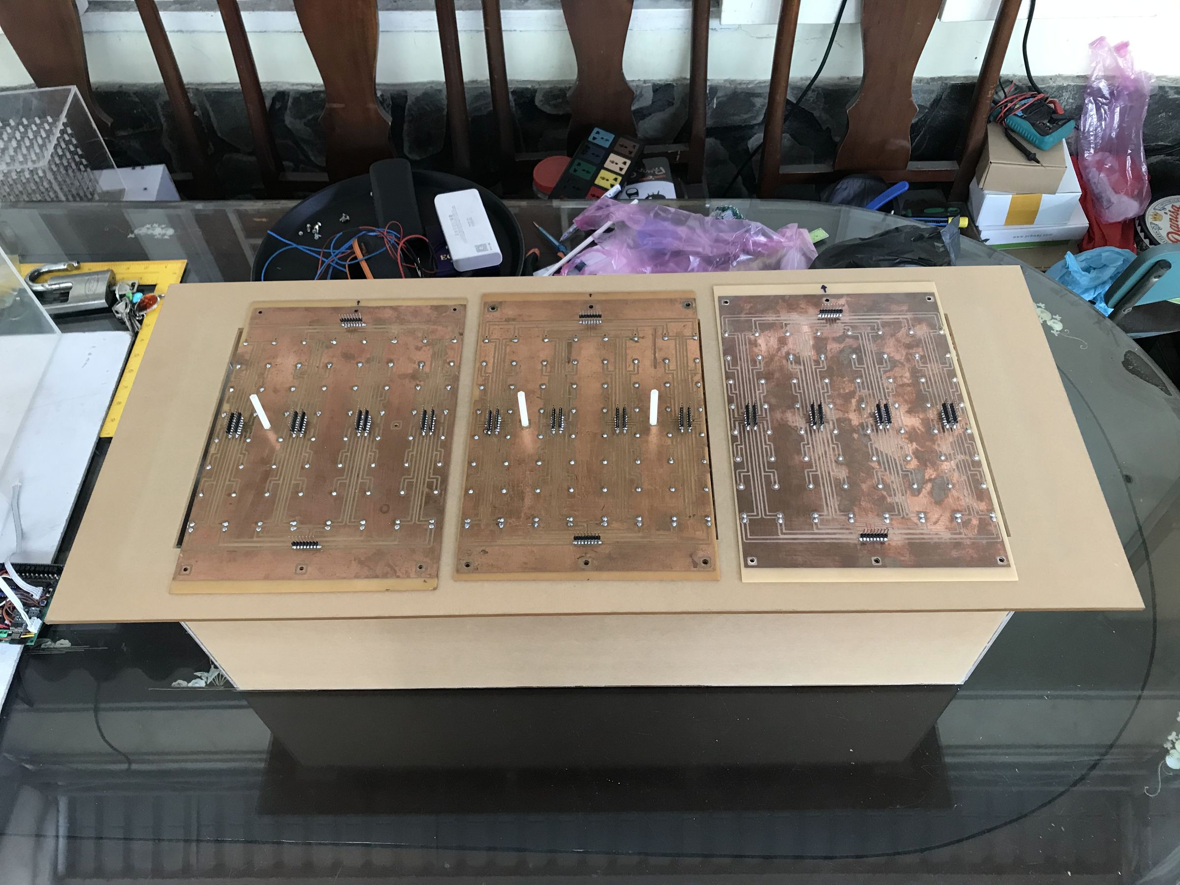

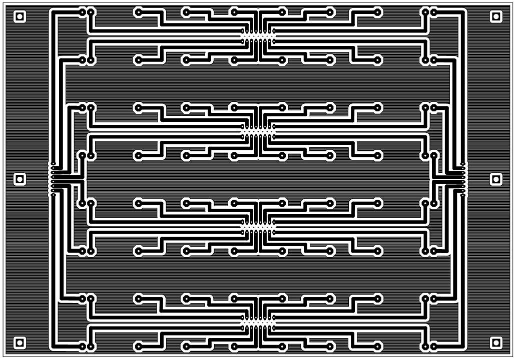

Step 3: PCB DESIGN

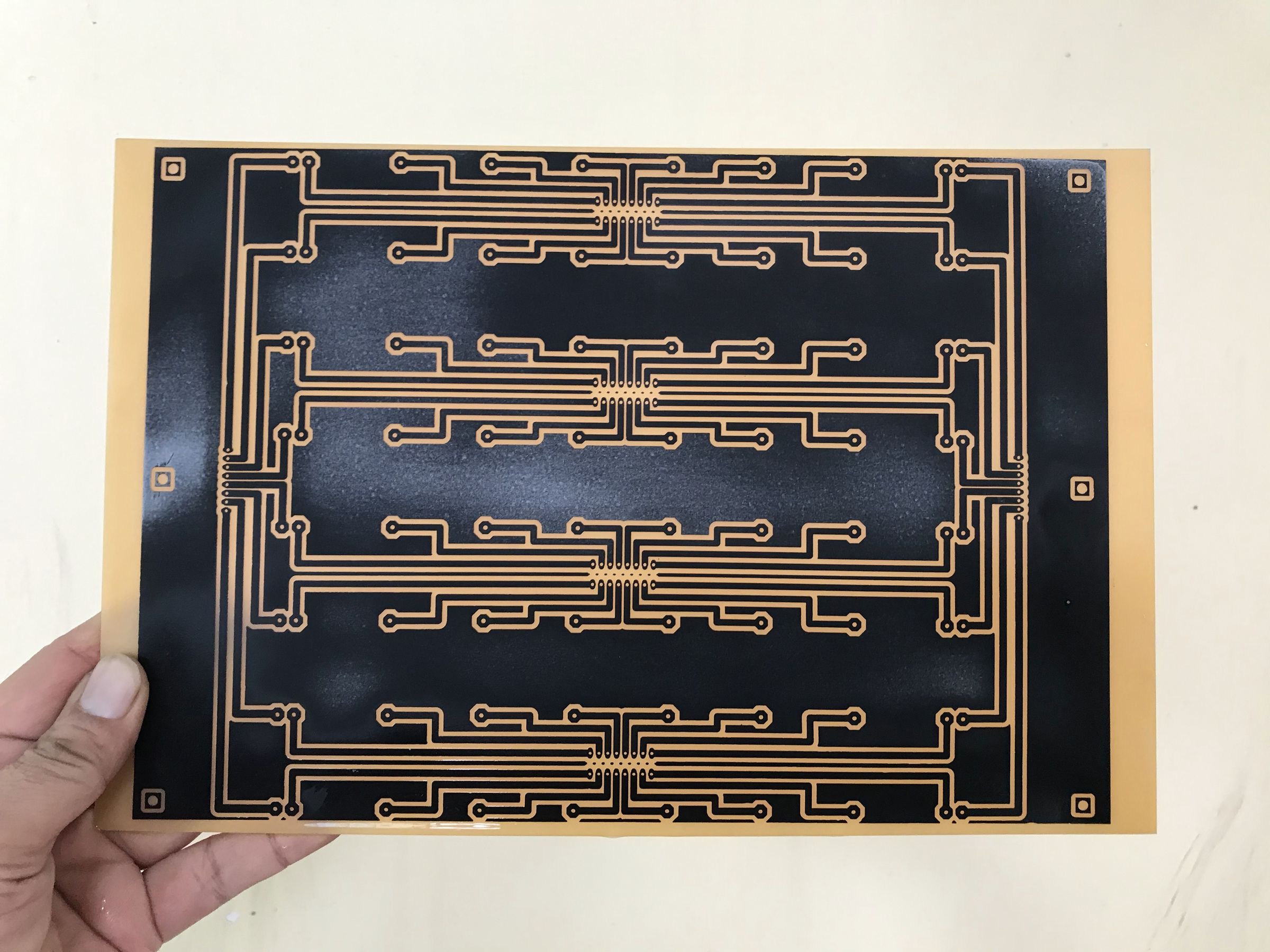

I designed the printed circuit boards on EAGLE software. Because I do etching these PCBs myself, I had to design them in such a way that they could be easily fabricated.
- Led cube base PCB:
We need 3 x led cube base PCB for led cube 8x24x8. You can download it in real size high resolution PDF file HERE.
Notes: We can print out this PCB file, stick on the wooden template, and drill at 64 cathode holes with diameter 5mm. Later, after soldering 64 leds on wooden template, we can place and align 64 led's cathode easily on cube base PCB.

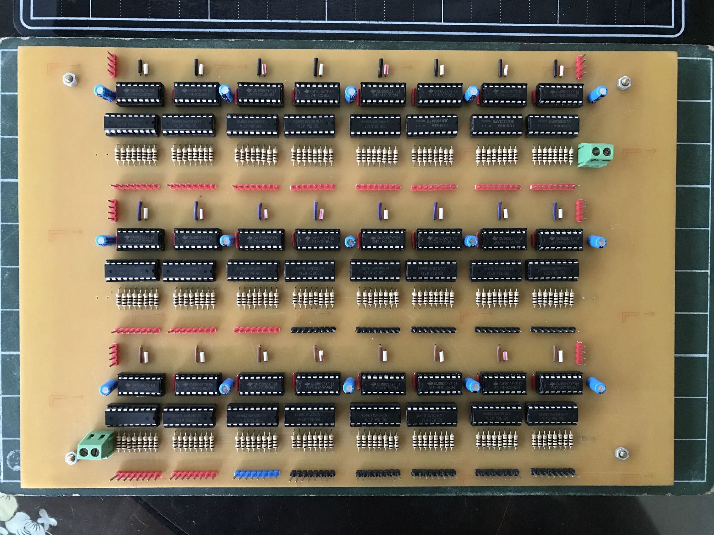

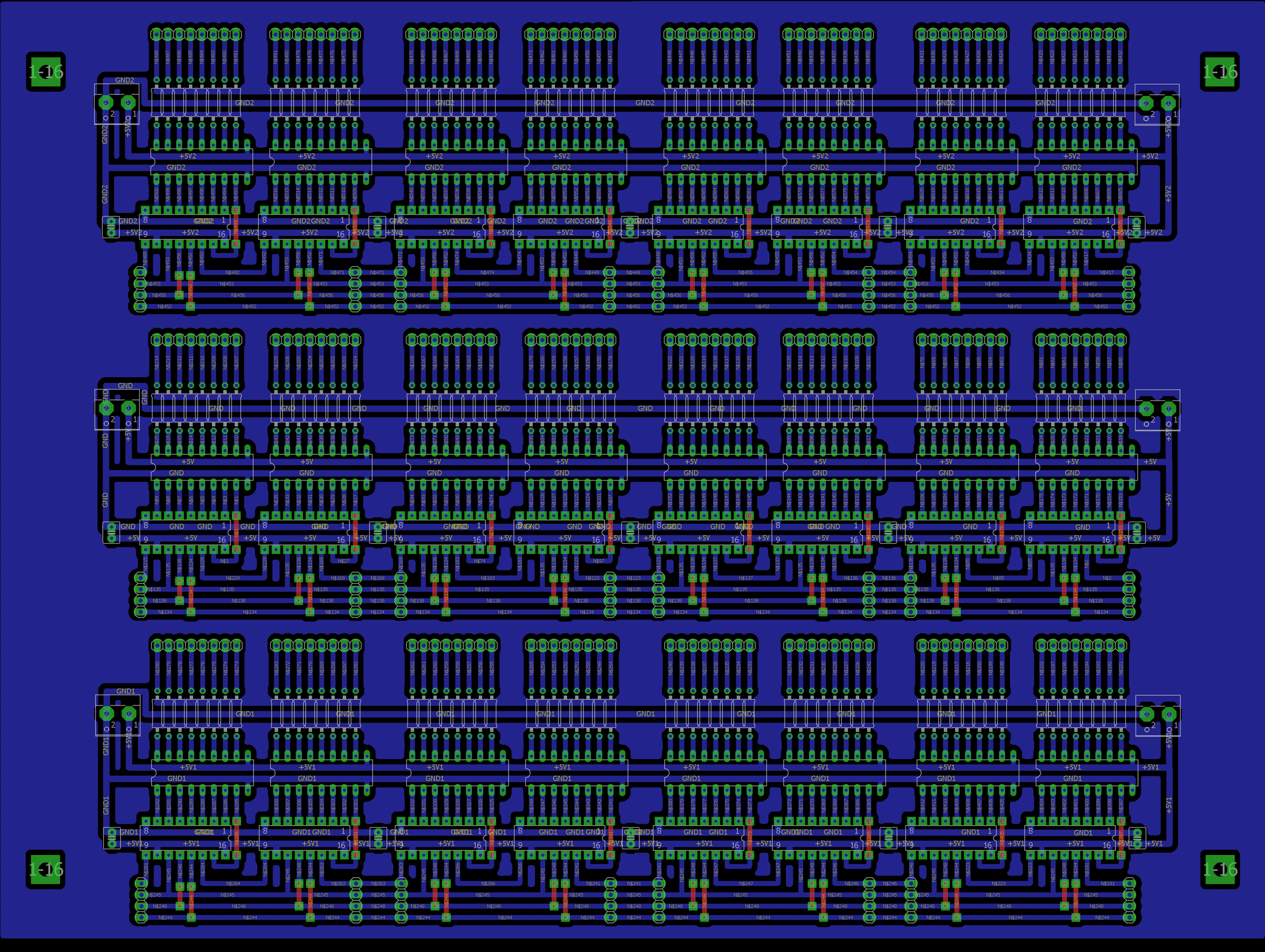

- Cathode scanning board PCB
Cathode scanning PCB is divided into 3 groups, each group consists of 8x74HC595 + 8xULN2803 and is used to control 512 leds.
You can download cathode scanning PCB in real size, high resolution PDF file HERE.

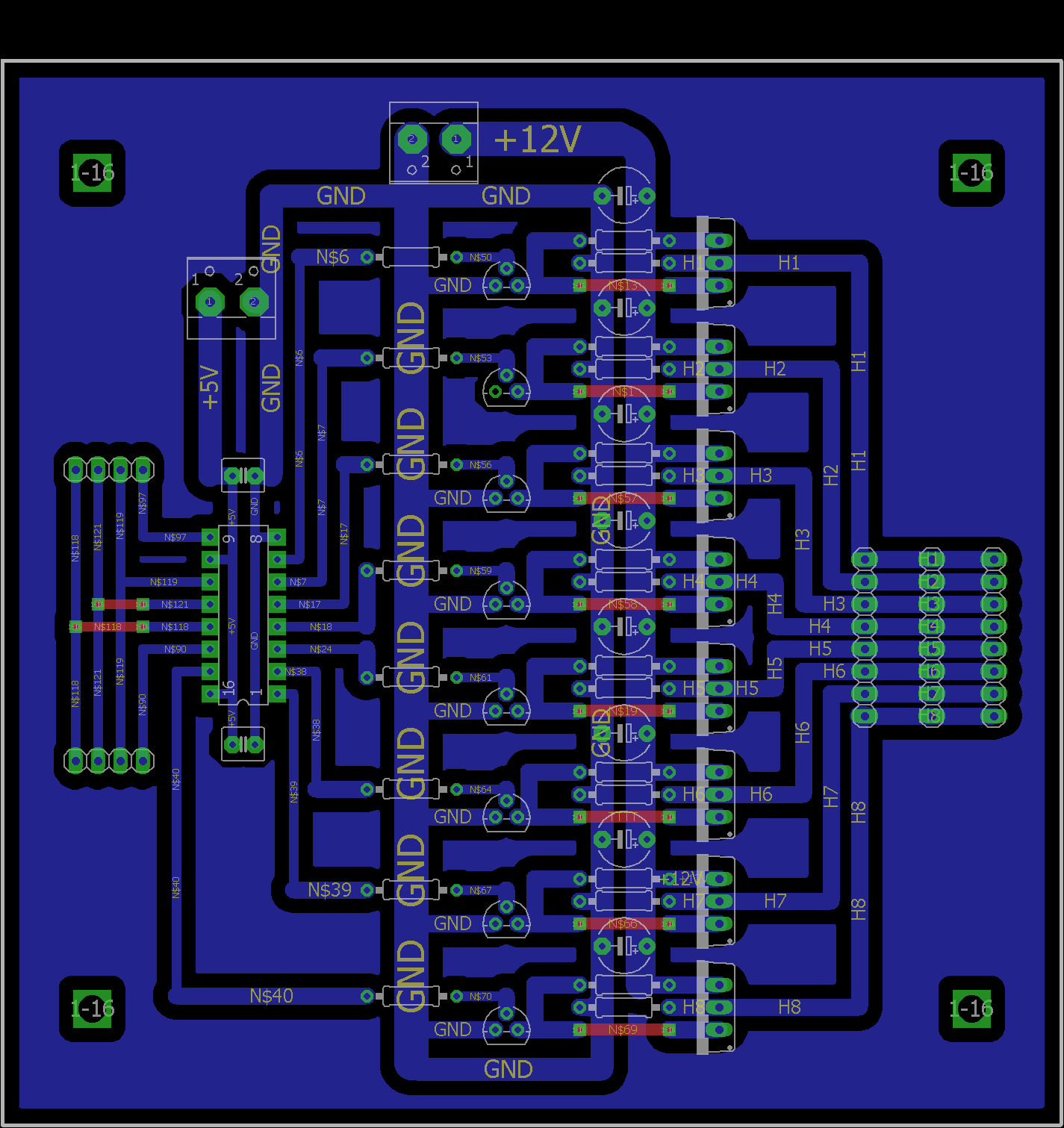

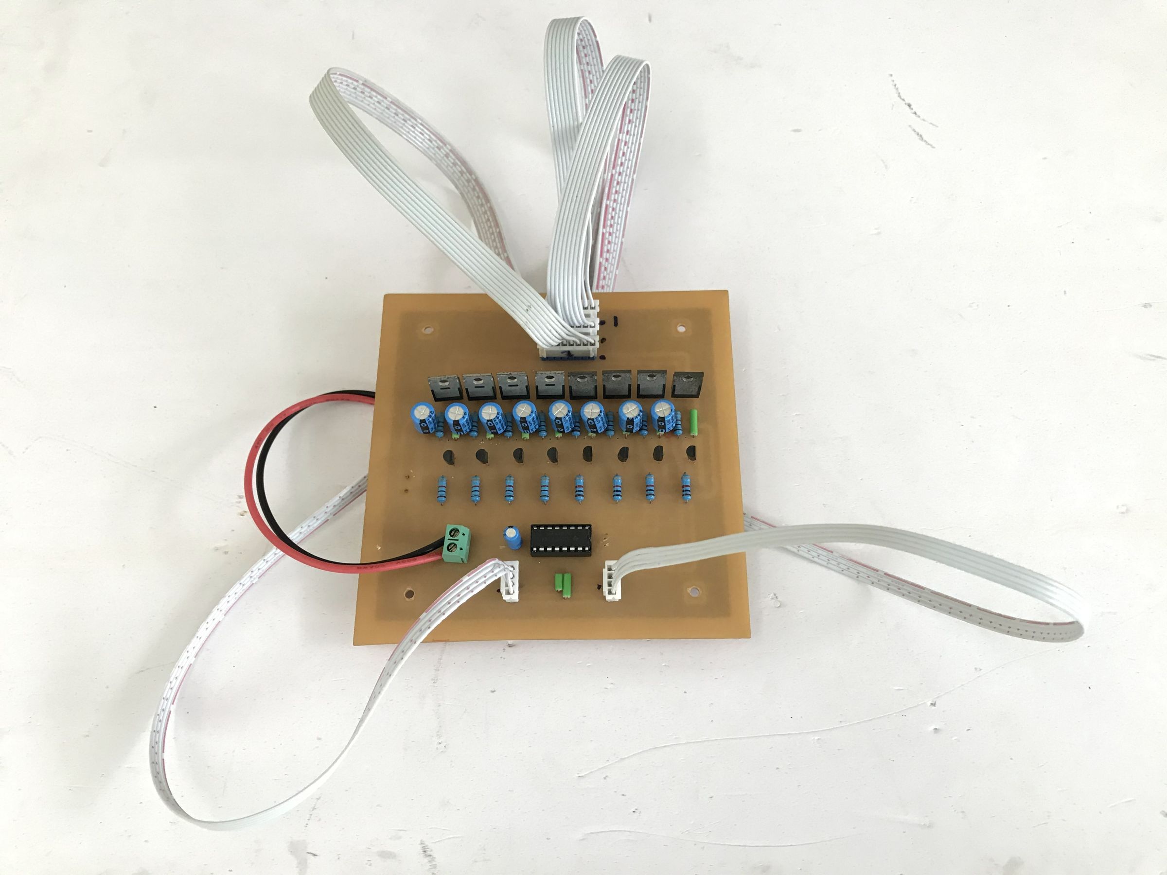

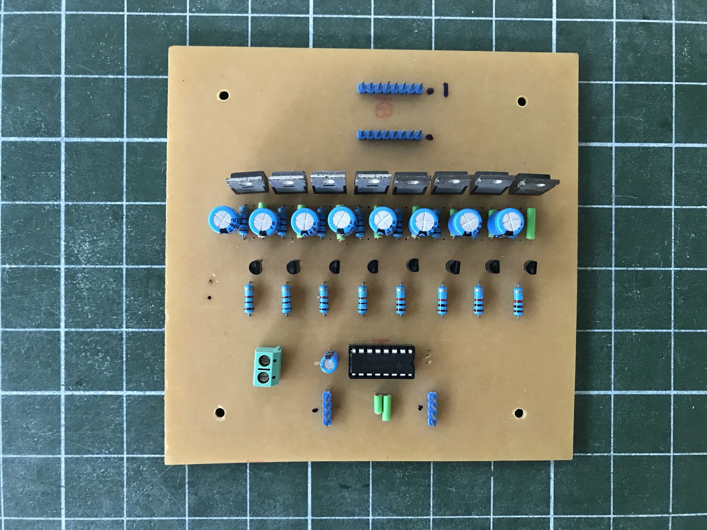

- Anode scanning board PCB
It consists of 1x74HC595 + 8xIRF9540 and is used to control 8 layers of led cube.
Anode scanning PCB in real size, high resolution PDF file is posted HERE.
Note: Firstly, the anode scanning PCB is designed base on the schematic below, take note that R002 (R100) was finally removed on my real PCB. In my overall schematic, these resistors R100 also don't exist.

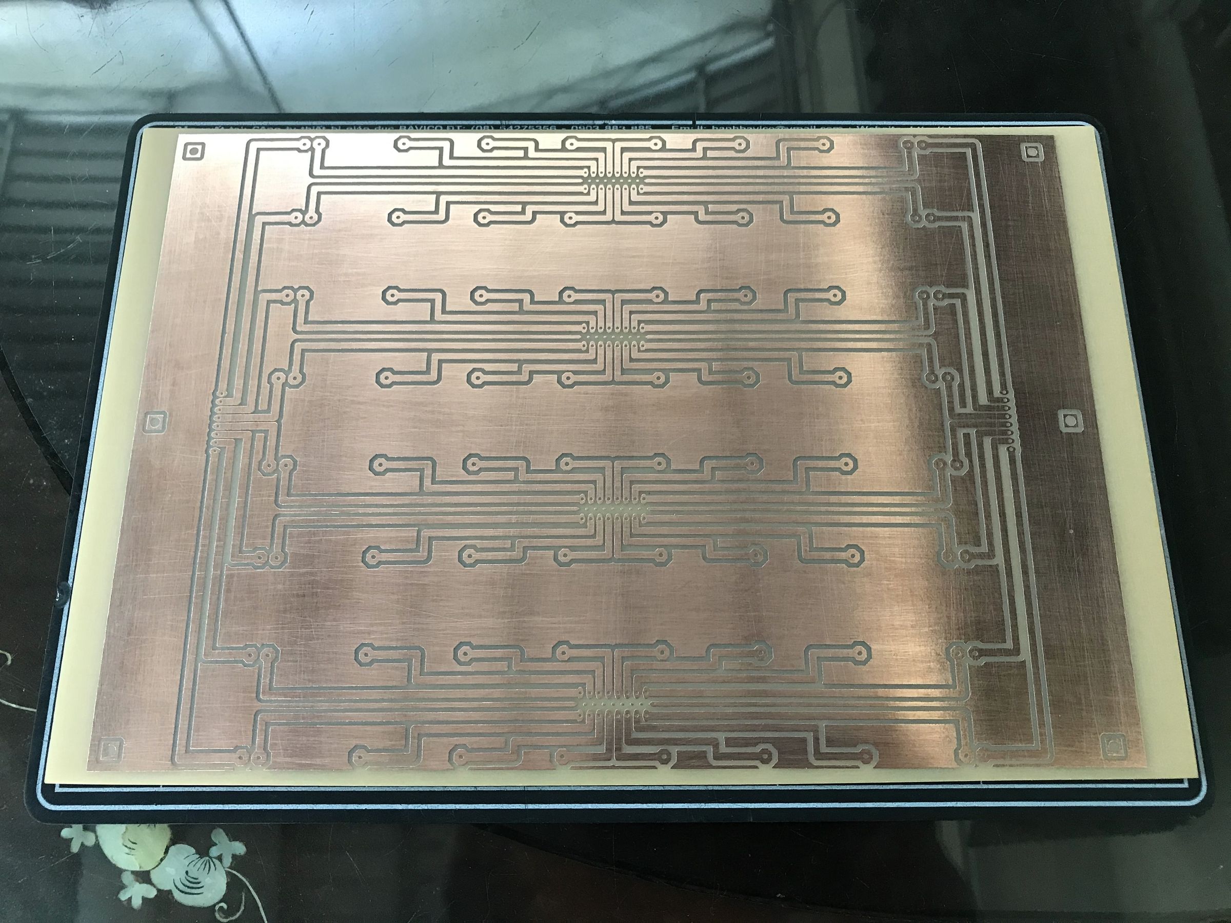

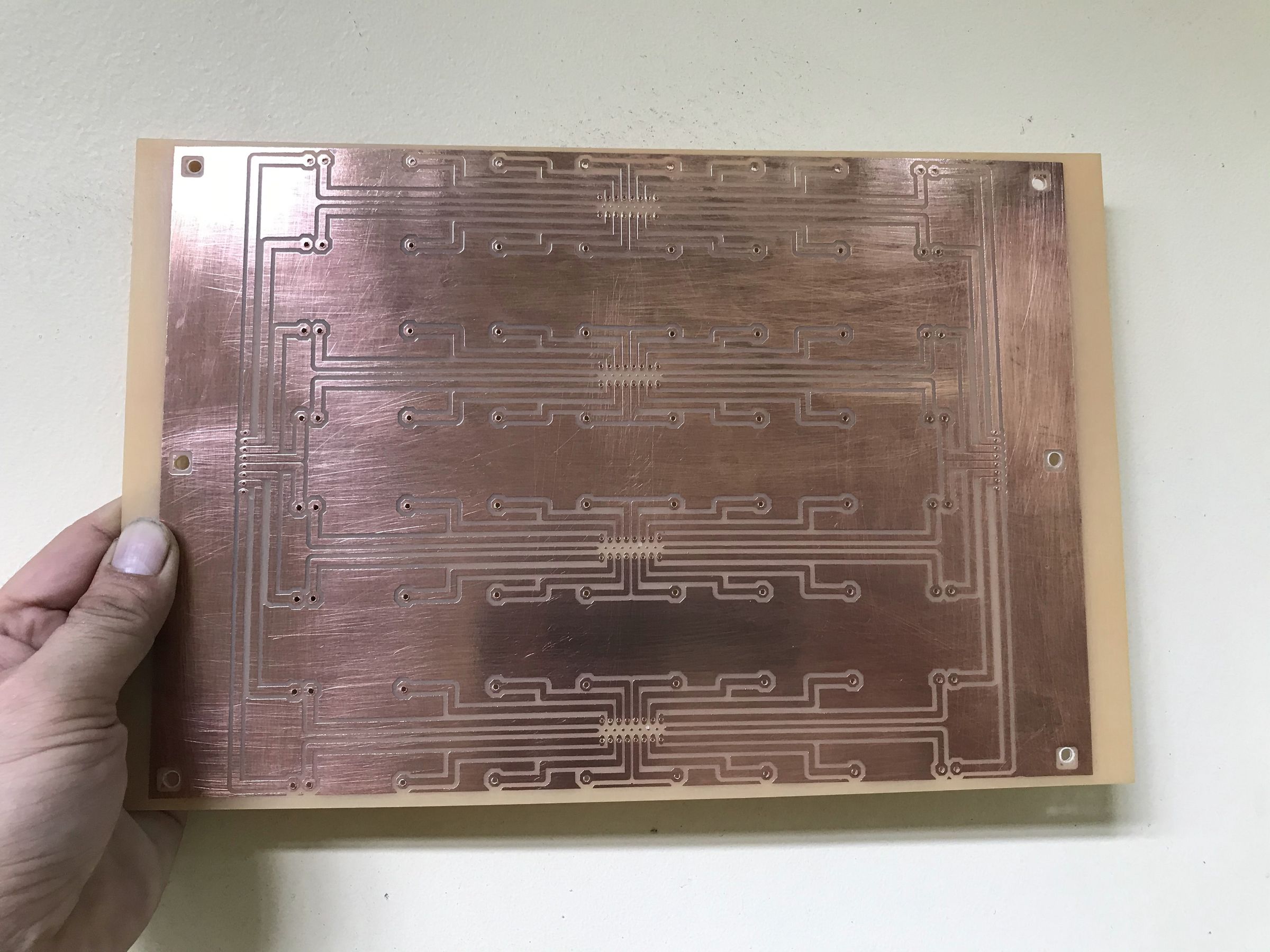

Step 4: PCB ETCHING, DRILLING AND SOLDERING
To make a circuit board at home, I used Clothes Iron Toner Transfer method that simply print the circuit design out on a laser printer, iron it onto the copper, and etch by Ferric Chloride.
You can see some processes that I did with Led cube base PCB.
- Etching
- Ink removing
- Drilling holes

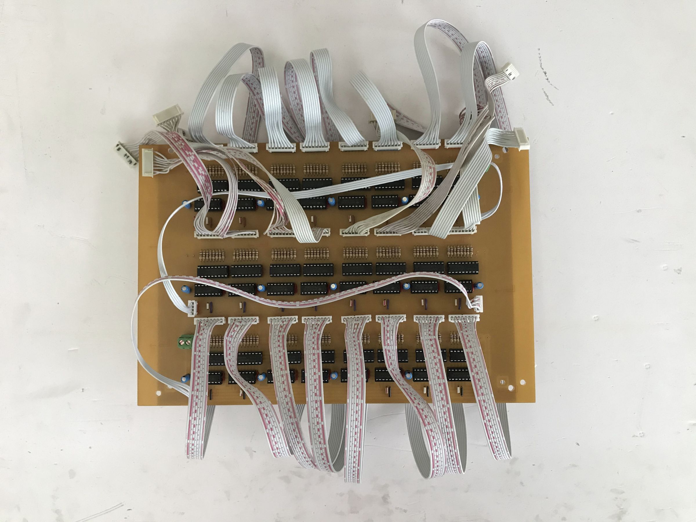

My result for anode and cathode scanning PCBs after soldering all components:
- Anode scanning PCB
- Cathode scanning PCB

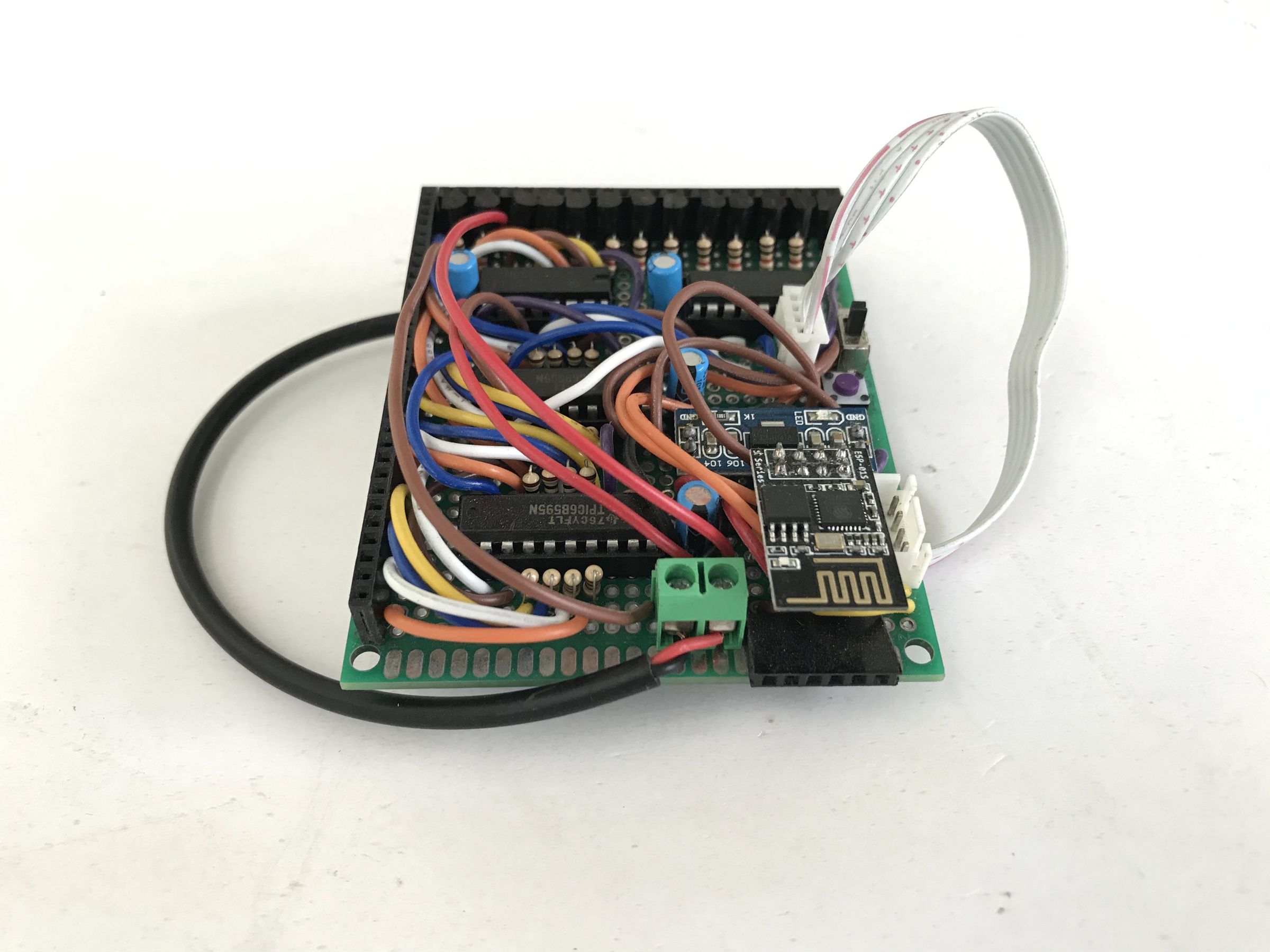

- ESP-01 control board: I resued this control board from my previous project "MAXIMIZE THE CAPABILITIES OF ESP-01 ESP8266". It has one 4P male header available for SPI control.

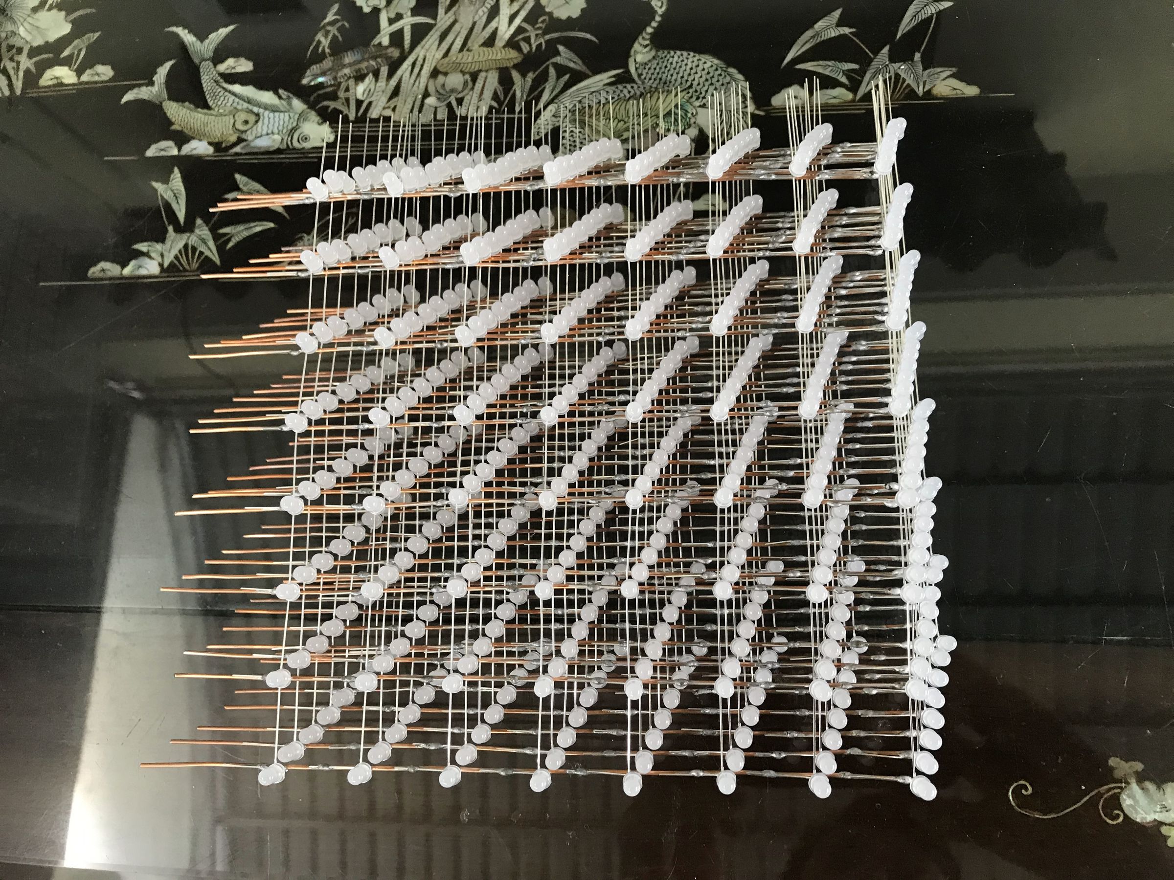

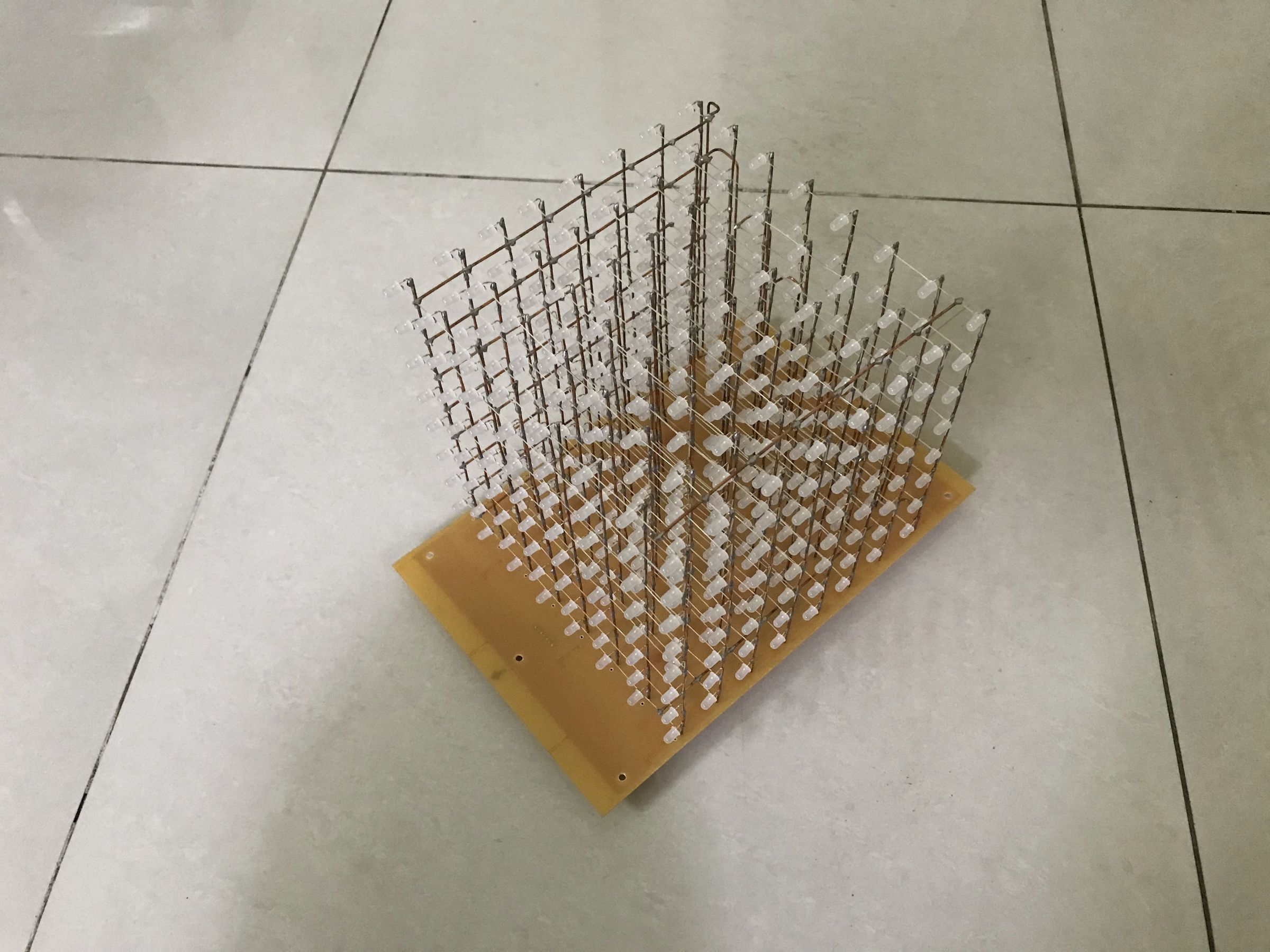

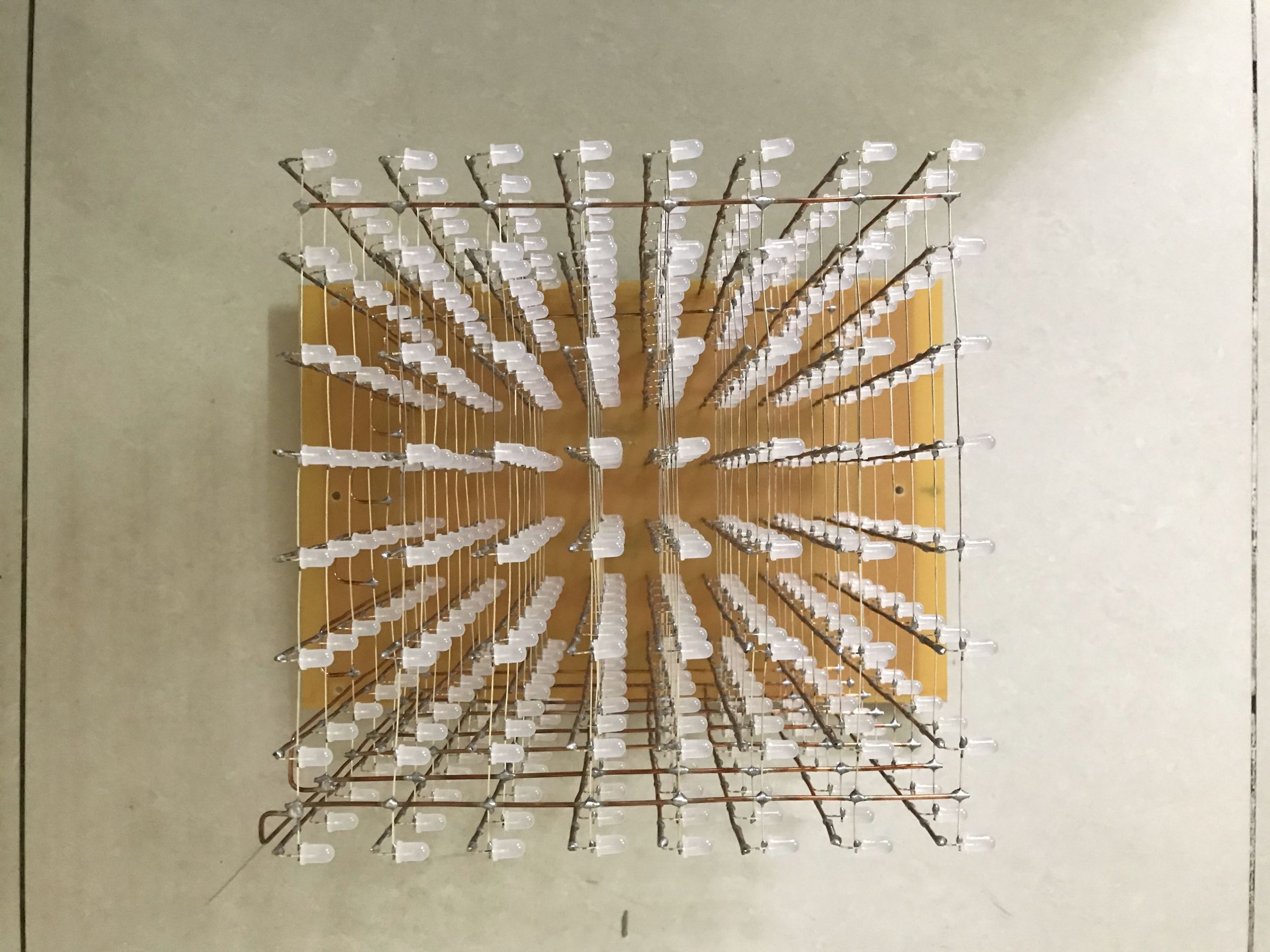

Step 5: LED SOLDERING

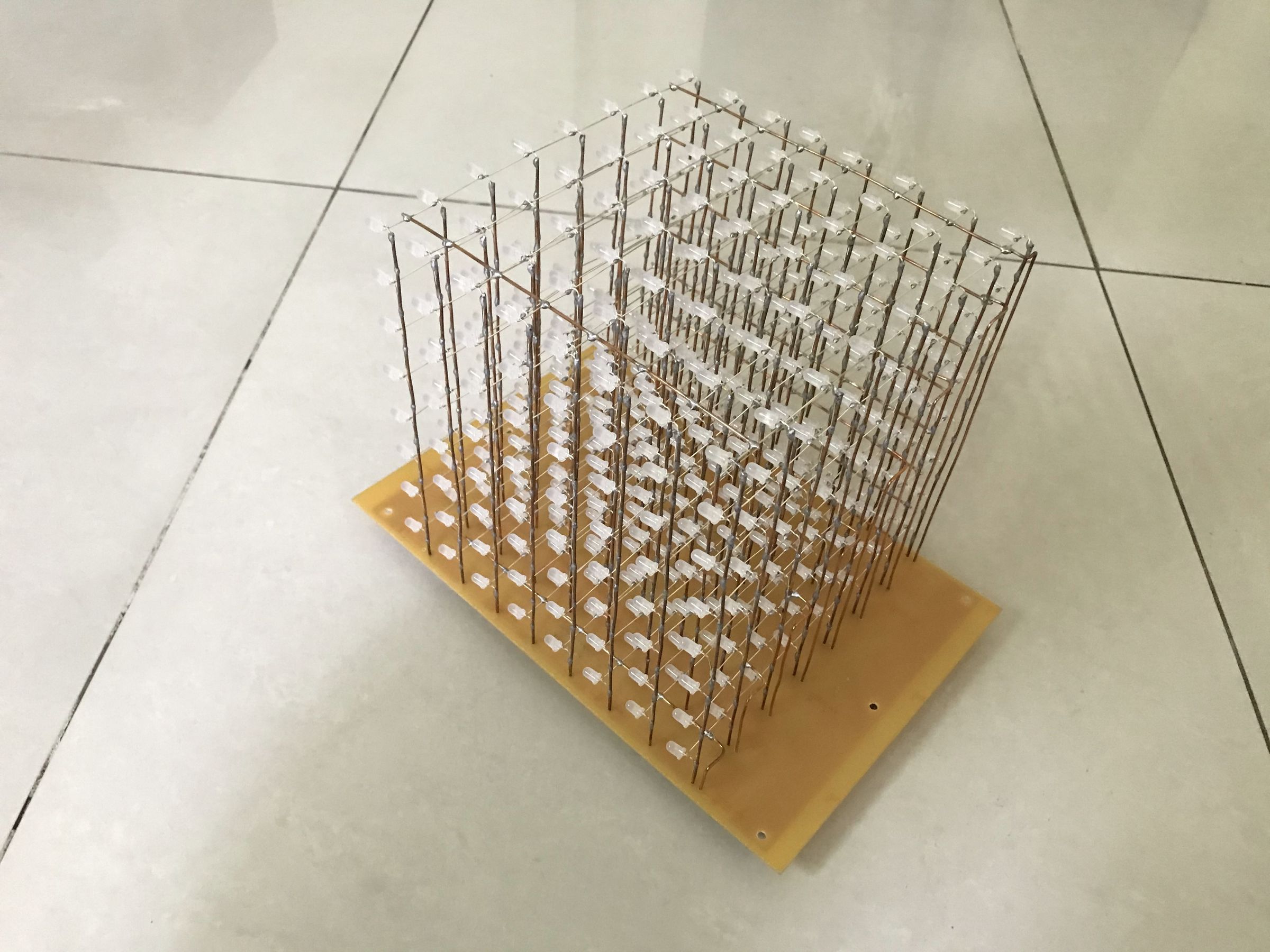

Soldering 1536 LEDs is not easy. It take your time and efforts. Be patient, solder it carefully and double check every single LEDs by battery before/ after soldering. To build an 8x24x8 led cube, I soldered 3 separated led cube 8x8x8 with different colors: red, green and blue.
After soldering 64 leds arranged on the wooden template, we have one plane of led cube 8x8x8. The picture below shows 8 x led cube's planes which will form an 8x8x8 led cube later.
Soldering 8 planes to led cube base PCB, doing alignment and connecting 64 leds in same layer by bare copper wires diameter 1.5mm.
At backside, I soldered 8 layers to anode header by bare copper wires.
Just finished one led cube 8x8x8, I did the same with 2 remaning led cubes. Take notes that we should check carefully one more time when we finish every cube. If one led or some leds are damaged, shorted-circuit or open-circuit, it would effect to all other leds in the cube, it causes ghosting or flickering.

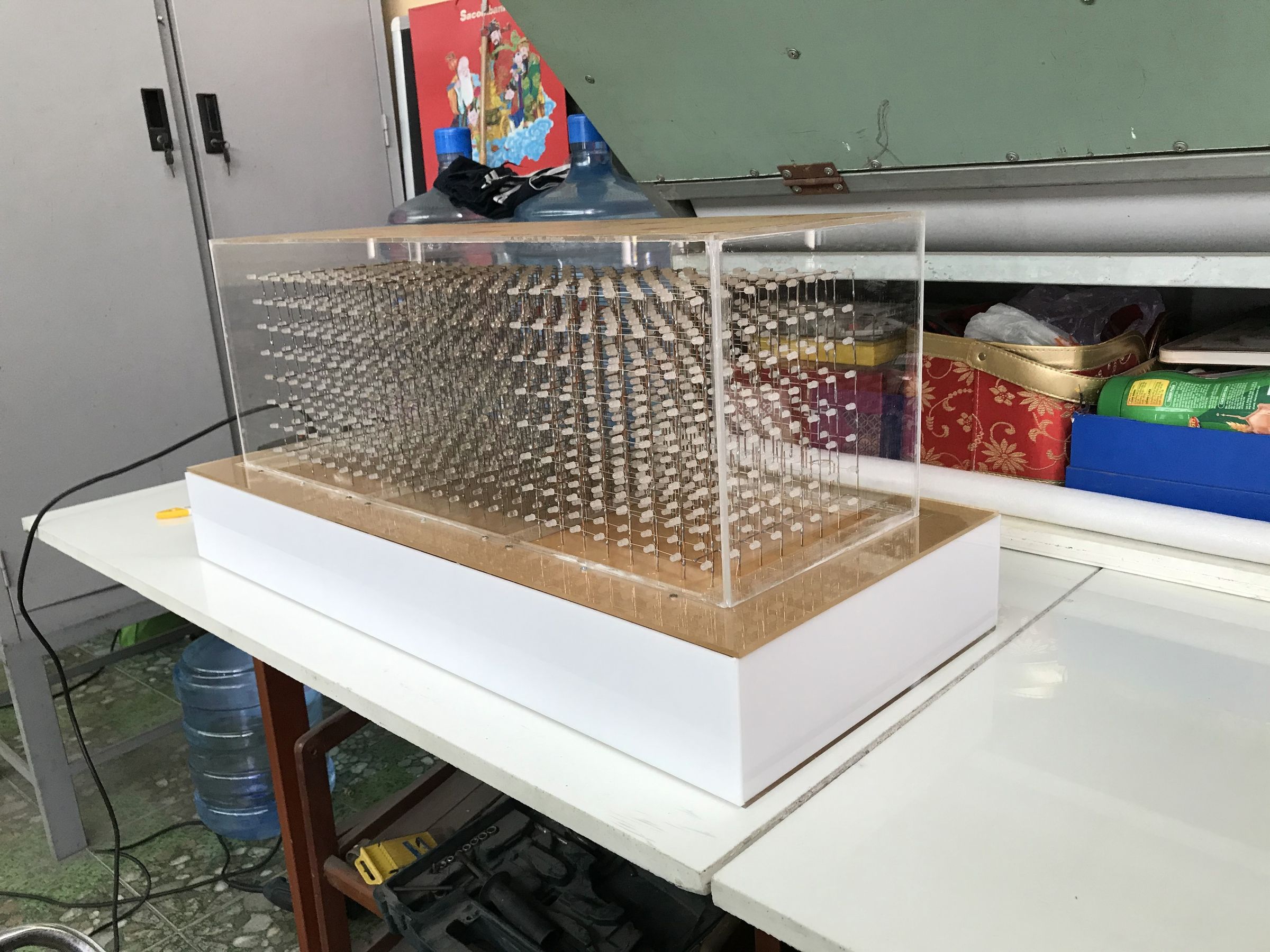

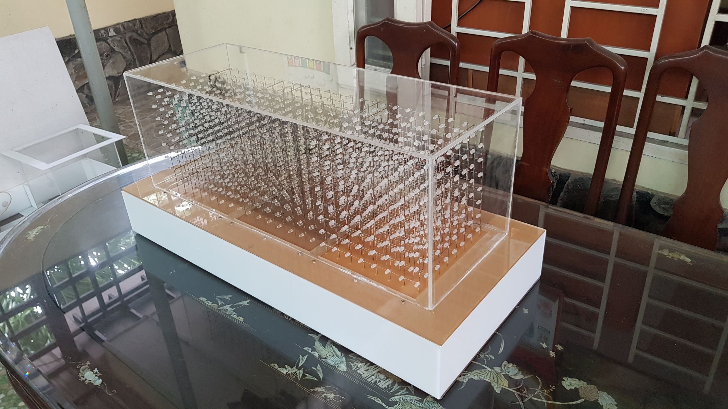

Step 6: BOX ASSEMBLY AND CONNECTION

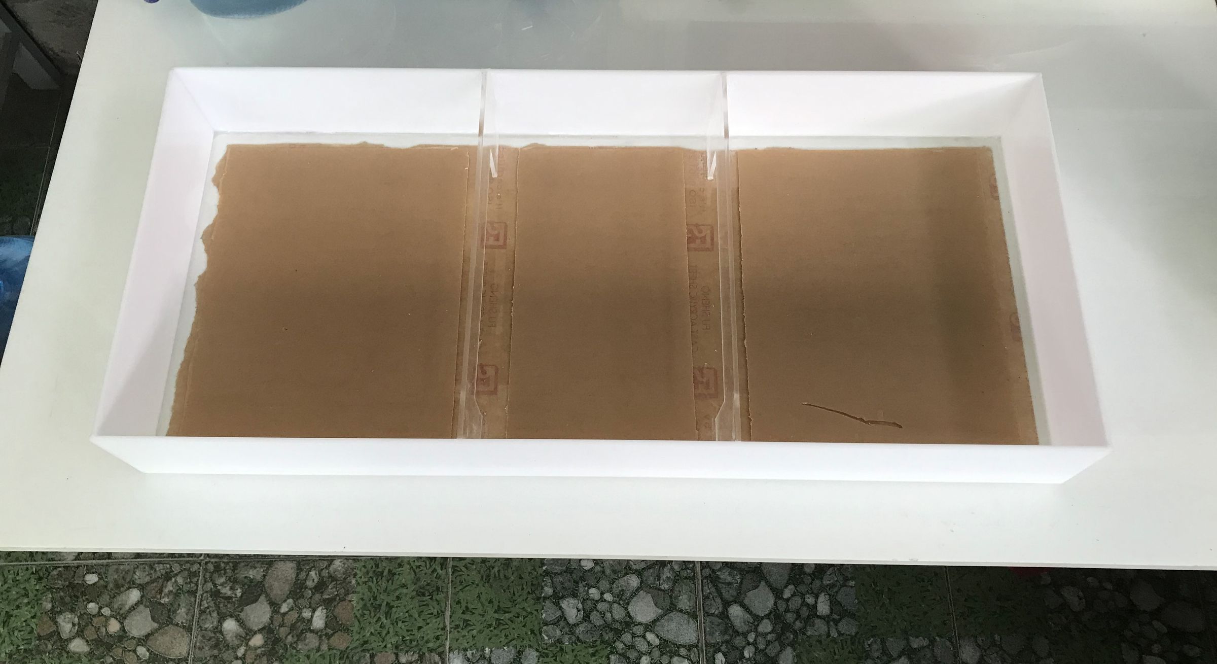

BOX ASSEMBLY:
- Bottom box: dimension LxWxH = 800x350x100mm, it contain: power supply, Arduino/ ESP8266, all PCBs, power switch and made by white acrylic.
- Top box: dimension LxWxH = 700x250x250mm, contain all 1536 leds and it is made by clear acrylic.
- Before placing 3 x led cube 8x8x8 inside the top box, I did alignment and adjustment to ensure the led cube in acceptable symmetric condition.
CONNECTION
- Preparing 5V power supply.
- Preparing anode scanning board.
- Preparing cathode scanning board
- Connecting all together
DONE!!! It's been a monumental effort and it looks so cool!!!

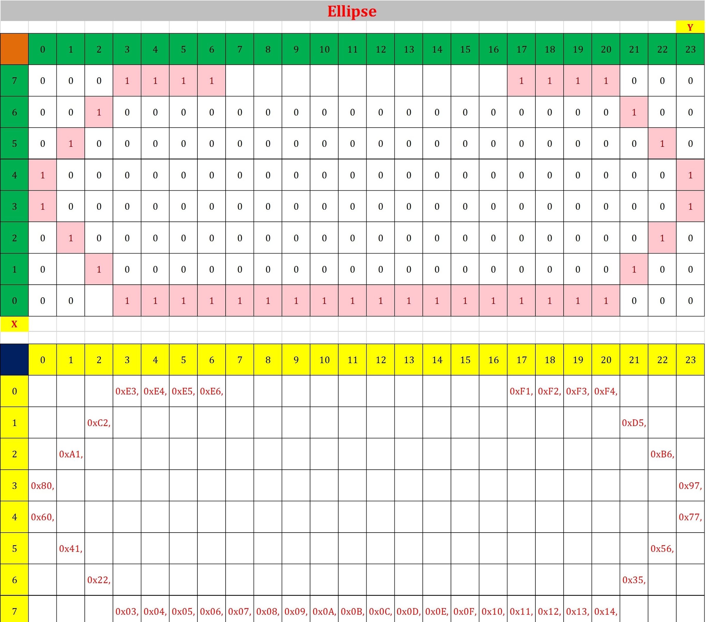

In my video, you can see the texts can move in ellipse shape around the cube. I did it based on one Excel template. With this template, we can easily edit to get programming code for any other shapes.
const unsigned char ellipse[38] PROGMEM = { 0xF1,0xF2,0xF3,0xF4,0xD5,0xB6,0x97,0x77,0x56,0x35,0x14,0x13,0x12,0x11,0x10,0x0F,0x0E,0x0D,0x0C, 0x0B,0x0A,0x09,0x08,0x07,0x06,0x05,0x04,0x03,0x22,0x41,0x60,0x80,0xA1,0xC2,0xE3,0xE4,0xE5,0xE6 };
For example: the first byte of above ellipse array 0xF1 (B11110001) stores led cube's coordinates(x0,y0) = (7,17) which x0 = B111 and y0 = B10001.
x0 = (ellipse[0]>>5) & 0x07); y0 = (ellipse[0] & 0x1f);
