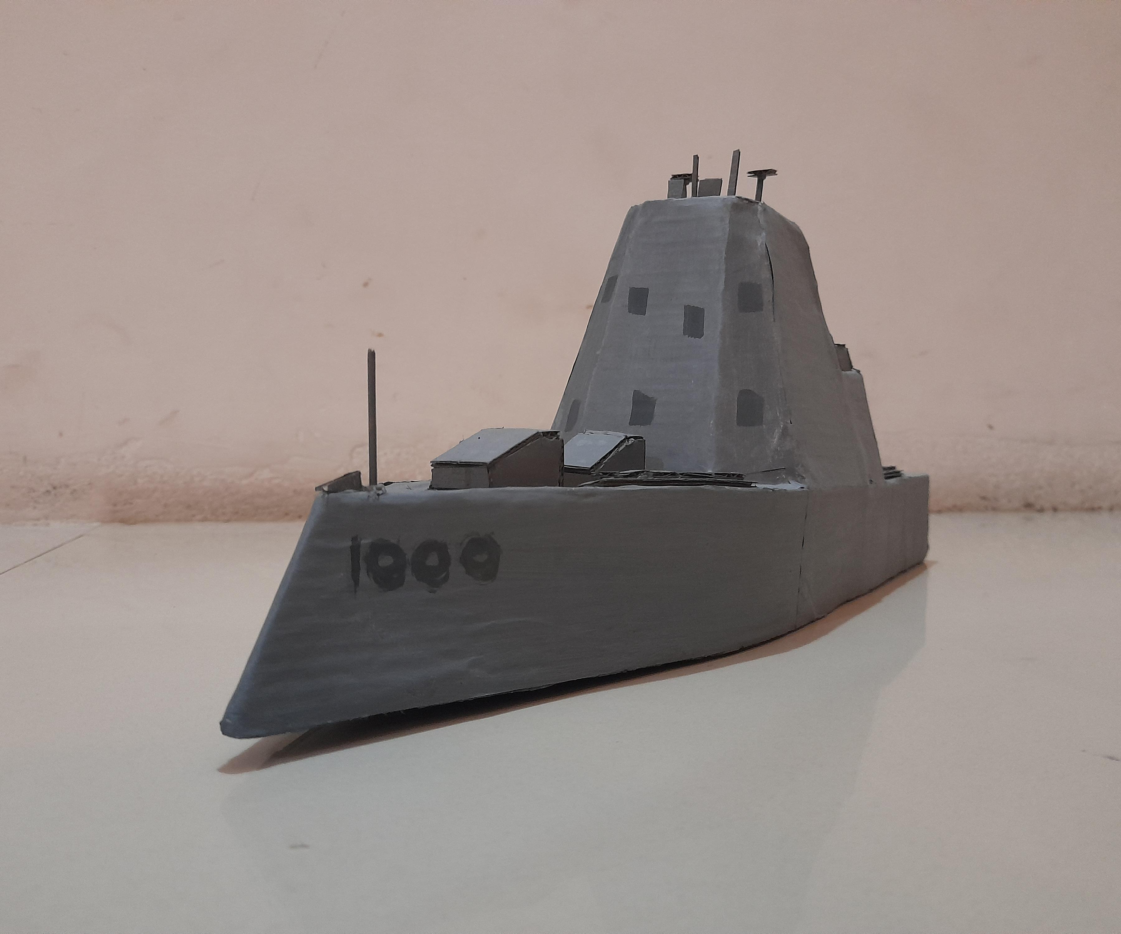

Introduction: Cardboard Model Battleship:HMS Prince of Wales
I was thinking of buying a plastic model and assembling it,but when i checked them their prices were too high.Then I thought of one making from Cardboard and materials that can be taken from home.So I made a one with Cardboard.
In this Instructables I am showing how to make a Model Battleship from Cardboard.The model is British battleship HMS Prince of Wales,a king George V class battleship which were one of the most powerful and modern battleships in World War 2.For more information about the ship refer the site - https://en.wikipedia.org/wiki/HMS_Prince_of_Wales_(53)

Step 1: Hull Construction:Dimensions
- Cut out two triangles,two rectangles and two arcs from Cardboard according to the given diagrams.(Refer the photos)
- Take Cardboard strips of breadth 4 cm.
Step 2: Hull Construction:Construction
- Arrange 1 triangle,1 rectangle and 1 arc according to the photo given.(First:Triangle,Second:Rectangle,Third:Arc)
- Then paste the Cardboard strips around the arranged structure.
- Then paste the other triangle in the triangular side(front).the other rectangle in the middle and the other arc at the end.
