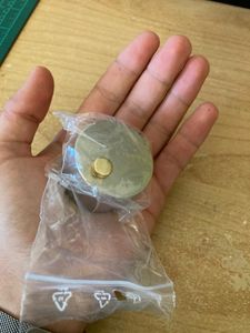

The magnet has the dimensions of 45 mm in diameter and 30 mm in height. It is rated at 70 kg force. It is essential for a strong bass.
