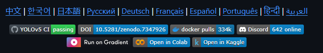

To get the yolov5 server, visit https://github.com/ultralytics/yolov5. Scroll down and search for something shown in picture 1. Then, click "Open in Colab", a yolov5 clone page will appear (picture 2).

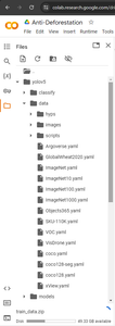

  3. Then, locate for the file coco128.yaml (yolov5 => data, shown in picture 3) and download it. Copy the code in the attached data.txt and paste it in coco128.yaml and rename (e.g. data.yaml). Then, upload data.yaml to the path where you download the yaml file.
