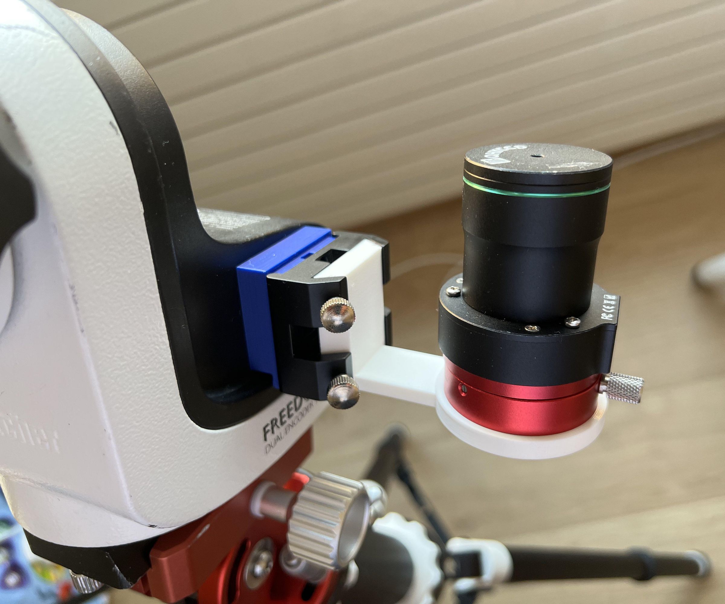

Interestingly, Sky Watcher also produces another very portable mount, the AZ GTI. It is 12V powered, can be used either with Wifi or the SynScan hand controller and is fully compatible with PHD2 guiding. While this mount is primarily designed to be used as an Alt Az mount, it also has the possibility to be used as an equatorial mount, hence the semi official name of AZ GTE: the firmware can be flashed to enable this possibility and there is an M12 socket to fix an M12 rod to counter balance the telescope in equatorial mode. However, a major limitation is that, as opposed to the SA, the AZGTI has no polar scope, seriously limiting the precision of your polar alignment. So I devised 3 ways to polar align this mount:
- a very rough polar alignment with an iPhone
- a precise polar alignment with a NEQ5 polar scope
- a very, very precise polar alignment with a pole master
Please be aware that the last two methods imply drilling holes in your AZGTI and will most likely void your warranty. I cannot and will not be held responsible for any damage you do to your mount.

- remove the plastic cover by unscrewing the 6 screws holding it. Also remove the battery back
- drill two 3 mm holes at the location shown on the picture, separated by 43 mm. The mount is made of aluminium, so drilling should be easy. For increased precision, you can drill first using a 2 mm drill bit
- carefully remove all the tiny aluminium bits that will have spread within the mount. Use a vacuum cleaner and double check that none are left otherwise you run the risk of shorting the circuit board
- put the 2 M3 screws in the holes, add the square nuts to the baseplate and screw everything tightly
- bonus: add some extra lithium grease to the gears
- screw back the plastic cover
- fix the dovetail to the base of the AZGTI head
- Fix the equatorial wedge to the AZGTI tripod
- Remove the m8 screw from the wedge and replace it with the m8 screw with hex head (the knob of the wedge is too large and will collide with the AZGTI head
Step 3: Preparing the Polar Scope / Polemaster
- slide the steel plates into the polar scope and pole master supports
- fix them with the M4 screws and nuts
- slide in the polar scope
- fix the polemaster to the star adventurer to polemaster adapter and screw it to the support
Step 4: Using
- First, position the AZGTI tripod and wedge facing south. Yes, I know, it is counter intuitive but due to the configuration of the AZGTI head you have to perform this 180° rotation
- Fix the iPhone Holder and do your basic wedge adjustment using the daytime mode of the Polar Scope Align Pro App
- Remove the iPhone Holder. Install the AZGTI head, screw it tightly
- Screw in the M12 rod, install the counterweight(s). Don't forget the M12 "toe saving" nut !
- Install your telescope and balance it
- Install the polarscope on the AZGTI head and tighten it using the butterfly screws. Polar align
- Remove it, install the pole master and perform your very fine polar alignment
