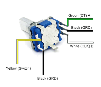

Let’s start with the Rotary Encoder, initially cut each wire to four-inch lengths, they will be cut shorter as required in later steps. So cut (5) 4-inch 22 AWG gauge wires. If possible, use 2 blacks, 1 white, 1 green and 1 yellow as this will make it easier to connect later. Also, pre-solder the ends of each wire to make the next steps easier.
After soldering your wires, we strongly suggest using some protective shrink tubing to avoid any of the wires from shorting as they are in very close proximity of each other.
Refer to second image above and solder the green wire to the DT (A) pin, two black wires to both grounds, the white wire to the CLK (B) pin, and finally the yellow wire to the switch pin.

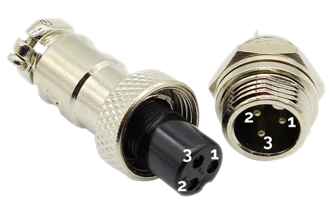

We’ll now wire the two males ends of our GX12 and GX16 connectors. Cut (3) 4-inch 22 AWG wires, 1 red, 1 black and 1 yellow. Here we have soldered our red wire to pin 1, our black wire to pin 2 and finally our yellow wire to pin 3. Make sure to note the pins you use, as this will be important later when we wire our female connector to the temperature sensor. Also make sure to add some protective shrink tubing on each of the wires.

In the section, we’ll guide you through the process of installing the female GX12 connector to the DS18B20 waterproof temperature sensor. We will also install the required 4.7 K Ohms resistor inside the connector. First cut the 3 wires to a length of ½ inch from the wire sleeve. Then remove 1/8 inch of insulator from each wire. Also cut a 1-inch protective shrink tube which is just large enough to fit over the sleeve. Enter the female connector cover and the shrink tube in the same order as shown in the first image.
We will be integrating a 4.7 K Ohms resistor inside our connector. We’ll need to cut ¼ inch on one side and ½ inch on the other side of the resistor as shown in the second image. As we’ll be soldering small wires on a very small connector, it will be important to pre-solder both the connector as well as the wires and the resistor as shown in the third image, as this will make the next steps much easier to accomplish. Locate pin 1 of your connector and first solder the short end of the resistor as shown in the fourth image.
Next, bend the top of the resistor so that its other end is in contact with pin 3 and solder it in place as shown in the fifth image. We will now solder the three wires to the connector. With the connector cover and shrink tube installed over the wire, first solder the red wire to pin 1 along the already soldered resistor. Next, solder the negative black (or blue) wire to pin 2 and finally the yellow data wire to pin 3 along with the already soldered resistor. Refer to the sixth image for an example of what your soldered connector will look like. Next, slip the shrink tube all the way over the resistor and soldered wire and apply heat to shrink tube so that its nice and tight over the wire and the connector’s exposed solder as shown in image 7. Finally, carefully screw the connector to the cover making sure that the wire turns loosely inside and then tighten both screws at the neck of the connector as shown in the last image.
