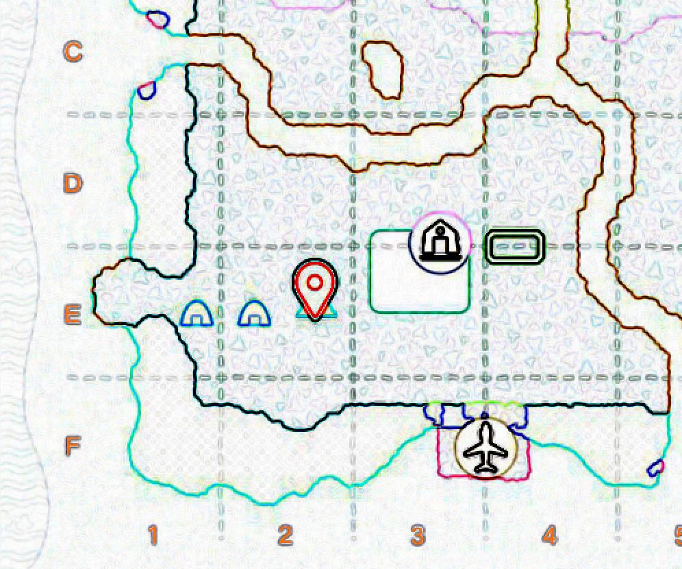

When you open the file this is what it should look like.
  • In your software the layers tab needs to be open. All groups should be collapsed.
  • On the left side a basic map should be shown. This is my guess at what a simplified terrain will be.
Note: the rocks to the north are already in place but I have included a basic rock asset in Rocks => North Rocks.
  • Each group of layers holds multiple assets to organize them.
  • At the top of the layers is Grid. This is a grid for the entire map. Turn Big and Small grid on or off as needed.
  • At the Bottom of the layers is Map Minimum, Map Original and Background.
  • Map Minimum is the map currently shown.
  • Map Original is the map that I based this project off. Turn it on to get an idea of what your map can look like.
  • Background is locked so it can't be moved.
