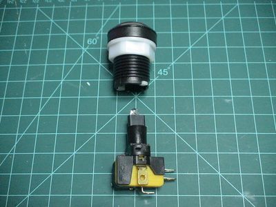

Step 2: Disassemble the Button
Images below tell it all:

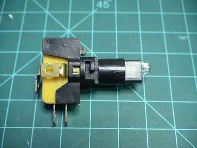

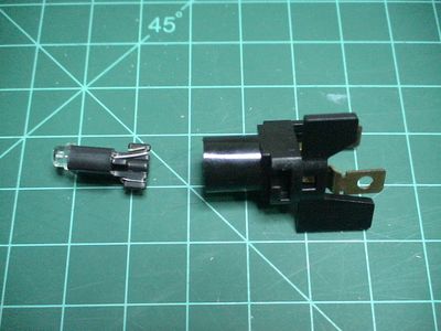

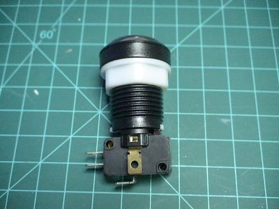

- The switch and LED come out together by twisting the switch and the button.
- The LED is just wedged in there, with a resistor for 12v

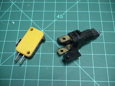

- The microswitch can be pried out, careful not to break the pegs holding it in place.
- Grab the 2 metal tabs with a pliers and tug them out.

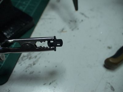

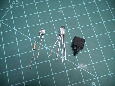

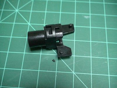

First the LED socket has to be prepared, the one that the original LED was in.
- Un wrap the leads and remove the LED from the black plastic socket.
- The socket has 2 holes in the bottom, but we will need 4.
- With a small drill bit( 1/16") drill out 2 more holes like in the image below.

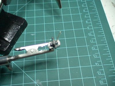

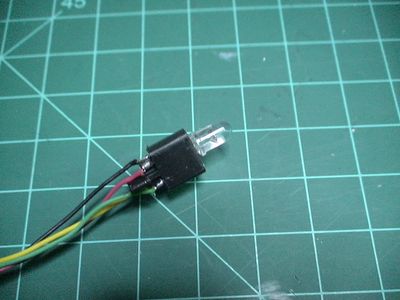

- Now prepare the RGB LED by trimming it and spacing out the leads.
- Place the LED into the socket so one lead will go out each hole, do it carefully so you don't bend a lead into its neighbor.

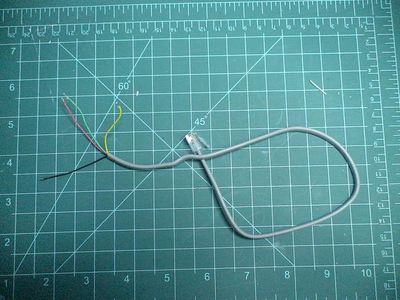

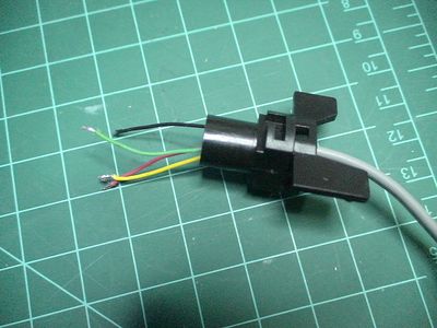

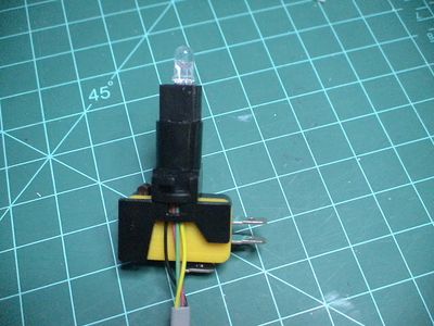

- Get out the phone cable or ribbon cable and open up the jacket to expose the wires underneath, just need a few inches.
- Strip the ends of the wire.
- Place the socket in something that can hold it, like a 3rd hand helper

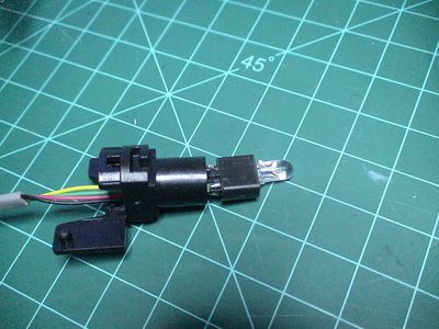

- Solder it up, if your cable has different color wires like mine it helps a lot. I coordinated the wire color to the LED color except the yellow wire goes to blue, and black to common cathode/andoe. But do whatever works.

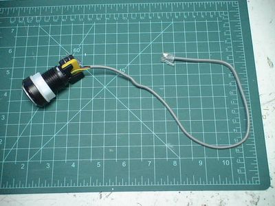

- Slide the LED socket back into place, it should fit just fine.
- Push all the wires to one side, on my buttons I had more space for the wires on one side of the switch than the other.
- Align the holes in the microswitch with the posts on the button and snap the switch back in.

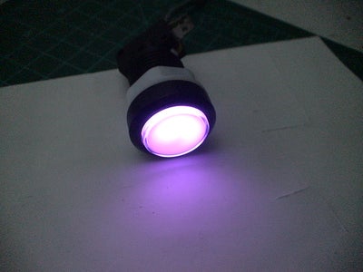

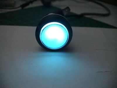

Its now ready to use, but don't forget to put the proper value resistors in series with the LEDs to limit current, there was not enough space inside the switch so they have to be outside somewhere.
It can be hooked up to any RGB Controller such as my Dial RGB Driver, 24 Channel LED Controller or 48 Channel Mono / 16 Channel RGB LED Controller, USB Connected
