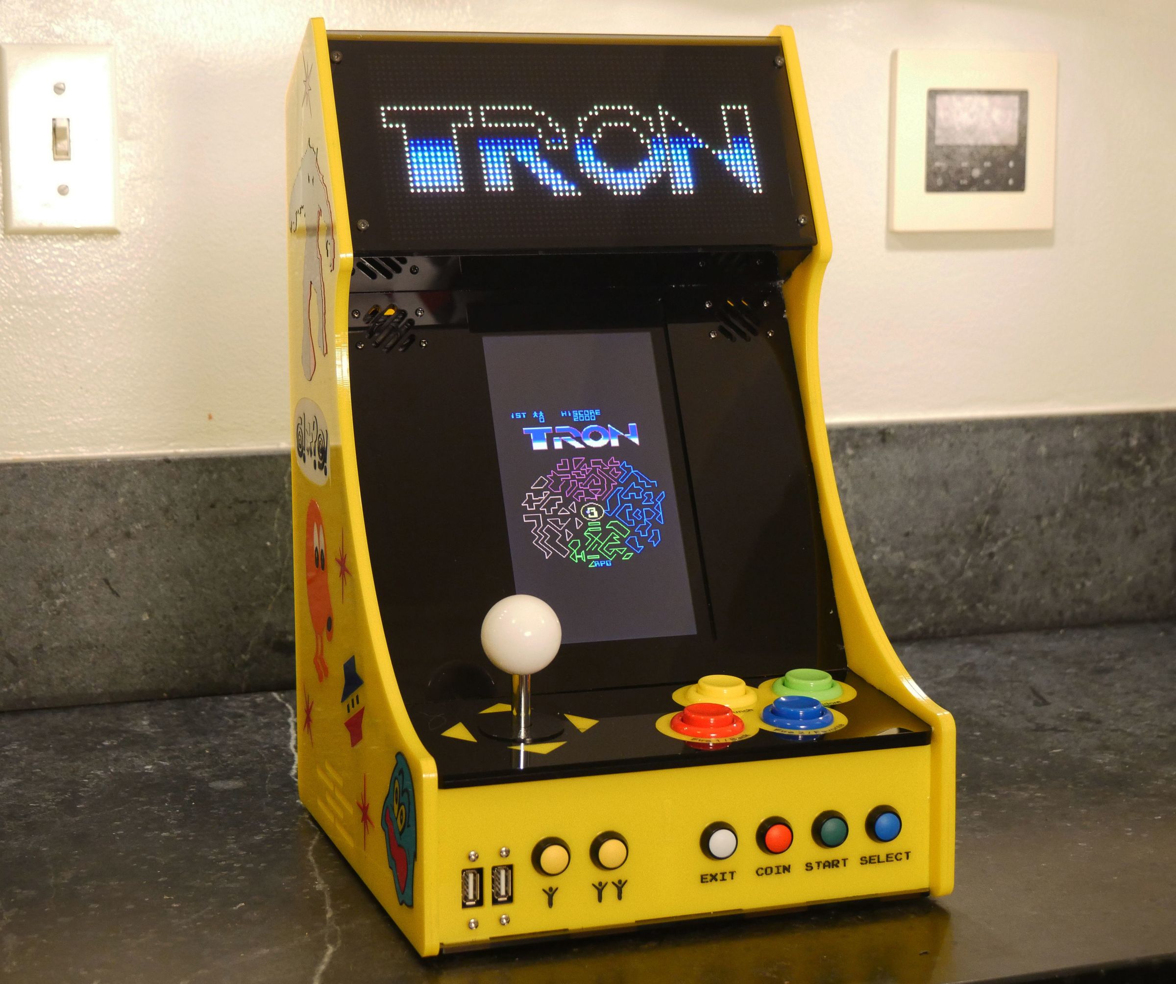

Step 1: Laser Cut and Assemble the LED Marquee
1. Laser cut these files. Make one cut using the solid black acrylic 1/8" thick and the other cut on the smoke/translucent 1/8" thick piece of acrylic. Modify the laser files if you are using a different cabinet or refer to these generic laser cut mounts for Pixelcade
2. Feed the two tie wraps through the holes and attach screws and nuts to the solid black mount
3. On other side of the solid black mount, line up the two 64x32 LED panels and then attach them with the included M3 screws
4. Add plastic nylon screws and nuts (included with the Pixelcade kit) to the outside holes of the PIXEL mounting board
5. Add plastic nylon screws and nuts to the outside holes of the Raspberry Pi mounting board (skip if not using a Pii)
6. Mount the PIXEL board and Pi board mounts to the solid black mount and secure with nylon nuts. Important: Be sure that you've attached the LED panels before this step, otherwise you won't be able to reach some of the LED panel mounting holes.
7. Mount the PIXEL board and secure with nylon nuts
8. Mount the Pi and secure with nylon nuts (skip if not using a Pi)
9. Connect the LED panel power cable to each panel and the 5V DC jack to the PIXEL board
10. Attach the IDC ribbon cable from the PIXEL board to the first LED panel on the left. Connect the output of the first LED panel to the input of the second LED panel using an IDC ribbon cable. Use the tie wraps to tidy up the cables.
11. Glue the 3/4" acrylic piece to the bottom of the smoke/translucent acrylic front piece. Acrylic cement with an applicator works great but use E6000 or another adhesive if you don't have.
12. Attach the solid black mount (back) to the smoke/translucent front piece using the hex stands and screws.
13. Connect the 5V, 10A power supply and ensure the LED marquee is displaying a correct image.
Step 2: Mount LED Marquee in Arcade Cabinet
1. On the Game Room Solutions arcade cabinet, remove the screws on the bottom of the marquee and remove the existing marquee
2. Slide in the LED marquee and secure using the bottom marquee screws on the cabinet.
