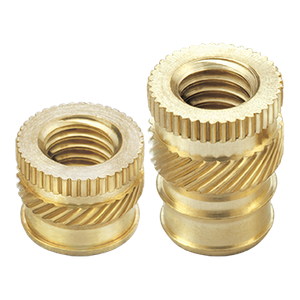

The option I ended up going with was instead 3D printing the enclosure, which I was able to print in one go using the dovetail feature in prusaslicer. I then slotted the components together along the lines. To ensure the screws could screw into the enclosure, I used heat inserts, which can be pressed into the print using a soldering iron to put solid threads that machine screws are then able to screw into without worry about damaging or wearing on the plastic.

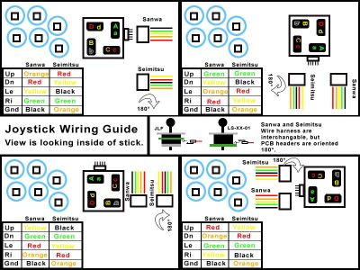

Wiring the joystick required a bit of testing as I wasn't sure exactly what wires lined up to what directional input but the diagram above helped, as well as the joystick test code linked in the component step. Functionally, the joystick is four push buttons all pointed at each other in a square, and their wiring is similar, connected to a port and ground.
