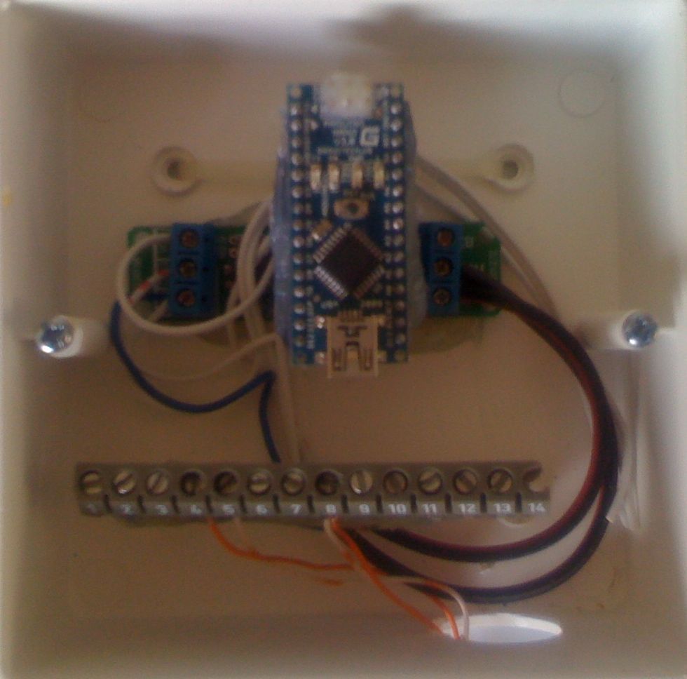

This project can be attached to a door phone so that when the doorbell button is pressed the door opens automatically.
    Very useful for doctors offices with many patients like hematology lab. This hardware is for the building's main entrance (you can leave your office door open...:)  )
    While doorbell button is pressed you can pick an AC voltage in the speaker of the door phone. You can measure this trigger voltage using  a DC voltage sensor.
    Why a voltage sensor? Cause you isolate your arduino from voltages that could go as high as 12Vdc or 24Vdc. My voltage sensor also divides input voltage by ratio 5 to 1, so max input voltage is 25V.
    In my case I have a trigger of 6.5VAC. This trigger voltage goes to a AC to DC diode bridge converter and then through the DC voltage sensor to the analog input A0.If analog input A0 returns a reads more than 4 Volts then  digital I/0 pin 12 becomes high and triggers the 5V relay which is connected to button of door phone that opens the door.

Circuit:
Battery:  Connect to Vin and GND of arduino(careful do not connect battery when you also have usb connected)
AC to DC diode bridge: AC pins goes to door phone's speaker pins, DC pins to DC voltage sensor.
Voltage sensor: Input + VCC goes to + pin of diode bridge, input GROUND goes to - pin of diode bridge, output S to pin A0  , output +Vcc to 5V pin, output ground to GND pin of arduino.
Channel relay: Trigger to Digital I/O Pin 12, +Vcc to 5V pin, Ground to GRN pin of arduino.

The final project in a box:
Well try not to use a metal box because you will need much glue to isolate the circuits.
